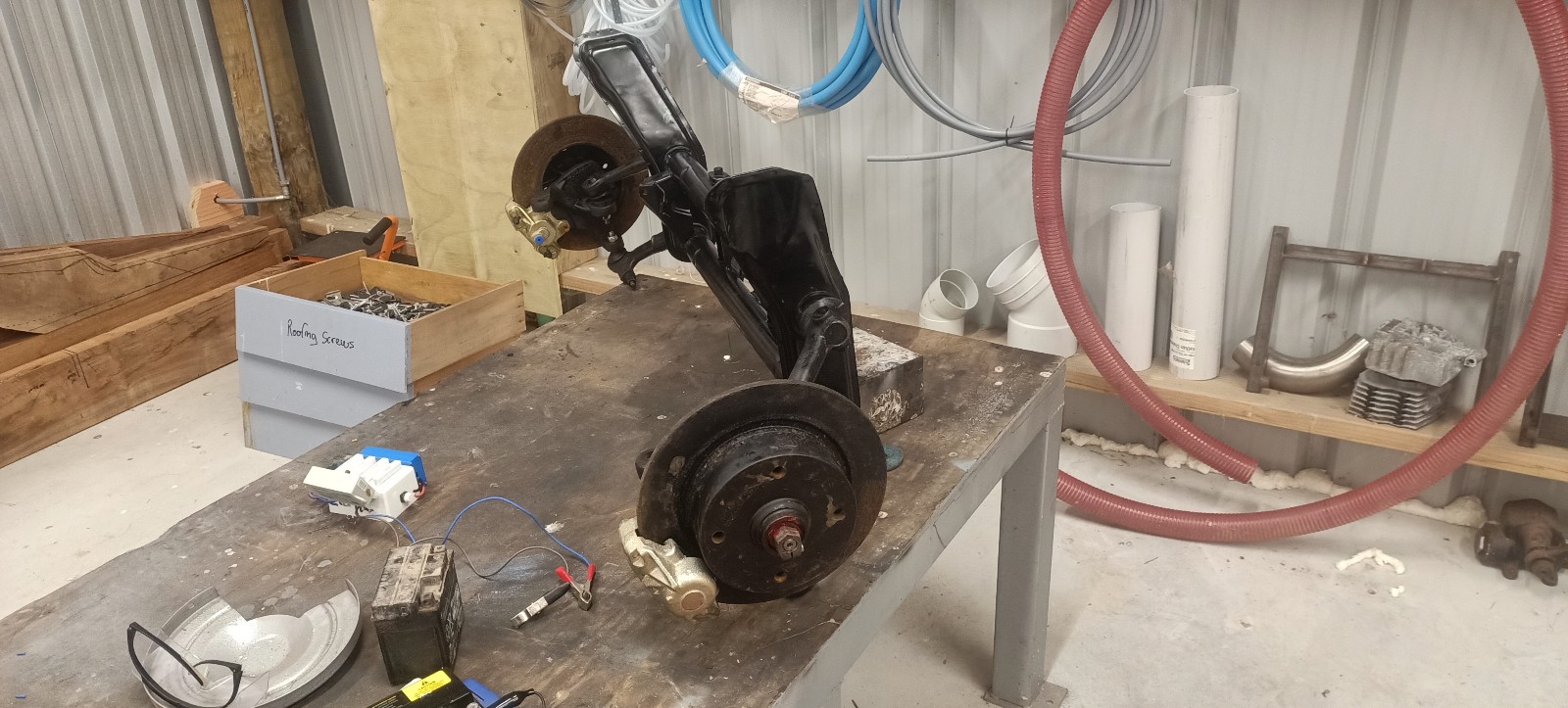

flyingbrick Posted January 17, 2019 Author Posted January 17, 2019 I stripped down the front end, gave it a good clean and gave the arms to the vdub shoppe so that they could tackle the ball joints using a press rather than a hammer. Next- there's a pair of front beam adjusters to weld in there. Oh and here are some great looking bugs for inspiration. 8 Quote

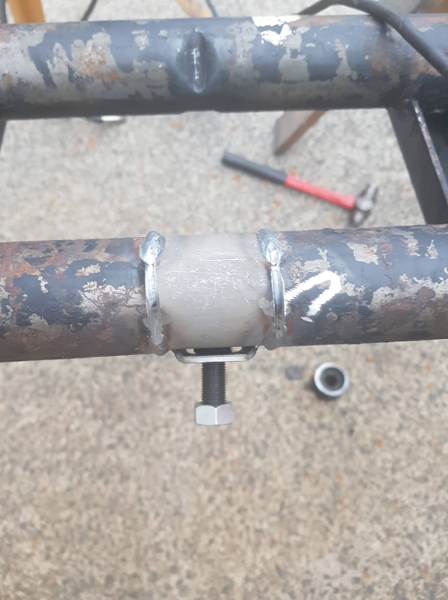

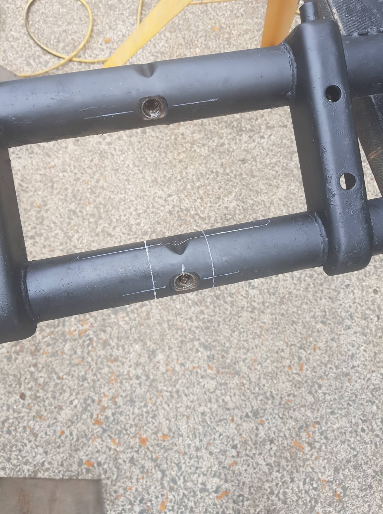

Popular Post flyingbrick Posted February 8, 2019 Author Popular Post Posted February 8, 2019 My wife and i did some bonding over the beetle and got probably 1/3rd of it sanded down and smooth. Few issues with the existing body filler being applied to a completely unprepared surfaces but nothing major. A few more hours and we will be ready for primer And this week I skived off work so that I could hang out with @64valiant, work on his bug and do some on mine. I managed to get my beam adjusters welded in. First there was marking. then there was careful cutting (and some brace welding.. this photo is a bit out of sequence) Tacking and V grinding and welding...and more V grinding and then in the time it takes to make 2x floor mats it was done. 10 Quote
