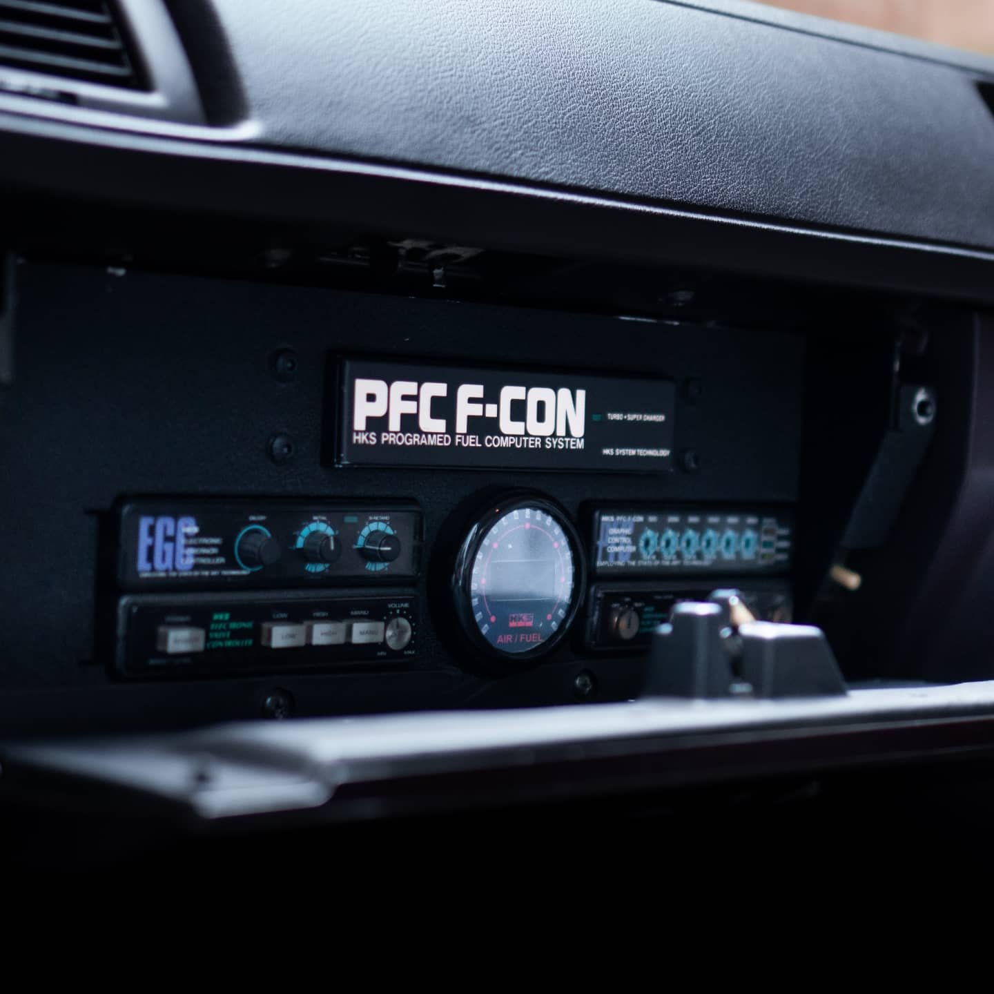

Popular Post Jeffs_Emporium Posted October 8, 2021 Author Popular Post Posted October 8, 2021 My favourite part is the integrated bracket held by the air fuel ratio gauge I can't wait to light up this Christmas tree 11 1 Quote

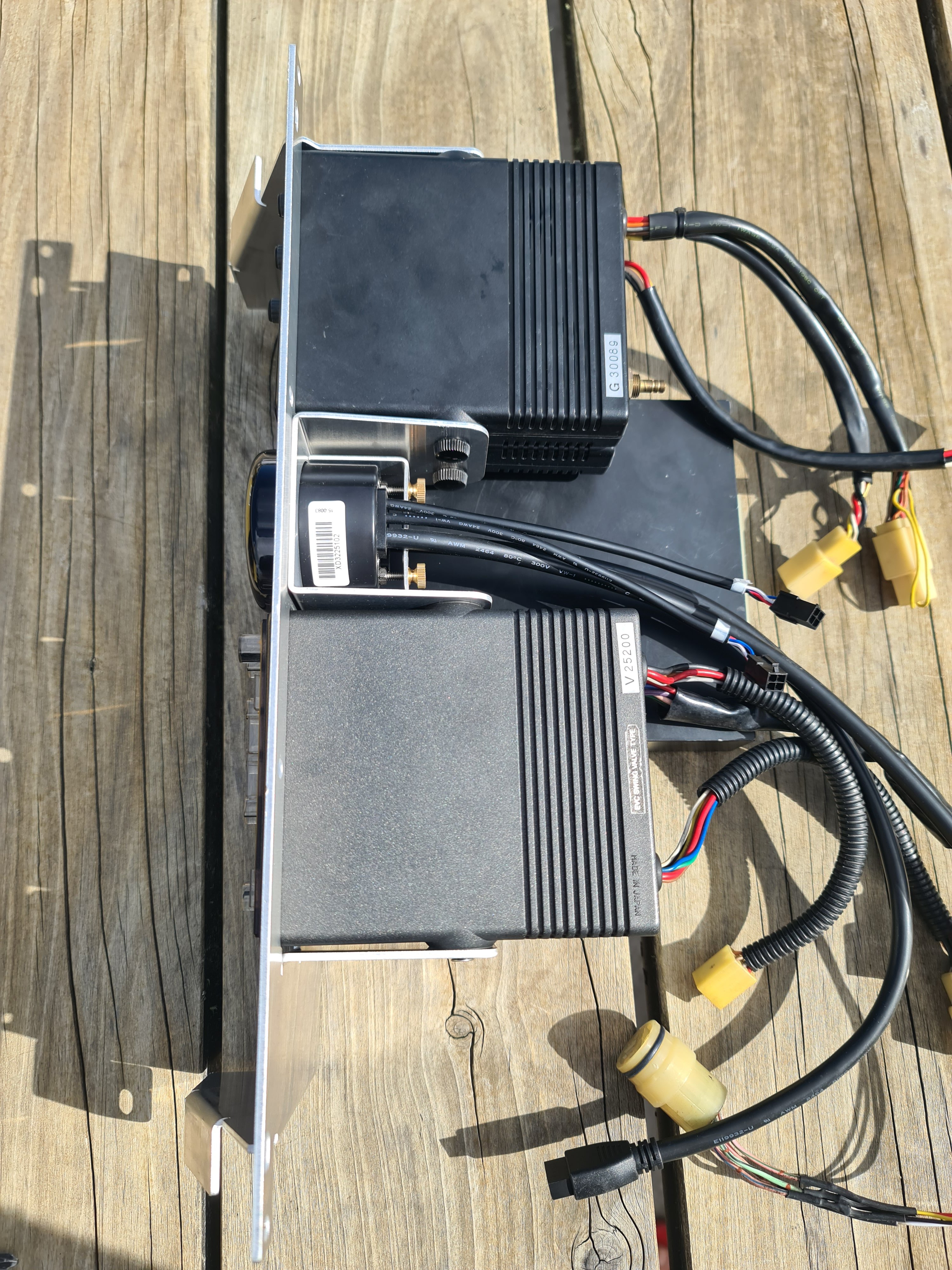

Popular Post Jeffs_Emporium Posted October 10, 2021 Author Popular Post Posted October 10, 2021 Injectors are back in with new o-rings from MSEL and primed up without leaking. Sprayed the glovebox panel with vht wrinkle this afternoon. I need to find some space for all the wiring, each of the plug ins have like 1m excess loom attached.... @Barnz.NZ put me onto a single 14" ssr tomcat listed on Yahoo Auctions Japan which I managed to win this morning. Will be using it with the other I have to make a pair for the mark II with hopes of finding two more eventually 24 3 Quote
