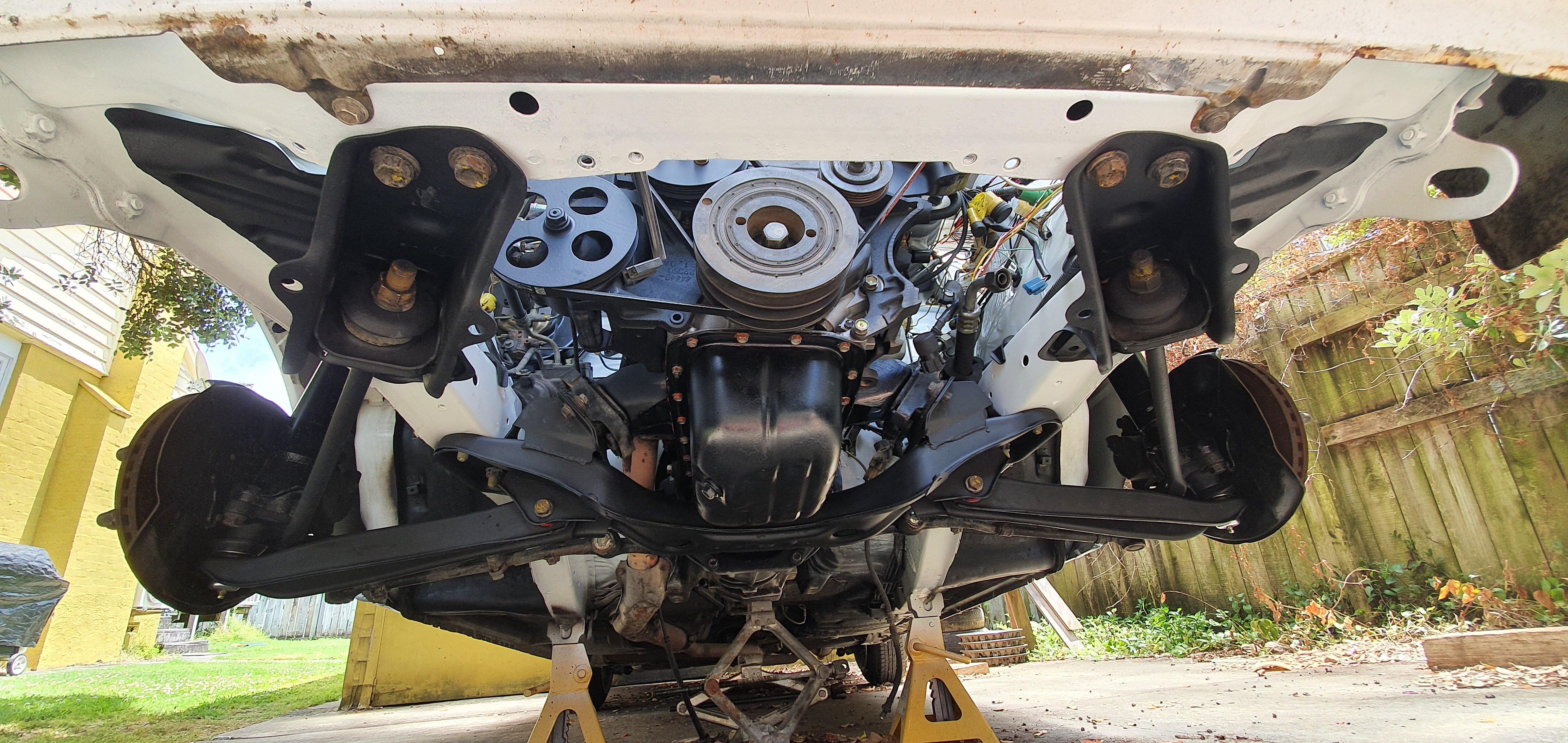

Popular Post Jeffs_Emporium Posted January 6, 2020 Author Popular Post Posted January 6, 2020 Put lower control arms back in with new ball joints and bushes and attached knuckles and castor arms 11 Quote

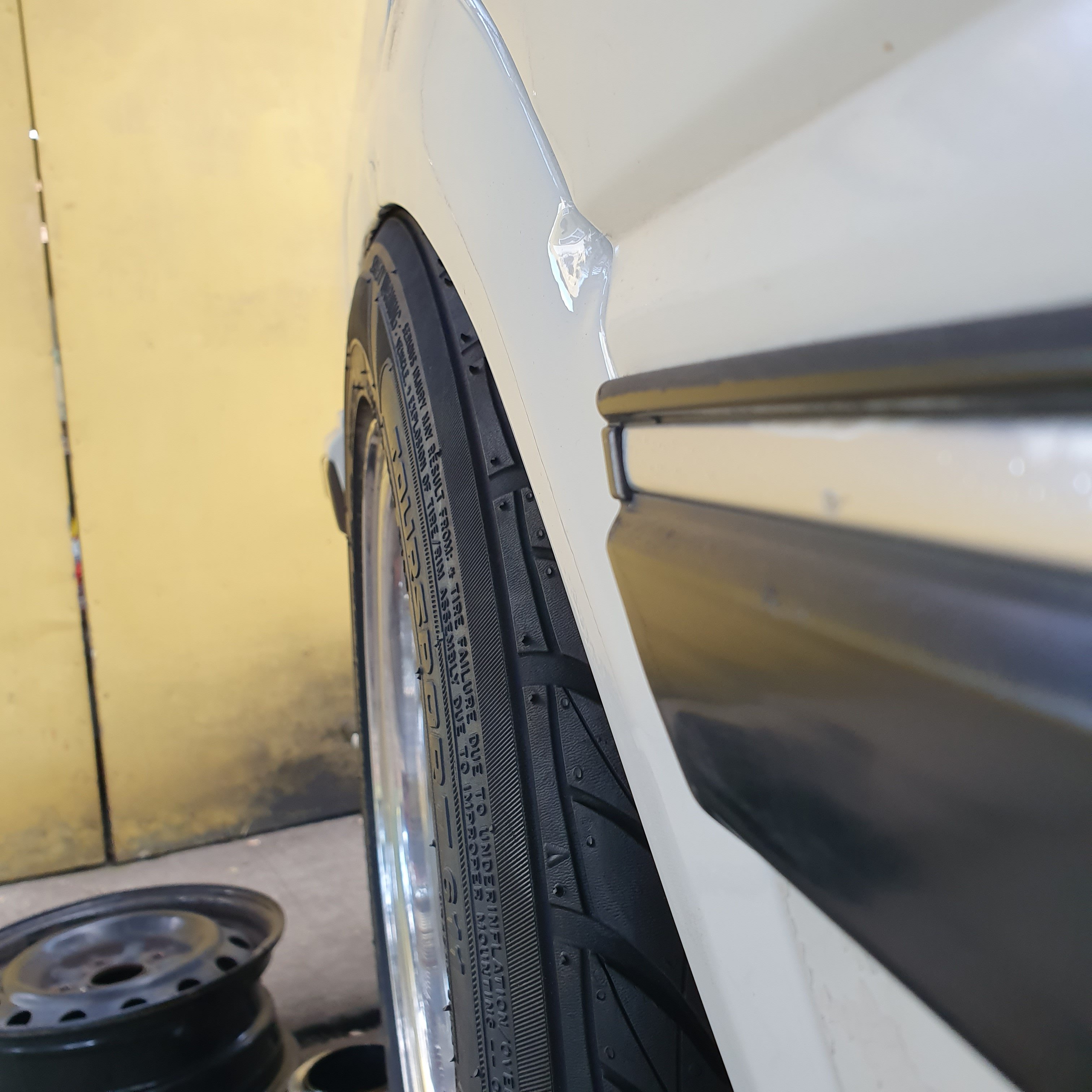

Jeffs_Emporium Posted January 17, 2020 Author Posted January 17, 2020 Not having a good time. Probably should have sorted the subframe before shopping for tyres. May reluctantly end up running 7 inch rear and 7.5 inch front to get through cert. 4 Quote
Jeffs_Emporium Posted January 18, 2020 Author Posted January 18, 2020 Beat the inner guard lip with a hammer and trimmed the chrome edge to suit around where I folded the lip. Planning on a full re-spray post certification so things like this can be painted and undersealed then 5 Quote

Popular Post Jeffs_Emporium Posted January 26, 2020 Author Popular Post Posted January 26, 2020 Driveline all back together with fluids, fender mirrors reassembled and installed, put the front sway bar back in and inner guards. Then tried to bleed brakes and realised what the tubes were for that came with new master cylinder which I threw out yesterday, called it a day. 11 Quote
