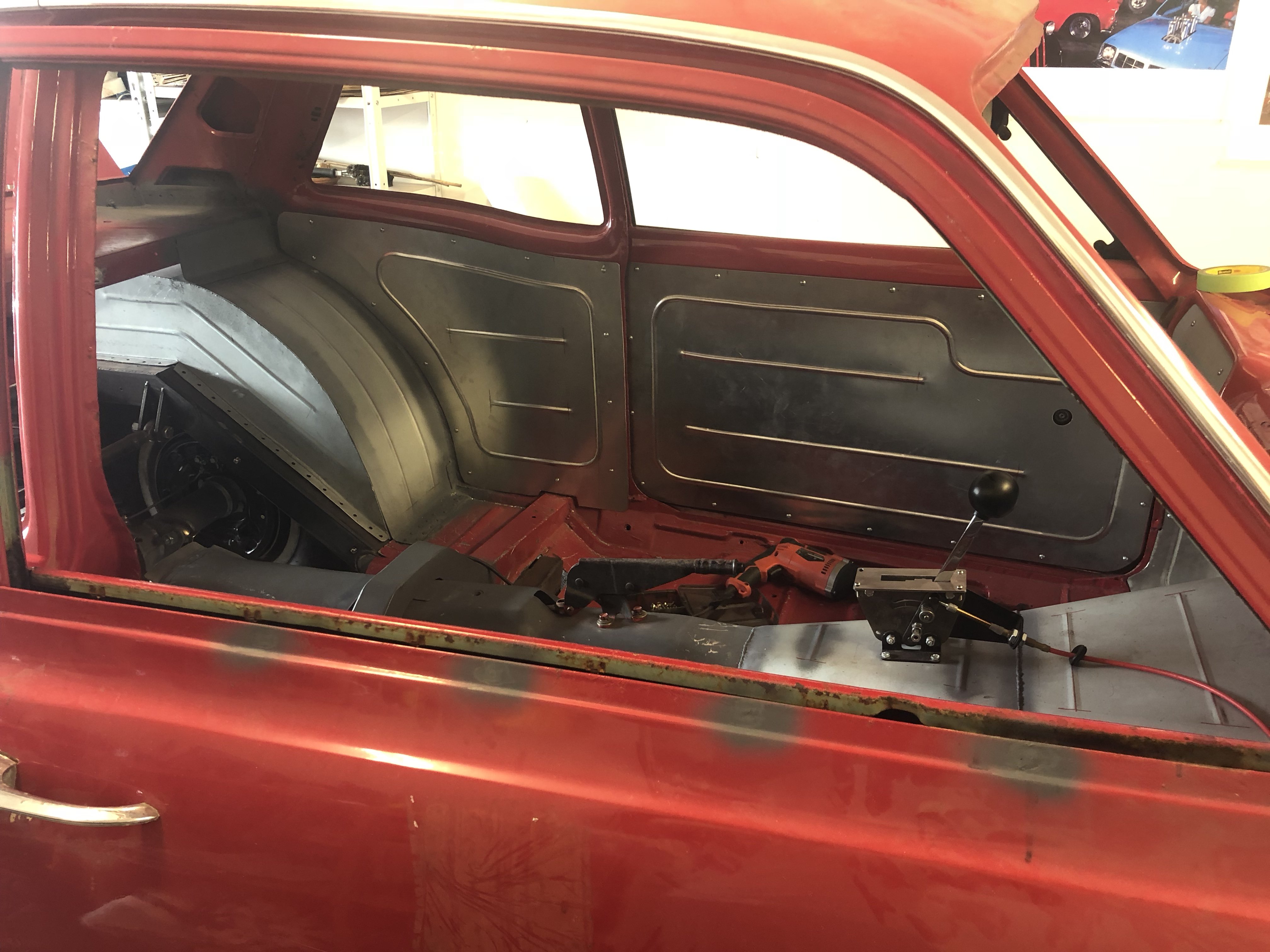

nels Posted February 29, 2020 Author Posted February 29, 2020 Door and rear quarter panels are all done..that’s the interior finished..and yes it’s very spartan. perfect eighties vibe..noisey and hot..no dynamat for me. 5 Quote
