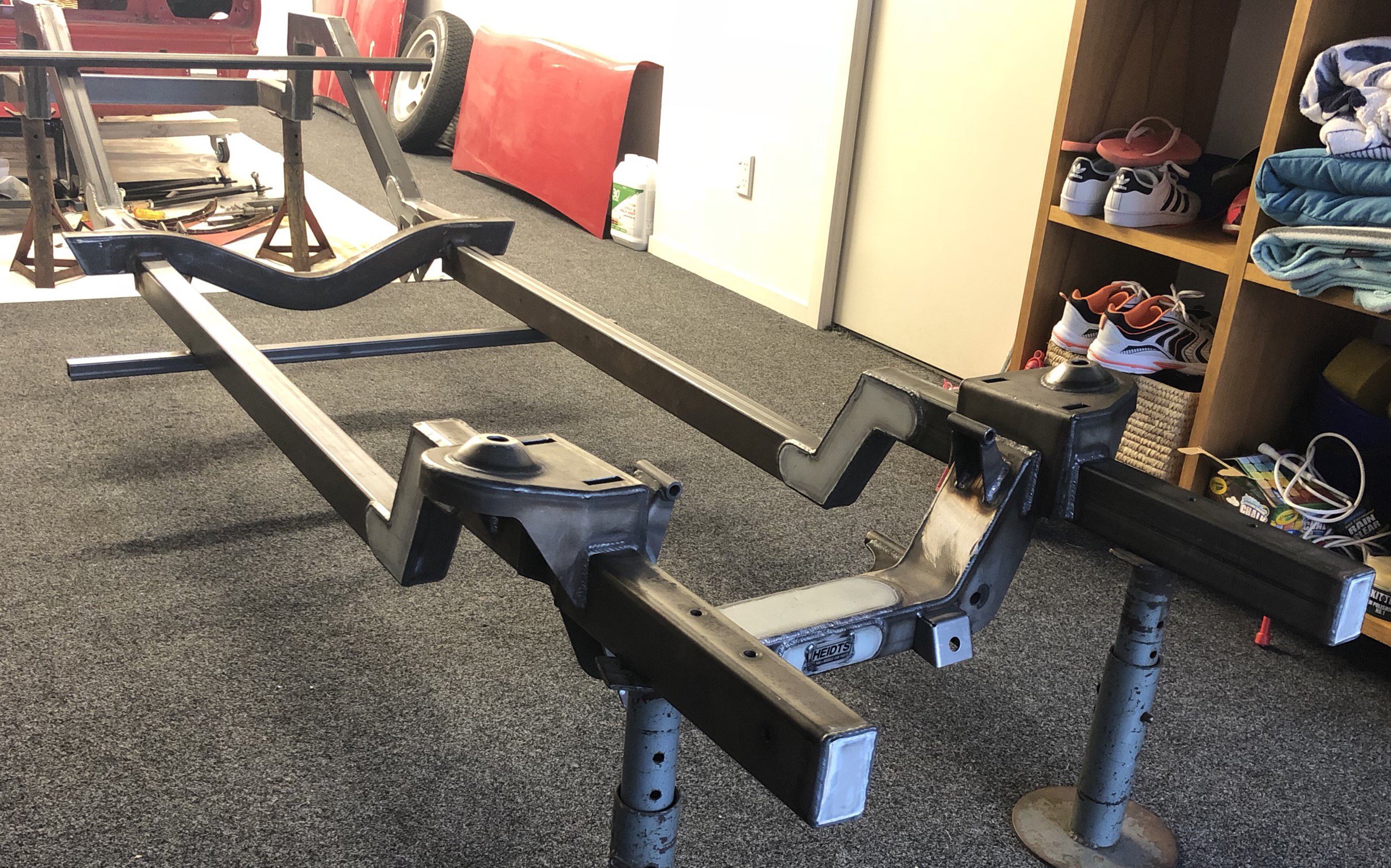

nels Posted October 1, 2018 Author Posted October 1, 2018 Chassis back from being tig welded and fish plated. just need to get the rear end back and locked in place, then can work out exactly we’re we want the shock mount crossmember to be welded in. after that it’s time to drop the motor and trans in place. 7 Quote
