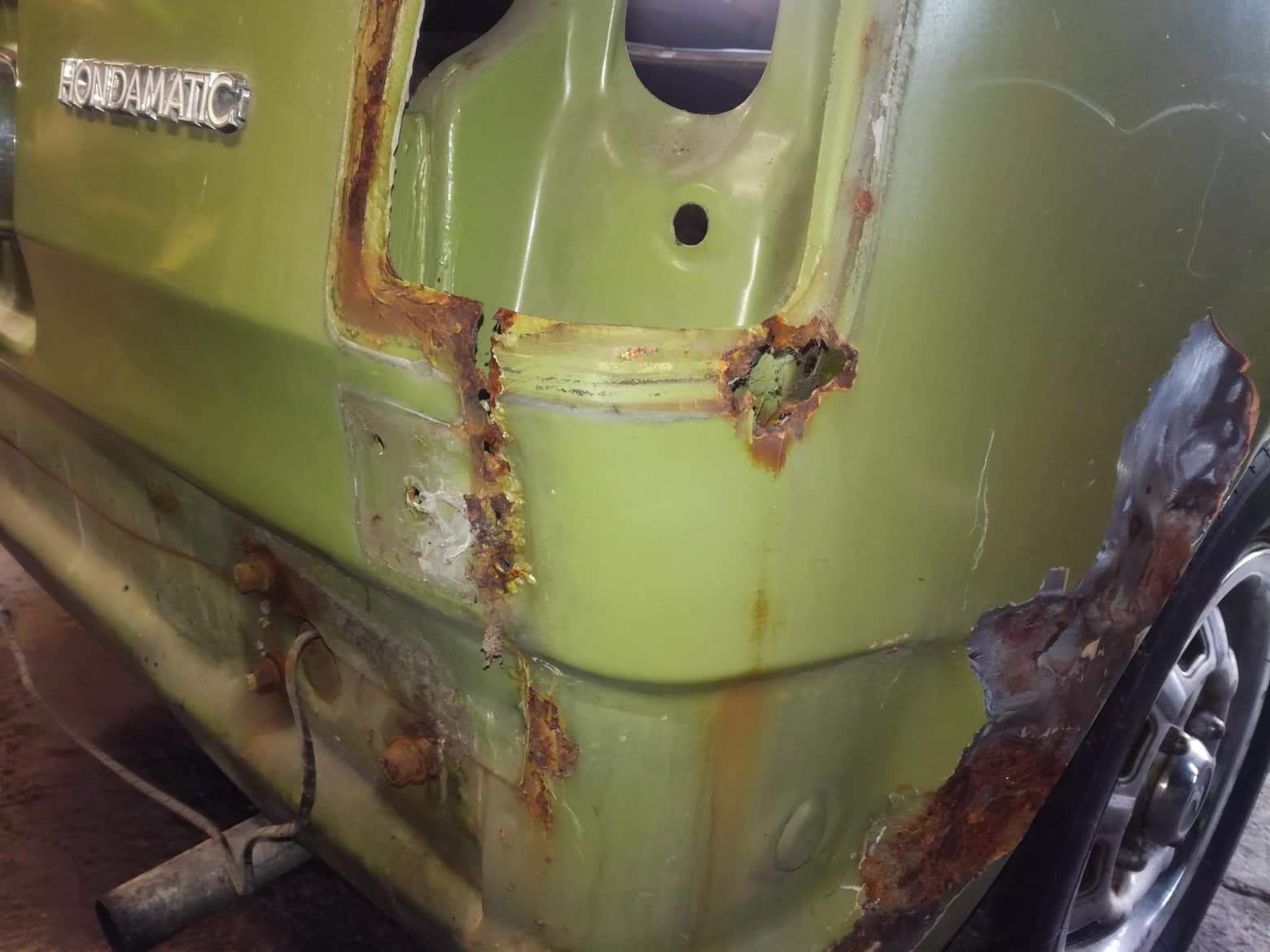

JustHarry Posted June 26, 2018 Posted June 26, 2018 In last couple days I've dissasembled both front calipers only to find pistions like new and good seals. Quick clean and back together they went This arvo with @- i5oogt - bleed the brakes in the hope they would sort them selves out. Only to find one rear drum dragging real bad. Took apart to find the slave cylinder was siezed on one side. The wall of the cylinder is in pretty good condition being aluminium. May get new ones if available. Also went digging into the back right corner to see how far the rust went........ Wheel arch has had a prang and been filled up. Will pull this mess out Couple little bits of rust to fix 1 1 Quote

Popular Post JustHarry Posted July 2, 2018 Popular Post Posted July 2, 2018 Productivity has been high on this due to deadline for hanmer..... So tonight I dug into the rust. Was worse than initially thought. No problem though. Was a bit tricky not having a guillotine/folder/nibble/compressor that keeps up with air tools/gasplant for welding the panel repair. But despite all this it got don no photos of during process due to such high productivity. But before and after. Will prob just rattle some green on for the mean time and epoxy, fill, and paint properly later on down the track / never 21 Quote
