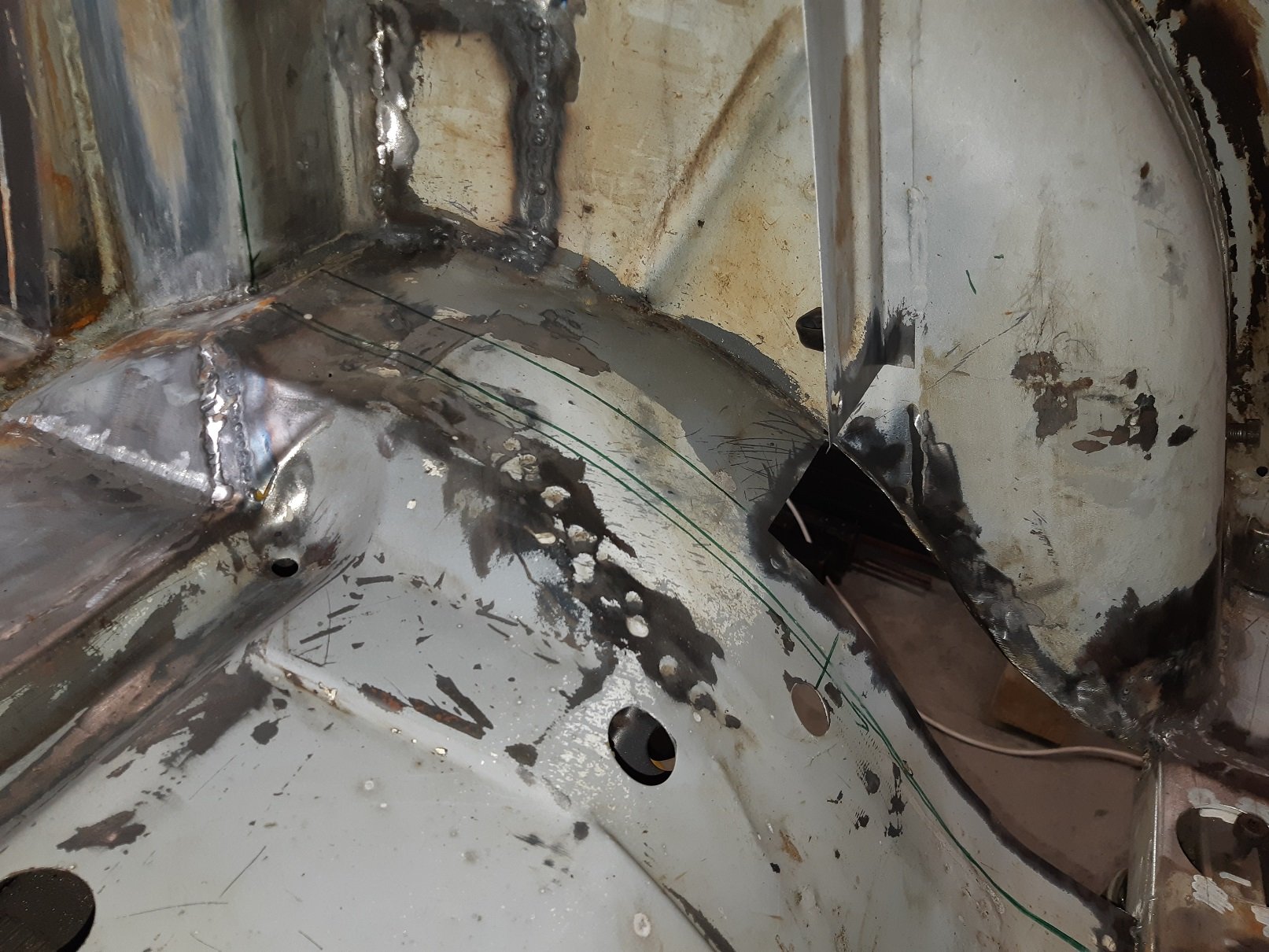

Popular Post Adoom Posted January 23, 2022 Author Popular Post Posted January 23, 2022 I discovered that my original plan to create internal chassis rails to support the front subframe mounts was going to intrude far too much into the seat base. New plan is to make another cross member that ties in with the sills and leading edge of the wheel well. There will be a hump in it for the driveshaft. Oh yeh. I got a driveshaft made. 16 Quote
