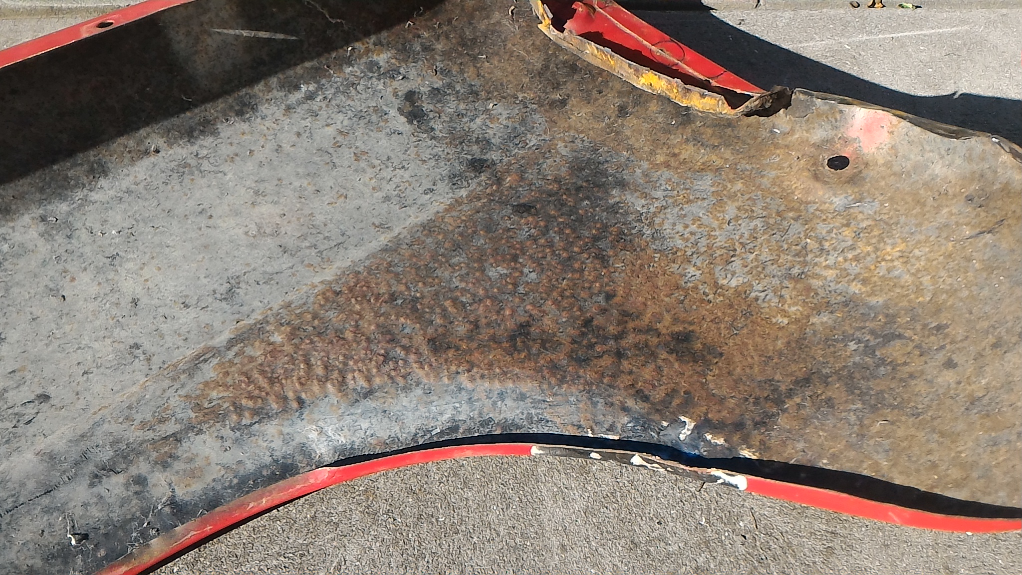

...The guards. Right. So I started by stripping the paint off of the passenger side guard to find this...P_20170419_141236.thumb.jpg.59df02e514def5bf79723ac9adb9cf45.jpgP_20170419_141243.thumb.jpg.629e758d2e03bce2fd9670a325098904.jpgP_20170419_152255.thumb.jpg.ace542324b145d574e17de16c0d20def.jpg
It's not easy to see but someone has beat the shit out of it with a ball peen hammer and then bogged over it to bring it back to straight. I really shouldn't be surprised at this point. Even so, this sort of work was a bit much for me to handle at that point and it was a bit discouraging but I bravely soldiered on and got stuck intoP_20170422_114207.thumb.jpg.2b39e8cca0f2ae51ff5a38e72fcae241.jpg
the passengers side door. Obviously :tongue:
