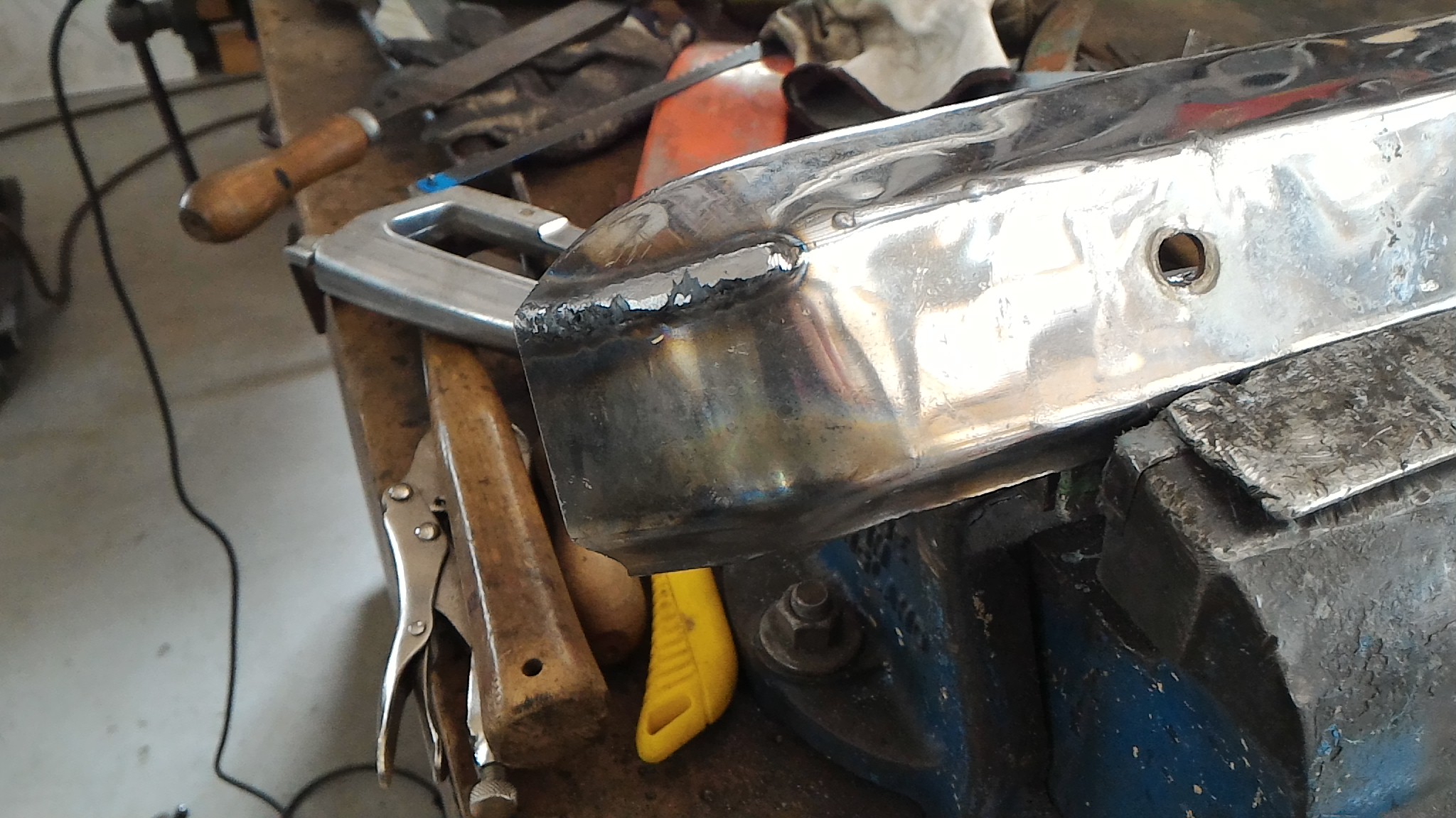

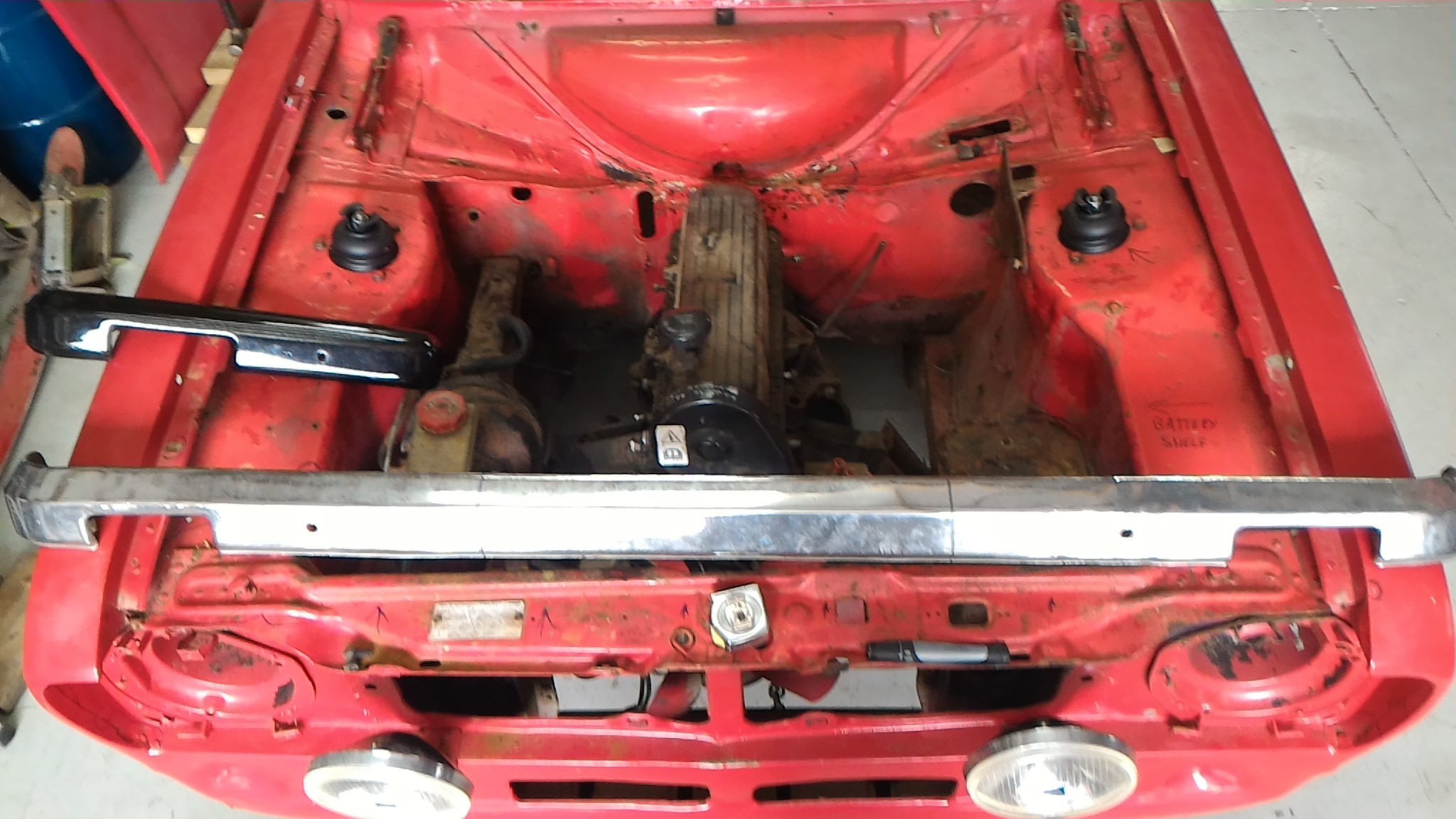

Hurmeez Posted June 27, 2017 Author Posted June 27, 2017 First job we got on to was making some sport style quarter bumpers. The car came with a bent and twisted front bumper which would never come back to perfectly straight without heaps of work and I prefer the quarter bumpers on the mk2 so it was the logical conclusion to chop it up. This first photo shows it after we had it in the press to get as much of the twists and kinks out of it as possible before starting. It doesn't look so bad here but it was much worse in person. Then I borrowed a fiberglass bumper off a mate and used that to mark up the steel and make a wooden buck. Sliced the steel bumper Bent it round the buck (note the steel toe socks and crocs) And TIGed it up. 1 Quote
Popular Post Hurmeez Posted June 27, 2017 Author Popular Post Posted June 27, 2017 Ground back the welds and gave it a little bit of a polish with a skotch-brite on an orbital sander. You can see a pressing mark jut to the right of the fixing bolt from the straightening in this picture but I prefer black bumpers so it's nothing a skim of bog and paint won't fix. Finished them both up and offered it up to the car. I threw the spotties on there because they were lying around and I wanted to see how they looked. I'm not so keen on them so they'll be getting the old spanish archer for the final look. 12 Quote

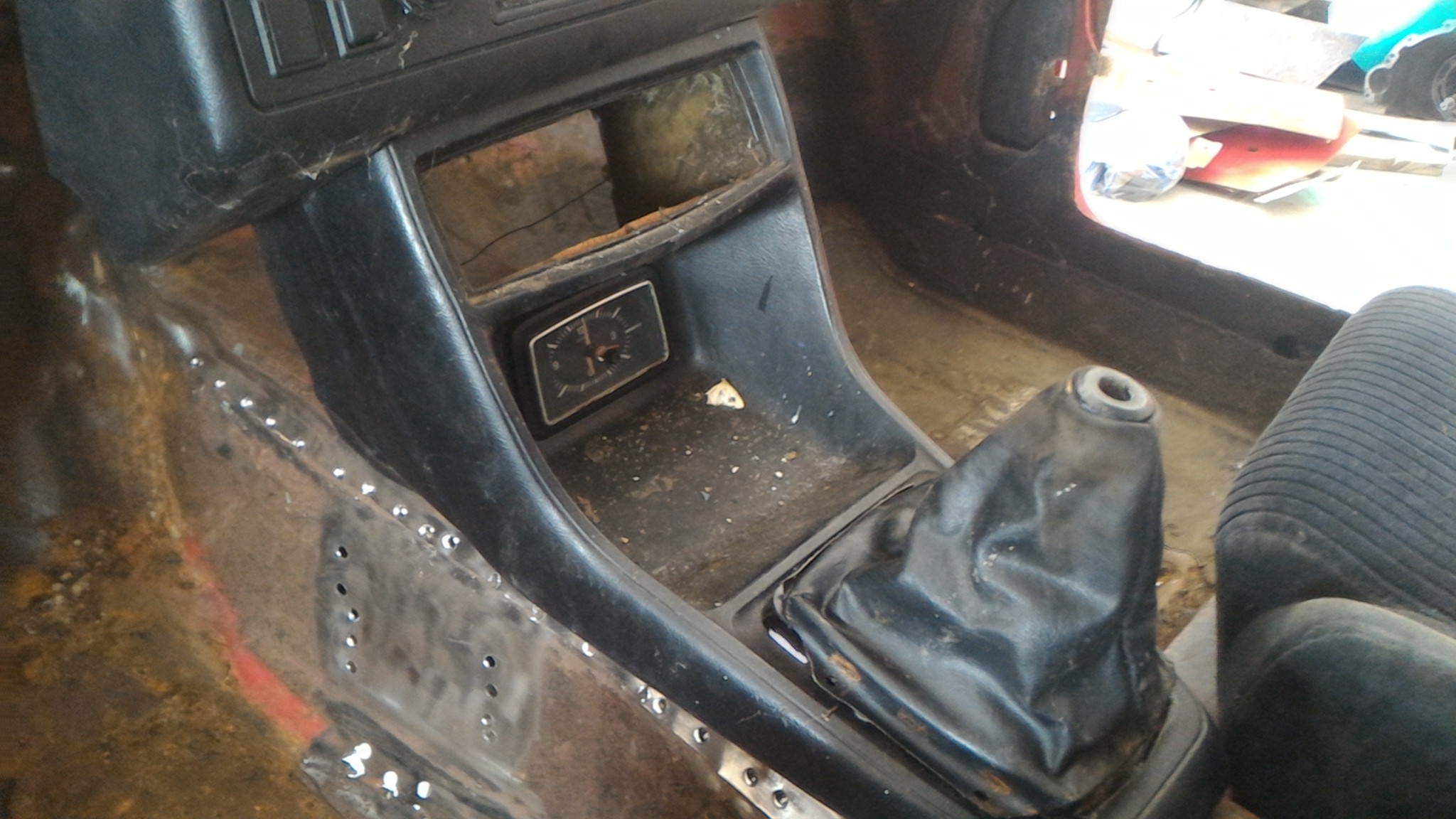

Hurmeez Posted June 27, 2017 Author Posted June 27, 2017 The joys of having a dad with car obsessed mates... A couple of things happened in the same day on this day. Firstly a mate of dad's had a couple of seats he was planning to put in a T-bucket he was building up. However, in his opinion the small amount of wear on some of the upholstery meant they were useless and he didn't want them anymore. Not exactly sound logic in my opinion but there you are... his loss, my gain.Another thing I can add to the free component list. As you can see they're not the prettiest seats in the world but at the end of the day they're free and I think I have a plan to sort out the ugliness. I did a quick bit of research and apparently they're out of a 1990ish honda prelude so at the end of the day I can make mounts to fit these and if I want to I can fit bucket seats designed to fit a prelude if I want. Despite their looks, they are very comfortable with lumbar, tilt, and lateral support adjustment along with the bonus that they have the passenger operated tilt lever so the guys in the back seat can get out easy. The second win for the day was a big parts haul from another of dad's many mates. There's a guy around whangarei that drives a 1100 mk1 estate as his daily and he's stashed away two mk2 estates as parts cars. After a quick chat he very generously offered any interior parts we wanted since he only wanted mechanical spares off of them. So from that I managed to score 1x back seat with full clown car spec upholstery, 1x homemade purri gear knob, 1x center console, 1x gear stick boot Oh and shitloads of other stuff like full seat belts, door panels, heater box, kick panels, glovebox, dash trim, steering column and wheel, and more. We made sure to bag and tag everything so we know exactly where everything came from. So definitely a couple of wins that day. 3 Quote

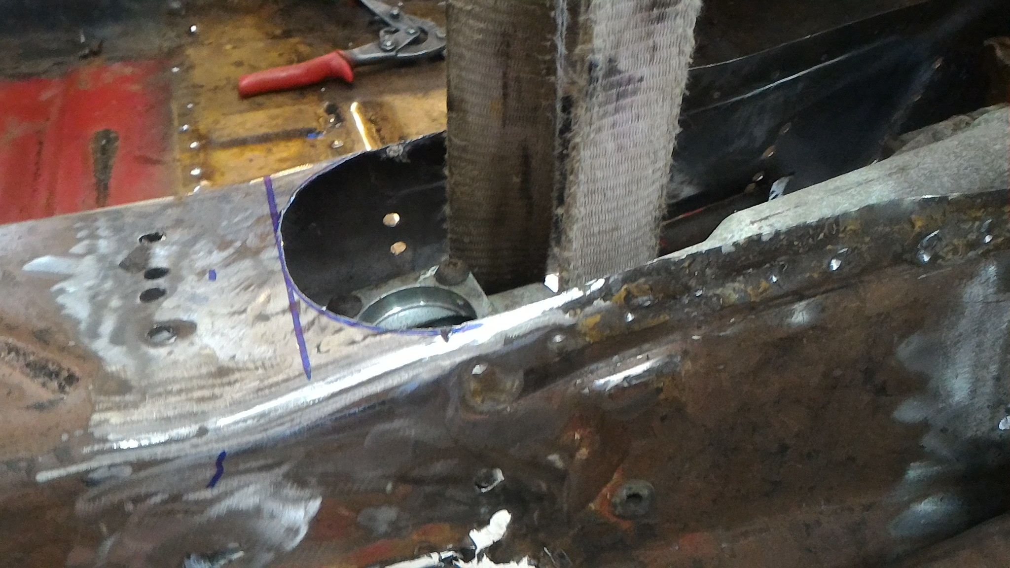

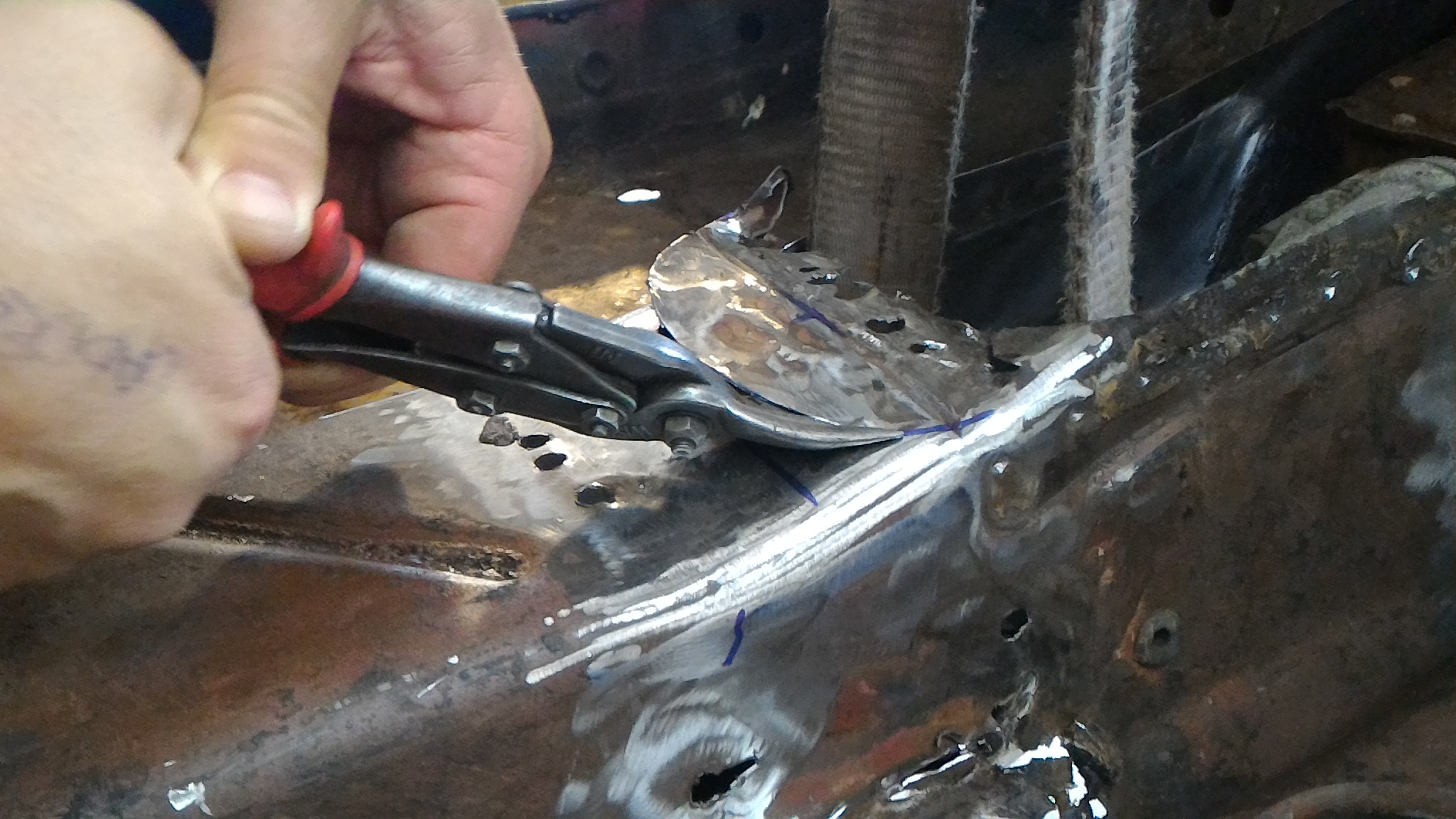

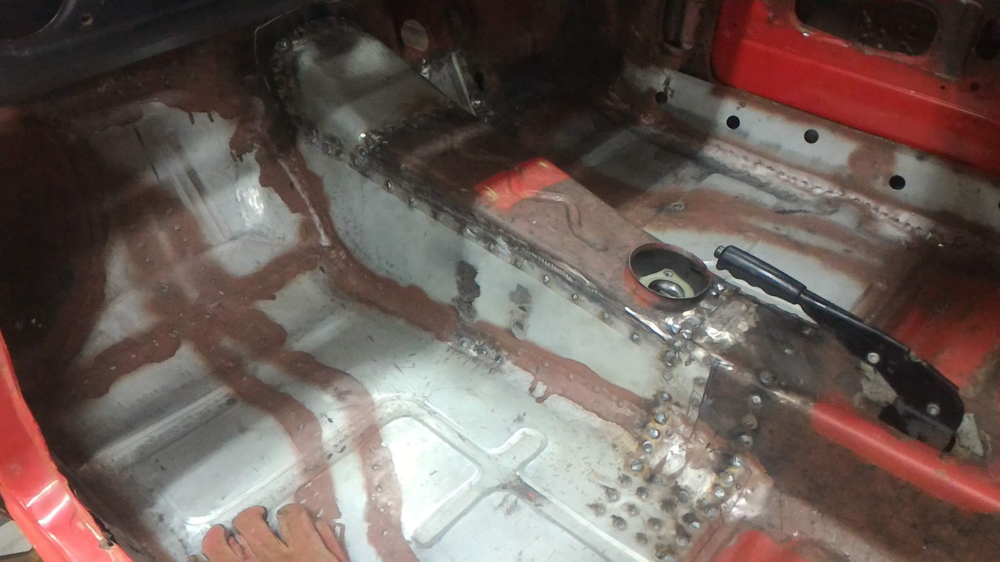

Hurmeez Posted June 27, 2017 Author Posted June 27, 2017 The eagle eyed among you may have noticed some holes drilled in the trans tunnel under the center console in the last post. They foreshadow the next step on the journey. The next thing we wanted to do was get the type 9 in the hole to see how things were going to line up and how much fab work was going to be necessary. So that meant making a bloody great hole in my car!! As you can see from all the holes, we carefully located all the spot welds and delicately drilled them out before gingerly hacking the firewall to pieces with a dodgy grinding disk. The seat boxes were pulled out at the same time revealing more rust holes. By doing it this way the plan was to move the top of the tunnel rearward to retain the stock swages and shape. Then a simple patch was to be made to cover up the gaping hole opened up at the front of the tunnel. Simples. Also the gearbox mounts were removed in a similar fashion to be relocated to fit the type 9 at the same time. Here we've hung the box off the hoist to put it within cooee of the right spot. The rust holes that were under the seat box are clear here as well. Then it was a simple task of marking up the new shape and trimming the paper thin factory ford steel with tin snips. But that's enough excitement for tonight. More tomorrow. 6 Quote

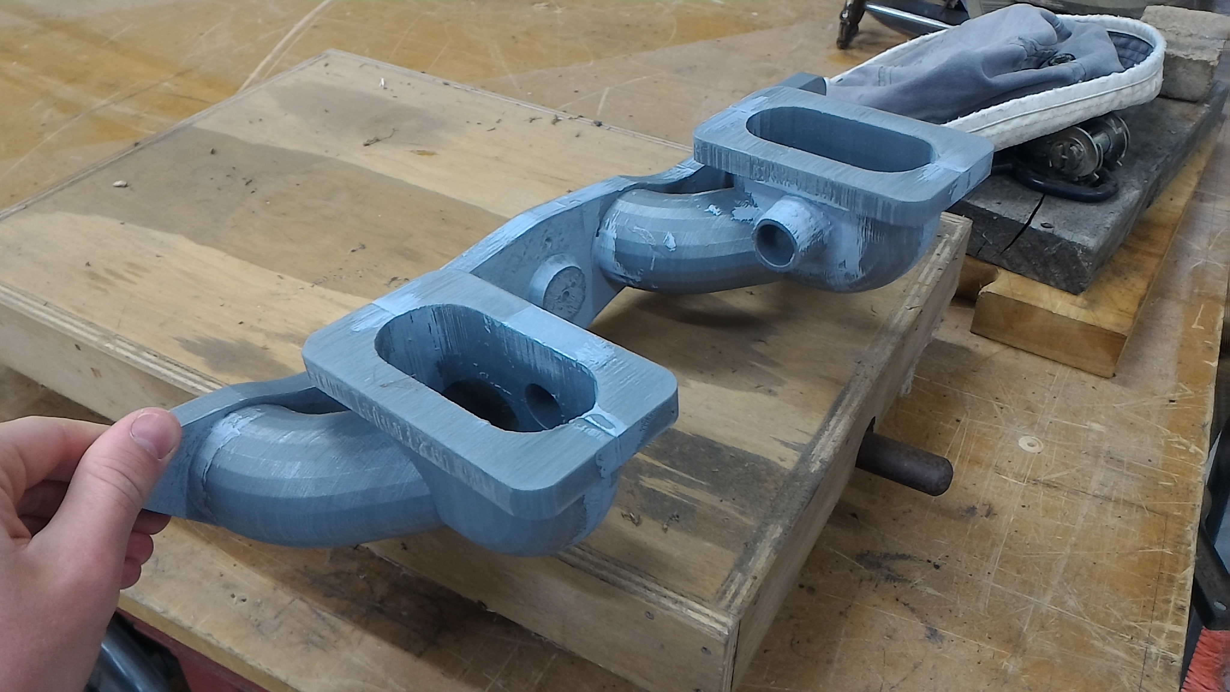

Hurmeez Posted June 28, 2017 Author Posted June 28, 2017 In other news, my manifold came back! It's much shinier now than when it left. Here it is in the jig we made up to hold it in the mill in the school workshop. Not to bad for a quick 30 minute jobbie. And this is it after starting to milling it flat. The cutter is typical school quality after being used by a bunch a 13 year olds (that is to say it's pretty fucked) so it wasn't the best finish. That said it's nothing that can't be cleaned up on a surface plate with some fine grit sand paper. Unfortunately the mill wasn't big enough so it was put on hold for a while until I could get access to a bigger mill at a local engineering shop. So for now that's extent of the manifold story. 6 Quote

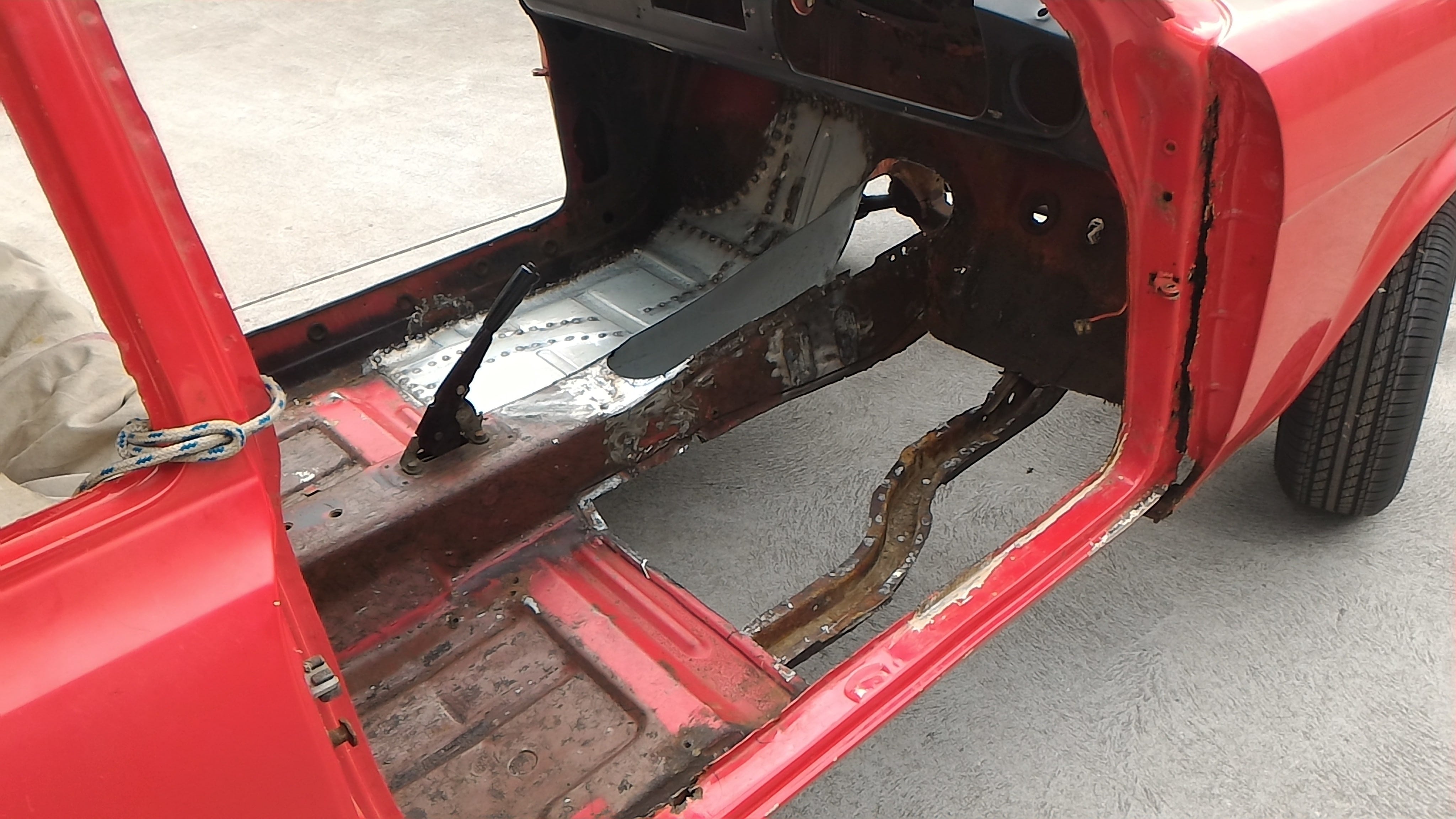

Hurmeez Posted June 28, 2017 Author Posted June 28, 2017 Finally we're back into the fabrication work This time it was all my work. Again I didn't take many photos of the process unfortunately but the results got documented well. Firstly I welded in a new tunnel side for the drivers side. Then I tacked in the floor pan to the new steel, and fully plugged it in. Once that was done I replaced some steel on the edges of the tunnel top to give me some more space meat to weld it back in and then did exactly that. Then it was a matter of making a covering panel for the gap opened up at the front of the tunnel and putting that in, before modifying the tunnel brace to make it fit in the more rearward position required by the longer gearbox and welding that in too. You can see the huge number of plug welds on that brace alone which explains why this was a fair bit of work all at once. At the same time I remounted the gearbox mounts in the new location (as you can see from the welds about halfway down the side of the tunnel) and fabbed some gearbox mount spacers to drop the box down the right amount to keep it all in the right spot. Unfortunately this is the only photo I took of it but use your imagination. The square plates blank off the ends of the square tubing and the bits of tube are welded into the holes to form crush tubed for the bolts to pass through. Trust me when I say the came up pretty neat. 3 Quote

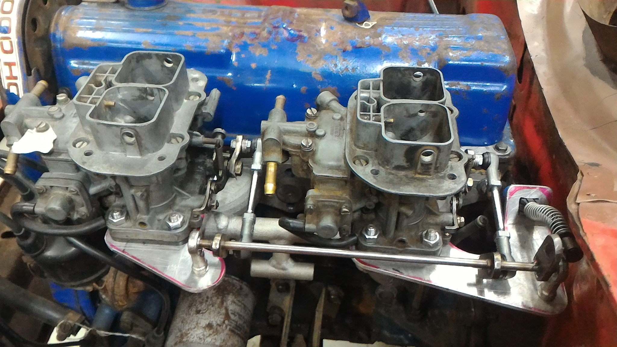

Hurmeez Posted June 28, 2017 Author Posted June 28, 2017 My next mini project was sorting out the twin carb linkage setup. I drew a lot of inspiration from the setup on my dad's 1600 but made a few tweaks. His is designed with the primary venturis furthest from the intake ports with the idea that when the secondaries open they have a straight shot down the thing's neck. In the interest of throttle response I've decided to instead put the primaries closest. This probably has little real world effect but I liked how it sounded. As you can see from the photos, there is a central stainless shaft mounted by a pair of rose joints, themselves mounted to two alloy plates clamped between the carb and the manifold. Off of the rod are mounted three stainless arms. The first is connected to the standard RS2000 throttle cable. The other two are connected to what I can only describe as miniature track rod ends which themselves are connected to another set, then the final linkage onto the carb. I back of the envelope calculated the lengths of the different arms to give me full pedal travel for full butterfly travel, hopefully avoiding a super twitchy throttle like the one in my dad's car. I also added an extra return spring on the cam cover just in case. In hindsight I want to revise the linkage with the two tie rod end things because they are both right hand threaded onto the central rod. This means I can only adjust the length of this part by one full turn relative to each other which would make balancing the two carbs damn difficult, if not impossible. Here is a video of the linkage in action, And here is a bonus video of milling up the carb face of the manifold. A huge thanks to Earle Tito Engineering Ltd for going the machining. 6 Quote
