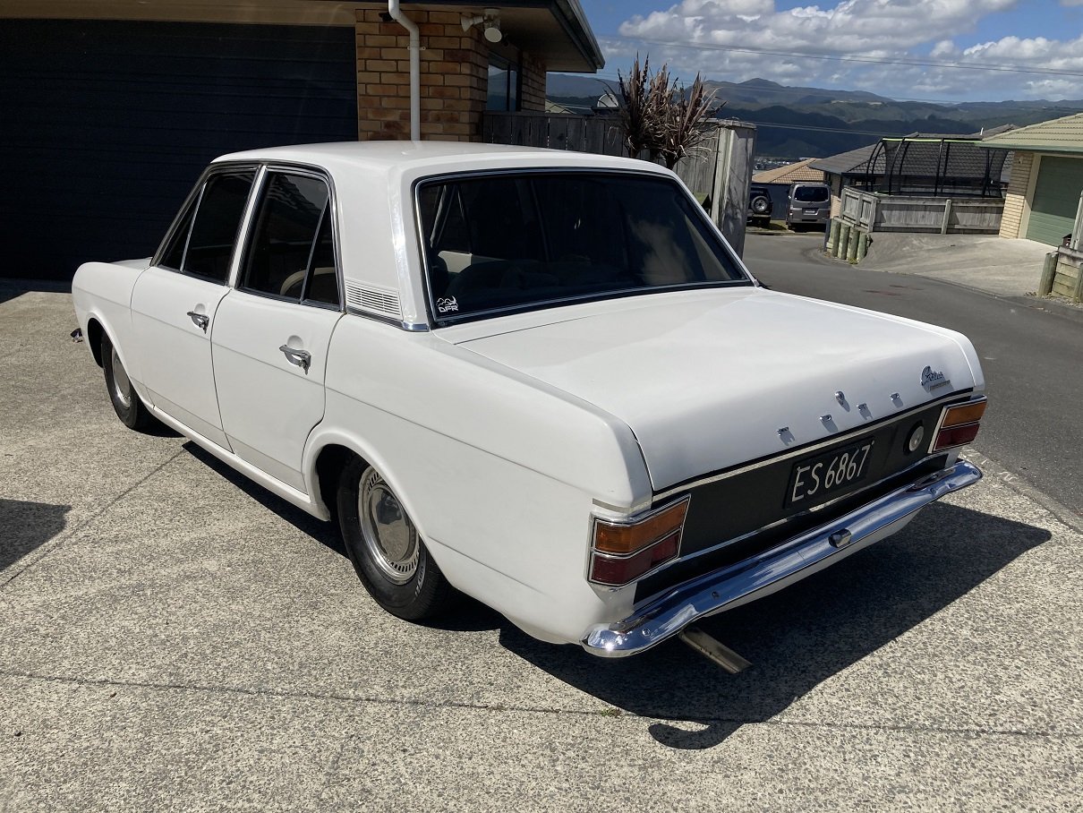

PHLEX Posted September 12, 2021 Author Posted September 12, 2021 Few years between posts but I'm still here! There's been a couple of big gaps between any sort of progress, mostly due to losing motivation not being able to find certain parts. Bit of an update ahead and I will try to backfill some photos where I can. Early 2019 I made a start on preparing the Cortina to be used as our wedding car. This was going to include its first drive further than 20km and with other people driving it so I needed to make sure it was going to be reliable. First issue I had was over about 80kph it felt really floaty and generally unstable. I took it down to get an alignment and was told lowering the front had caused the front wheels to shift too far back in the guards which was causing it to float around. He suggested trying to get some castor adjustment to bring them back forward. Unfortunately easier said than done as this is the swaybar and nobody seems to make adjustable units for the Mk2 that ship to NZ. After speaking with a friend who has had the same issue with his Mk1, he gave me some instructions and we set about modifying the original item to move the wheels forward. Back on the alignment machine and came up significantly better. Can now do a bit over 100kph without issue. Next annoyance was the vibration I had been trying to remedy, Eventually we diagnosed this as the pinion angles of the gearbox and diff which is why putting the saggy old springs in took the issue away. With the help of some diff alignment shims I managed to get this vibration to almost disappear other than a small wobble off throttle at about a 10kph window between 80 and 90kph which was livable. I also took the time to install some semi sealed lights on relays to take the load off the factory wiring. Major improvement over the old sealed units! A friend helped me give it a really good cut and polish to make sure it was looking its best for the photos and it performed the duties well. The morning after the wedding we found a small but noticeable puddle of coolant under the radiator so it sat in my parents garage for a few weeks while a replacement alloy radiator made its way over from the UK so I could drive it the hour home. I coupled the new radiator with an electric fan and thermo controller in case its ever needed in traffic. February 2020 I decided to blow the dust off and get it to British car day. I hadn't done any work on it for a while so decided to re wire everything forward of the firewall and wire tuck as much as possible. This stemmed from the quick job I did wiring in the brighter headlights This went really well, i was super stoked with my work and the modern fuse box has plenty of spare spots for extra wires later down the track. The day before the event it was all legal and ready to go and i decided to pop out for a quick drive and I hadn't latched the bonnet properly which meant as soon as I got to about 30kph going down the street it flew up, fortunately stopping vertical before hitting the windscreen. Whoops!!! Took it off and banged it back straight to get to British Car day. Morning of British car day I met up with a few other small fords and we had a bit of a cruise on the way to the event. It became very apparent the gearbox was in desperate need of some attention as the bearings got noisier and noisier during a run through the hills and the vibration got to the point of unbearable. Fortunately the event was 5 mins from home so after parking up for the day it wasn't too far to limp home. 7 Quote
PHLEX Posted September 12, 2021 Author Posted September 12, 2021 Right so the only notable update between Feb 2020 and Feb 2021 was during covid lockdown a gent in Levin listed up a few old gearboxes for sale he had hoarded for 20 years or so, one was a Type 3 and a suitable replacement so the deal was done and as soon as we went to L2 I drove up and collected it. I got the noisy one out and noticed straight away there were some differences as the replacement was an earlier unit, most likely from a mk1 GT, the most annoying being the slave cylinder was different and the one supplied with the box was buggered. The bellhousings also couldn't be swapped over for some reason which I cant remember. Anyway I managed to source another used slave and rig up a line to make it work. Took it for a drive, nice and quiet and a lot less vibration-y than the previous box so that was a win. One thing that I just couldn't get to work right was the clutch needed a couple of pumps to work which made it a pain to drive, so it sat for almost another year while my skyline got all the attention. Fast forward 9 months to Feb 2021, Trade me is doing free selling for vehicles.... Yes i'm going to be that prick and "test the waters" so I listed the car with a list of what i know it will need for a WOF, put a realistic price on it comparable with others in similar condition. The following day as British Car day again so i "transported" it down there and had several people come up to me telling me not to sell it (had been up for 20 hours by this point) On my way out of British Car Day the diff started clunking so took it home to investigate and the pin had started walking out of the diff. Fortunately I caught it in time and managed to fix it (or so I thought). After hanging out with a few other small fords I got motivated and decided to work my way through the list starting with getting the clutch sorted. After a bit of mucking around I found it was just massively mis-adjusted so was a relatively easy fix. By this time I had received a fair few serious offers for the car but none at my "absolute bottom dollar" and couldn't bring myself to sell it cheap. General consensus was it would sell easier with a WOF so I took it off the market and kept working through my list. Next job was to fix some rust in the boot floor and mount the tow bar I have had sitting around for about a year as it fouled on the exhaust so I never got round to fitting it. Rust was fairly easy to sort, Bit of upside down welding to keep me on my toes. I jerry rigged the rear muffler mount with some cable ties ready to drive down to a friends workshop to replace the very rusty exhaust. I'm getting too old for long periods of time under the car so a hoist was a must for this. I'm fairly new to welding and this was only the second exhaust I had made from scratch so altho the welds are ugly i'm happy with my efforts. 7 Quote
Popular Post PHLEX Posted September 13, 2021 Author Popular Post Posted September 13, 2021 Well those two posts cover 2019-present day fairly well. Car got a new WOF after the exhaust was done and then on the way home the diff center pin worked its way out again, i was about 2 blocks from a mates place so limped it there and came back with the trailer. Unfortunately this time it had contacted the pinion and taken some chunks out. I pulled the center out of the diff hoping that I could replace the crown wheel and pinion with better spares I had but unfortunately one of the thrust washers had come out and been chewed up so I decided to quit there and find a replacement that hadn't been messed with, ideally in a 3.9 ratio which would be less revvy at 100K, Fortunately a local guy noticed I had asked for a shipping price on a diff in Auckland, messaged me and said he had just pulled one out to install an LSD and we did a deal. Whacked a new pinion seal and diff gasket into it for good measure and into the car it went. Much nicer at 100k now and really didn't notice much of a drop in acceleration. In June we moved house, currently renting while we build and the Cortina made the 45 minute drive without a hitch although that damn vibration was coming back with a vengeance. The car now lives on a set of roller dollies and gets pushed over to the side of the garage without a door so getting it out it a little bit of effort but hasn't stopped a bit of progress. During some Level 4 boredom I had another crack at the diff and gearbox angles and made the vibration better but it was still apparent. I did some more research and found out the gearboxes have a bush in the rear housing that is prone to wearing out and causes vibrations of the driveshaft that increase with speed. This prompted me to go searching and I found Burton Power in the UK stocks them. Next thing I know my original noisy gearbox is in pieces, turns out to get the bushing out the entire gearset has to be taken out so I ended up ordering every bearing, seal, gasket and a new bush which arrived about 5 days later, some parts were fiddly but I managed to get the thing back together after paint stripping the casings and giving everything a really good clean. I had to wait for level 2 to be able to buy some paint to pretty it back up. I also found out while looking through the Haynes manual that the box is a GT unit with closer ratios just for a bit of cool factor. Spent most of this weekend swapping the rebuilt gearbox back in, had to modify the exhaust slightly as this box didn't require as bigger spacers to get the angles right (see above in the exhaust pic) and while I was under there I also tended to a little bit of surface rust and gave everything a good check over, Road tested last night and absolutely over the moon with my silent and smooth rebuilt gearbox. Feeling quite motivated to keep up the build now, I came on here this morning and read through my build thread and was cool to see old pics of what I had done so far and thought I would update. Next job I am going to tackle is the starter solenoid is playing up so I have sourced the correct style starter and ordered a new external solenoid to wire in. Hoping to do that over the next week or two ready for its next WOF at the end of the month ready for summer cruising. 16 Quote
