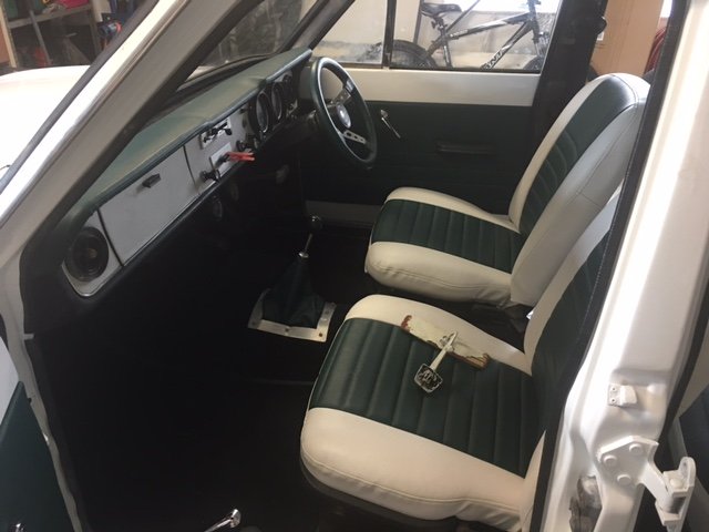

Retrimmed interior - really the selling point for me

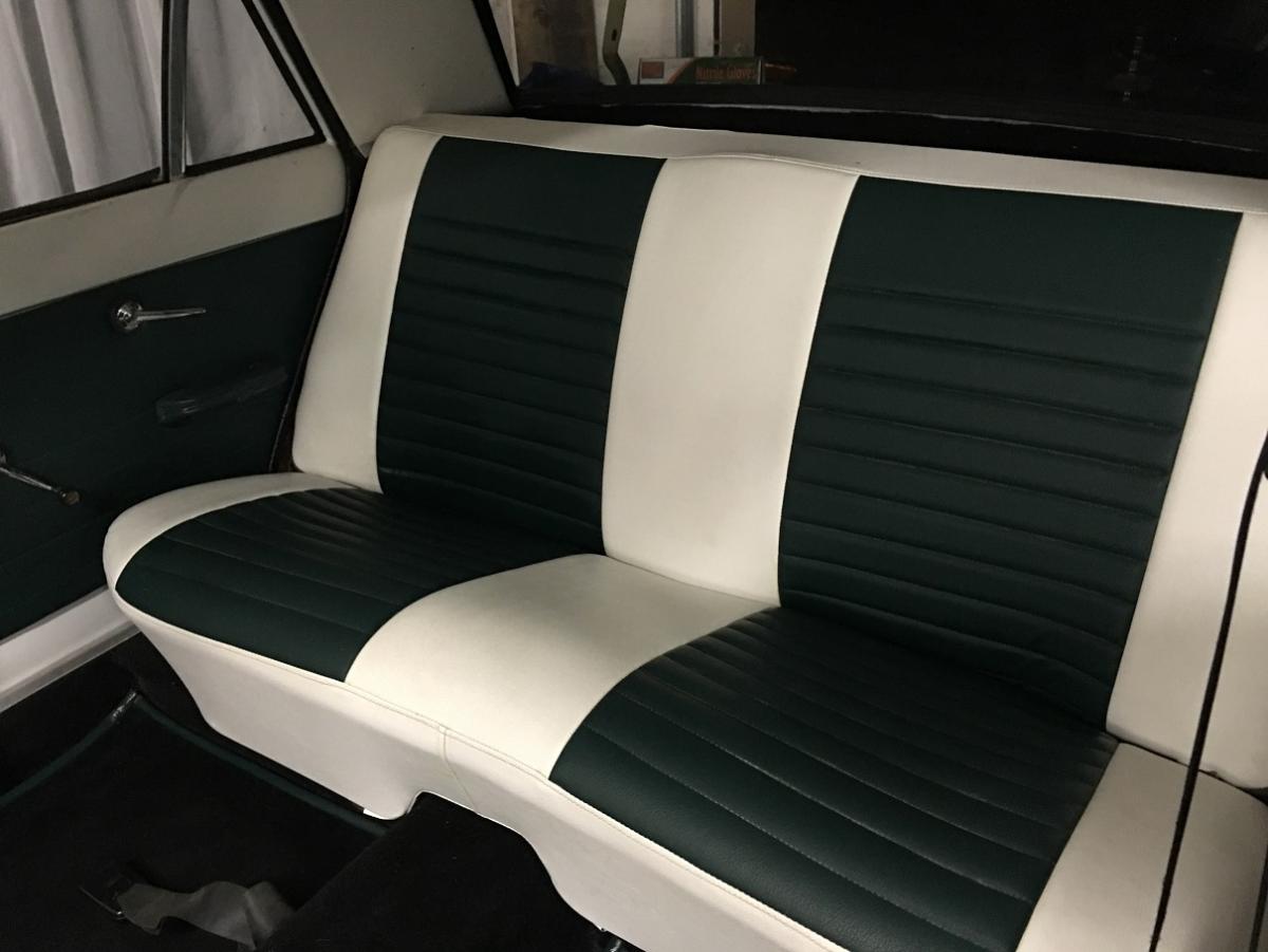

Final step for the night was to give the back seats a really good clean and they look brand new again!

Tonight's job is to put the seats back in with the new plates and give them a clean and then the interior is finished for now!

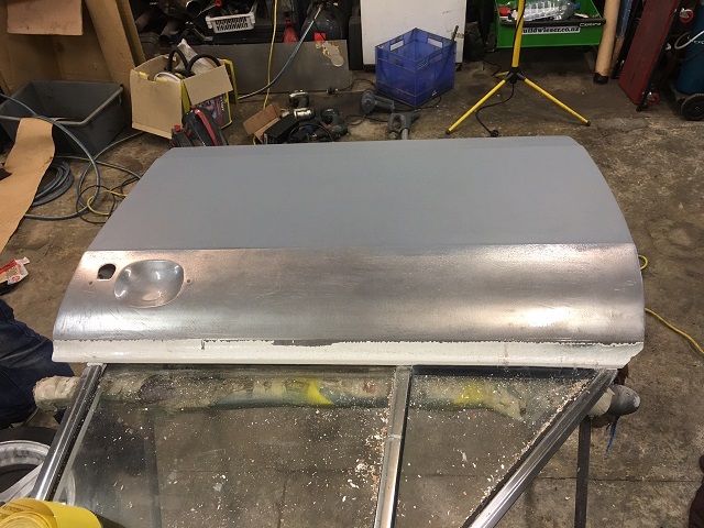

Next job is getting the passenger side doors stripped and primed. Both front doors were taken back to bare metal by the previous owner and I bombed them white when I got the car to prevent rust, I spent a bit of time today with some paint stripper and have got most of the front passengers door back to bare steel and its looking alot better already!
Ā
Passenger door progress so far. Surprisingly good condition.Ā

Made a start on the brand new old stock drivers door I scored. Spent about 3 hours sanding the stock primer off the door as it was powdery and brown so to avoid it coming through the top coat I went back to bare steel and etched the whole door, Even being brand new it required a small amount of filler in a few places from being knocked around.

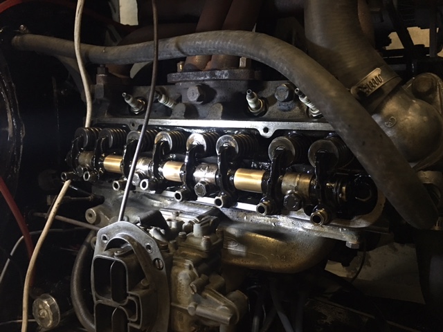

I had been getting quite frustrated as the cortina would sometimes start easily and run well enough to drive on and off the trailer and into and out of the garage and other times it would run like a bag of shit and there was no real rhyme or reason to how it was going to run. I decided to bite the bullet and replace the 32DGV carb that came with the car originally for a larger carb more suited to the 1600GT engine its now got in it. A bit of a search on trademe and I managed to find a guy who had a few WeberĀ 32/36DGAV carbs in various conditions. I did a deal and bought 2 carbs, one with the auto choke assembly and a spare one missing the choke but otherwise complete. I had absolutely no idea if these were even compatible but I could see plenty of listings stating the 32/36DGV DGAV and DGEV being used on the 711M 1600s so thought it was worth a punt
Installation was a prick. The fuel line goes into the other side so I needed to re route the hose, there is another port off the other side that I assume is fuel overflow which I have blanked off for now and the worst bit was the accelerator pedal linkage is totally different so I had to hori it up with some cable ties while I find / make the correct one.Ā
I got it all hooked up and plumbed in, forgetting about the auto choke hoses for now as Im not convinced it needs a choke, jammed the choke butterflies openĀ and then proceeded to run the battery and then the first jump packĀ flat trying to get it to start and finally gave in and used some engine start spray and it reluctantly fired into life. It ran like absolute shit, probably worse than it ran on the 32DGV carb which is actually a 1300 carb.Ā
Disheartened I packed up and went inside, doing a bit of research and confirmed this was in fact the correct sized carb to be running on the engine I have so at least i felt better knowing I hadn't completely wasted $200 buying the carbs and that it was probably just in need of a service so thought i might just try the spare carb without the choke and see if that's any different tomorrow.Ā
After I had gone to bed i suddenly though that maybe it was a spark issue not a fuel issue as the last few times I tried to drive it on the old carb it was running like a bag of shit and I had put that down to the old carb being too small and not jetted for the 711M. So this morning I whipped out a spark plug and whaddayaknow it was caked with an oily substance and looked 30 years old. Quick trip to repco at lunch and got a brand new set.
Got home round about 5:15, chucked the spark plugs into the motor, jammed the butterflies open again (auto choke not hooked up), quick spray of engine start and it started first pop on the key but diedĀ as soon as I let off the gas. Quick fiddle with the idle screw and fired it straight back up, this time holding a smooth idle and no complaints. By 6:00 i had done a couple of laps of the block and a 2km trip down the bottom of the hill and back and was thoroughly impressed. I took my Gopro to film the experience but noticed half way down the road there was no SD card in it - whoops!!
