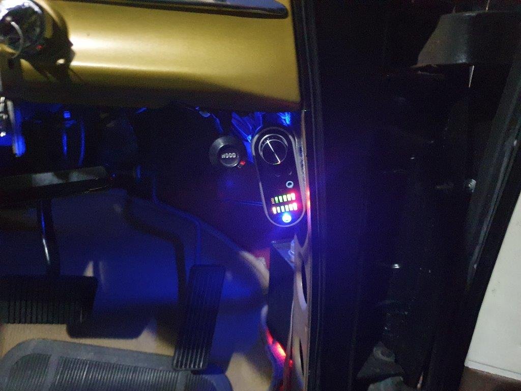

Popular Post Kiwibirdman Posted June 17, 2024 Author Popular Post Posted June 17, 2024 Played with the car over the weekend. Refitted the throttle stop under the accelerator. I had pulled it out when I put the sound deadening and carpet in. It is only a bolt with 2 nuts and washers that goes through the floor. simple to make and fully adjustable. I bought an Aliexpress blue tooth receiver and amp ages ago. It is in the car with some temporary speakers. Best quality temporary install. The amp is held in with velcro and the speakers by gravity. The amp doesn't really have the power to drive the speakers properly but will be good enough for the road trip to Taranaki. I have a Sony explode amp and sub with a pair of 6x9 speakers that I'm going to put in behind the seat. I'll put the Amp and probably a Kenwood mechless head unit under the cargo floor. I have a jaycar connector so that the speakers can be removed easily should I ever need the full back of the car. Since I own a Chevy pickup, probably not. Went out for a drive and the new plugs made a huge difference. Looking forward to the road trip. 11 Quote
