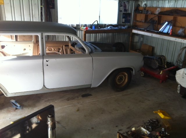

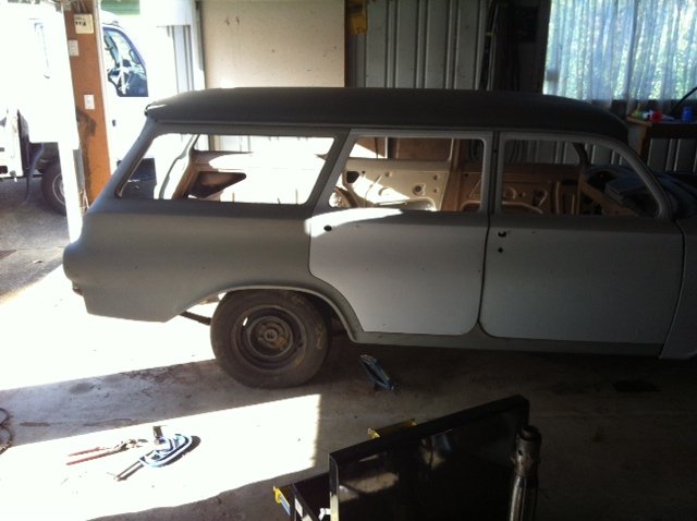

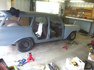

Kiwibirdman Posted February 22, 2015 Author Posted February 22, 2015 I'll jump now to where the car has got to. The body has been sand blasted. It would have been cool to have kept the original patina by it was rusting too much under the paint and the previous owner had got carried away with PA10 and a brush. The floor pans have been replaced, there is still some finishing to do, the trans tunnel might have to come out to get the 4L60E to fit. The Torana front is bolted in still with the Torana disks. The original 13 inch wheels are there to push it round on. It will get HQ disks and WB statesman callipers. The doors and guards have been panelled and primed. Next stop is the panel beaters, I have a new LHS sill to go on, the original is rotten and wavy. The new one was bent up by a crowd in Wellington and goes right through to the inner sill. I also have a new rear panel to go on. Like all EJ,EH Holden's the original was rotten, no paint from the factory. The factory cutout for the exhaust is gone to give me options for where the dual exhaust will exit. Here is the latest photo 7 Quote

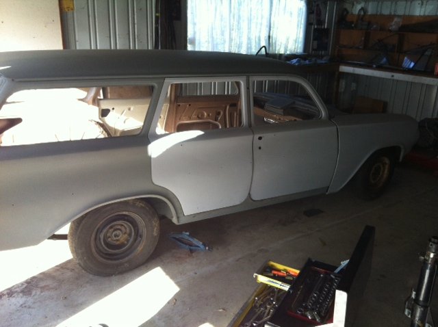

Kiwibirdman Posted May 16, 2015 Author Posted May 16, 2015 Finally got my act together and worked on the car today. My brother in law gave me a hand and we go the doors bolted on ready for it to go to the panel shop this week. Amazing what some doors do to the look of the car. I also played around with the front brakes. I was given a pair of callipers that apparently came off WB holden. They are PBR and all cast iron. They also don't fit on and LH Torana front end. The Aluminium body callipers that the HZ's got are the same as a UC Torana with a bigger spacer in the middle. I have a set on the front of the Firebird that may have to be given a new home. I have been looking for an excuse to buy the reproduction GM 4 wheel disc conversion for the Firebird and this might be it. I keep forgetting how small this thing is and how light the doors and guards are. Not having side intrusion bars, sound deadening and all the other modern crap like air-conditioning and electric windows makes a huge difference. Off to the panel shop on Thursday as long as the weather gods play nicely. Its been out of the rain for 20 years and I want to keep it that way, at least until it gets real paint and windows 4 Quote

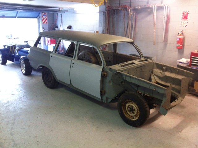

Kiwibirdman Posted May 21, 2015 Author Posted May 21, 2015 Today I played Hookey from work and got the car over to the panel shop. Managed to dodge the rain showers and only get a little bit of rain on it. My wife came and helped with the pushing around and winding the winch on the trailer. With the stress of the weather I forgot to take any photos. I will go down to the panel shop tomorrow if I get a chance and take a couple. Heres a couple of photos from the other day when I go the doors on and the threaded rod in to hold the front suspension up. It's got the 70's nose down thing going on big time. 8 Quote

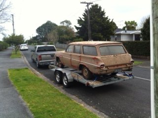

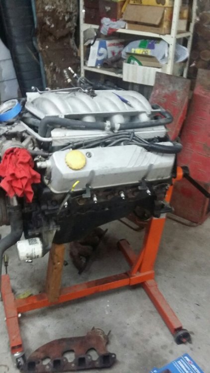

Kiwibirdman Posted May 22, 2015 Author Posted May 22, 2015 I swung by the Panel Shop to get a couple of photos to prove that the car has moved. Time to get the bonnet and front panels stripped of the should be shiny bits and off to be blasted. I keep forgetting how small these cars really are, especially now there is some space around it. Lastly I have bought a modified chip for the VT 5litre I have to go in from a Guy named Tony off trademe. The big thing is the chip has the VATS disabled. The tune should take the motor close to HSV specs. This should be fun, 190 Kw in a car that weighs 1200 kg with 215 tyres on the back.. 7 Quote

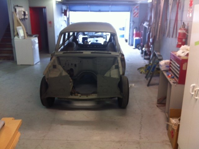

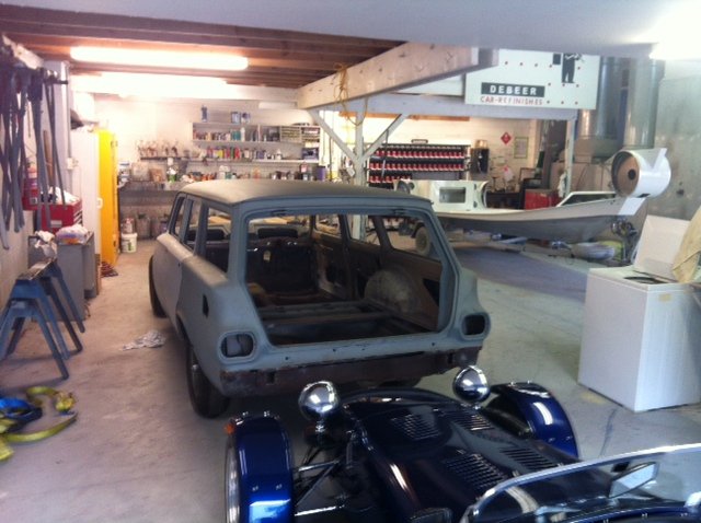

Kiwibirdman Posted June 3, 2015 Author Posted June 3, 2015 I went down to the Panel Shop yesterday to have a look at progress. They have started with the rotten rear section, all the cavities that Holden never painted from new. Some nice work being done, I did have to remind Phil, the guy actually doing the work this is not a show car and the underside will get a nice thick coat of underseal. Has to be functional, not beautiful. It makes a huge difference being able to walk around under the car on a hoist, much better than on your back while is on jack stands. The ETA for finishing is a couple of months, this is their fill in job to keep the costs down for me. I promise photos next time I go for a look. 3 Quote

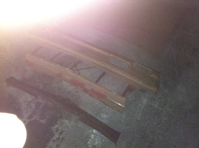

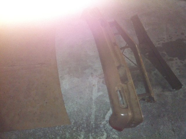

Kiwibirdman Posted June 10, 2015 Author Posted June 10, 2015 A bit of progress. I picked up the last panels off the car from the shed in Glen Innes and brought them home. The trim has been stripped off the bonnet and front panel and will be going to the blasters tomorrow. I'm hoping not too many holes come back. Some very crappy photos from my geriatric iPhone 3 Quote

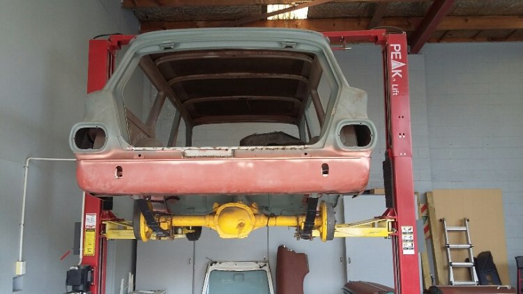

Kiwibirdman Posted June 25, 2015 Author Posted June 25, 2015 Small progress, I picked up some new disc rotors and wheel bearings from Supercheap last week. I picked them up today after getting 6mm machined off the discs and all being well, will fit with the HQ calipers I found. While I was out and about I stopped in to the panel shop to check on progress. Most of the work has gone on under the back of the car so photos don't show much. I got given the hurry up to procure the commodore fuel tank and boot floor. Time for a trip to Zebra Dudes wreaking yard. Just realised that the car is in the same spot from when I dropped it off. Last time I saw it, it was up on the hoist. So much better for working underneath. 3 Quote

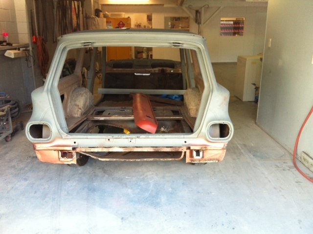

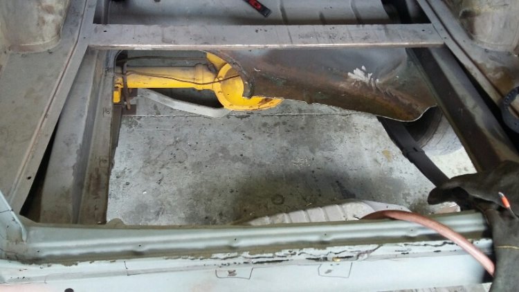

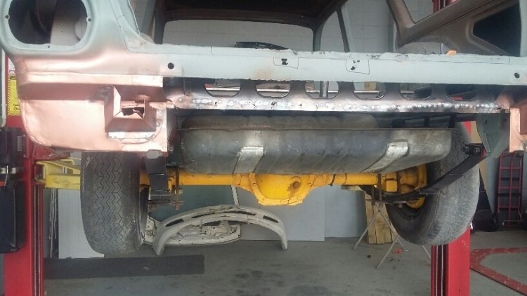

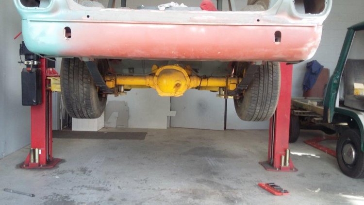

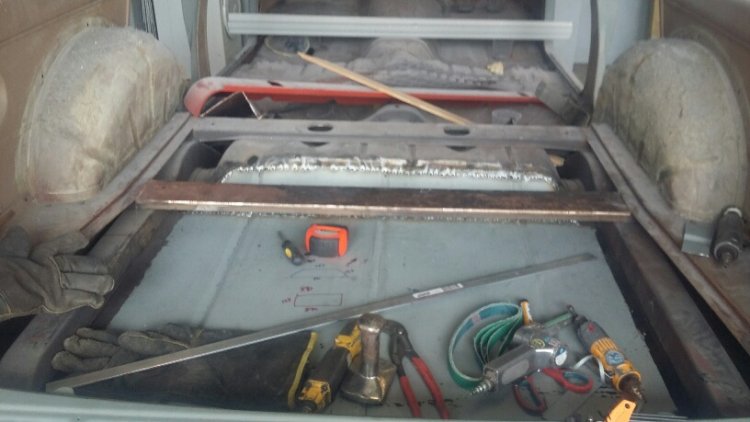

Popular Post Kiwibirdman Posted November 18, 2015 Author Popular Post Posted November 18, 2015 Here are the photos of progress Starting to cut the floor out Floor gone and tank in place New Floor in place. No more spare wheel, plenty of space for dual exhausts. Good to have the priorities right. Rear beaver panel on. 11 Quote

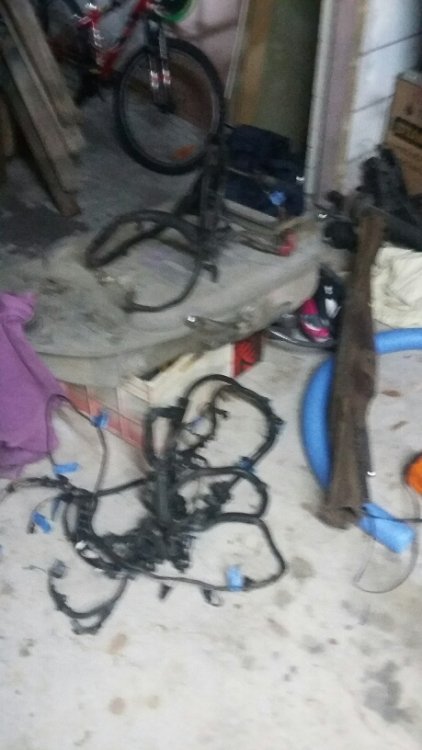

Kiwibirdman Posted November 21, 2015 Author Posted November 21, 2015 Since it was such a crap day outside I thought a bit of garage time was in order. One of the jobs I had been putting off was stripping the wiring loom of the motor. This is what I started with. After slowly taking things off and managing not to break anything major I found something that looks more like a 308. And here is a couple of miles of spaghetti, one loom on the tank and the other on the floor. Once I got into it the wiring loom doesn't look so bad. There is some stuff that will get removed and a few bits that can be simplified. Next stop finding a decent copy of the VT wiring loom that I can get printed off in A3 size. 4 Quote

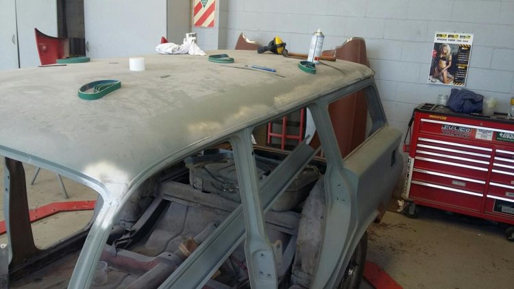

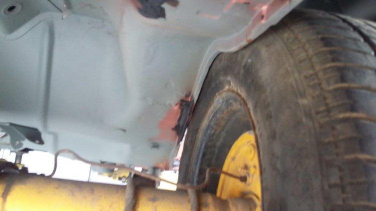

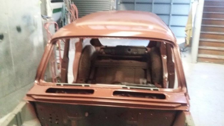

Kiwibirdman Posted February 9, 2016 Author Posted February 9, 2016 A long overdue update. After many promises of the Holden will be next to be finished at the panel shop there has been big progress over the last couple of weeks. Trevor the owner of the shop has been doing most of the work and now 90% of the cutting and welding has been completed. Here is a couple of photos that really don't look that different from while ago. I guess the great thing is that when its finished I know that all the rust is gone and it will be fill with fish oil so it wont be coming back any time soon. 9 Quote

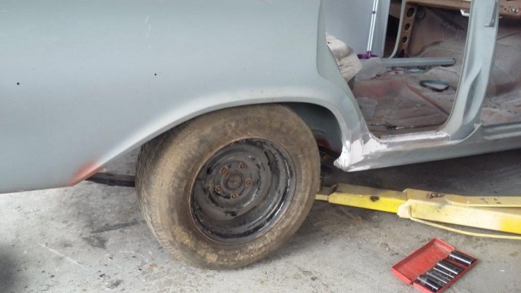

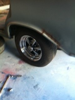

Kiwibirdman Posted March 19, 2016 Author Posted March 19, 2016 There has been slow progress since the last update. The panelbeater has been chipping away at the rust and it pretty much all gone, replaced with new steel. I bought a set of widened HQ holden wheels off trade me and picked them up today. There are 2 which are 7 inches wide without tires and 2 8 inches with tires. I'm hoping that the 8s will fit, they have a massive 5 inch back space and clearance could be an issue, or they could be bang on. Here's hoping. I'll go to the panel shop on Monday and see how they go. At the very worst the 7s will fit and the tires should be the right size 225/65/14 and they look almost new. Photos when they are on the car. 3 Quote
Kiwibirdman Posted March 21, 2016 Author Posted March 21, 2016 I went down to the panel shop to try the new wheels. Too much back spacing. Bugger I like the overall look. And the rear view I did put on one of the 7 inch rims which looks like it will be OK. I'll one tire swapped over and bolt it up, fingers crossed. Anyone want to buy a pair of 8 inch wide HQ rims, they will fit under the back of a HQ-HZ. 4 Quote

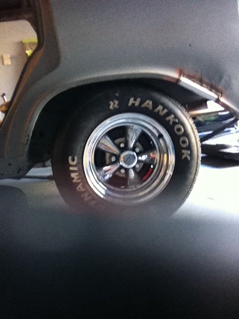

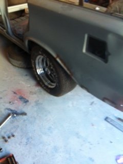

Kiwibirdman Posted March 22, 2016 Author Posted March 22, 2016 Got one of the tires swapped over to a 7 inch rim and bolted it up this afternoon. Perfect, not a lot of space, but clearance everywhere. I'll get the wheels powder coated and it will all be beautiful. Quote

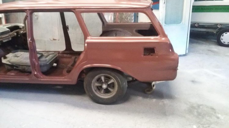

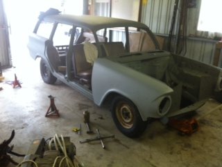

Kiwibirdman Posted March 30, 2016 Author Posted March 30, 2016 Here is photo of the 7 inch wheel with the 225 tire. My son likes it I came back from my trip away at Easter to find the car has magically changed colour Progress 3 Quote
