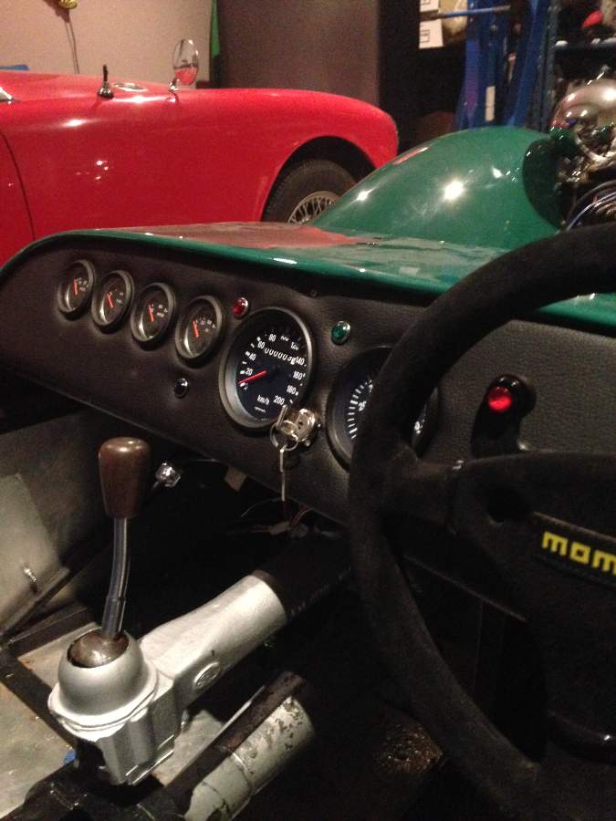

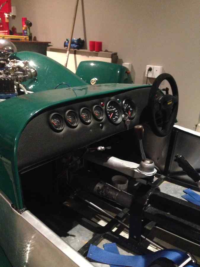

Went and bought myself some foam, vinyl and contact adhesive and upholstered the dash...
Cut the holes out
Test fit
Apologies for the less than shite pictures.
Pretty happy with how it turned out though
