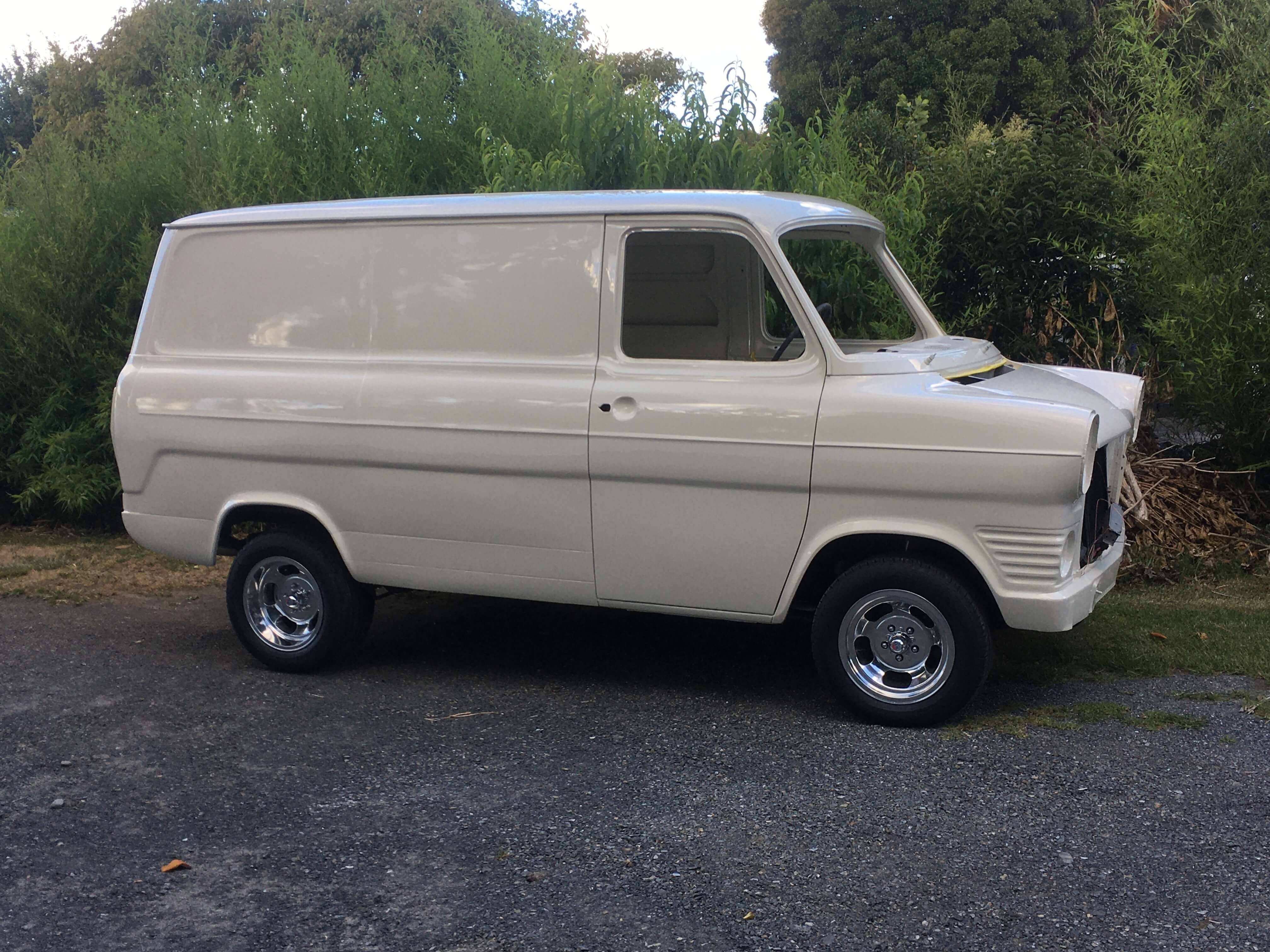

Popular Post browndog Posted April 6, 2021 Author Popular Post Posted April 6, 2021 I thought it was time for an update. Been a bit busy on other things, so the Mk1 has not had a lot of attention lately. But just cracked into it a week or two ago, and it is nearing completion now. Lots of NOS parts being fitted, which is always fun. A few pics to show the progress. 36 Quote

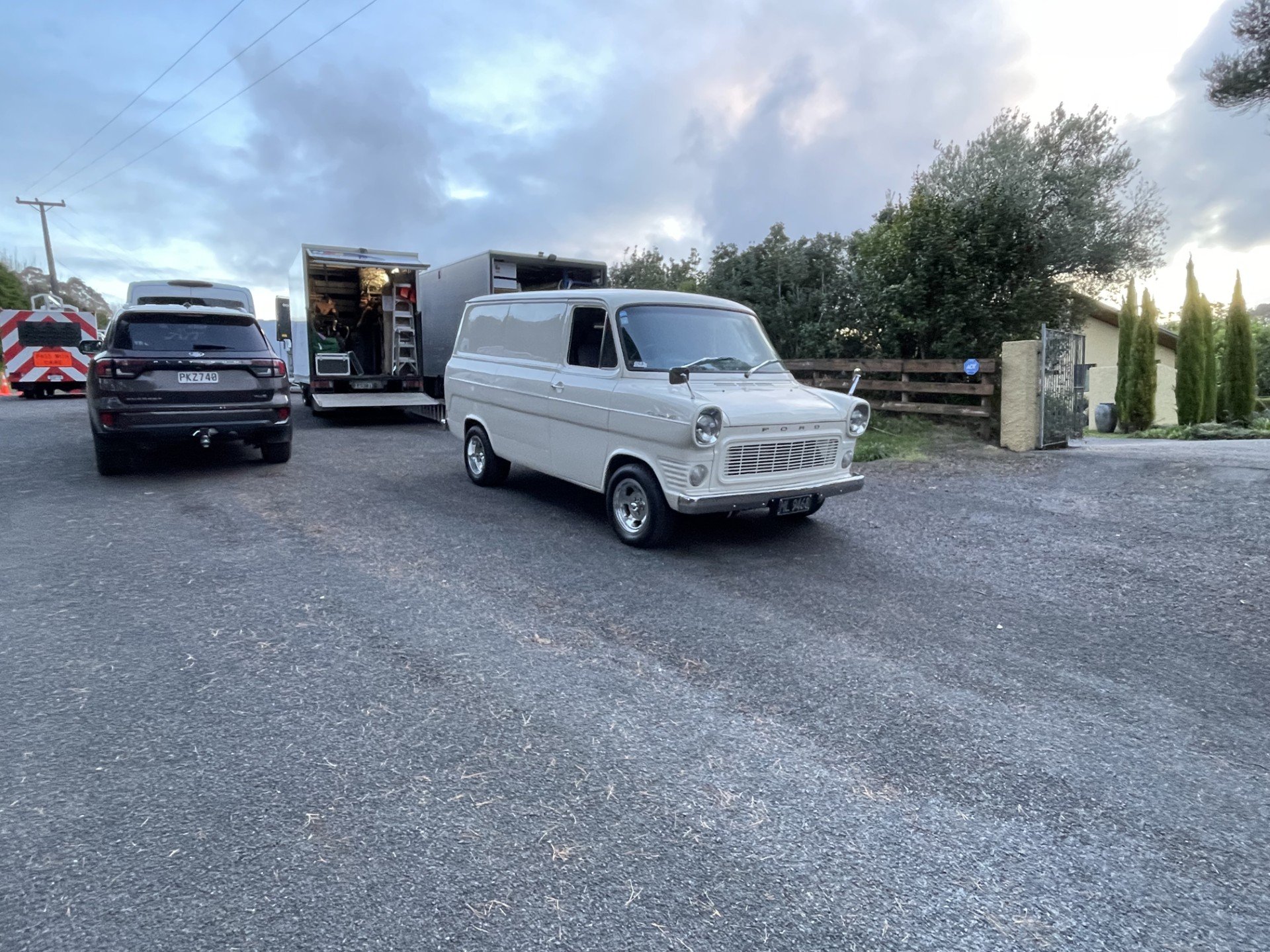

Popular Post browndog Posted August 1, 2024 Author Popular Post Posted August 1, 2024 I have done bugger all on the van since that last post, I haven't even completed that front brake conversion, too many other things going on demanding my time. But a few weeks ago I got the call from a production company I have worked with before, and the old bus was dragged out again, driven at moderate speed by a "stunt driver" who seemed suitably impressed by the speed and turn in characteristics of a 50+ year old van, cameras rolled, and the Transit starred again Will be appearing soon in a NZ production on Sunday night on your TV (although confidentiality clauses mean I can't say which one!) Which will bring me up to 10 years of ownership next month. Lots more planned for the old girl, all dependant on time and money, both which seem in very short supply at the moment! 15 Quote
