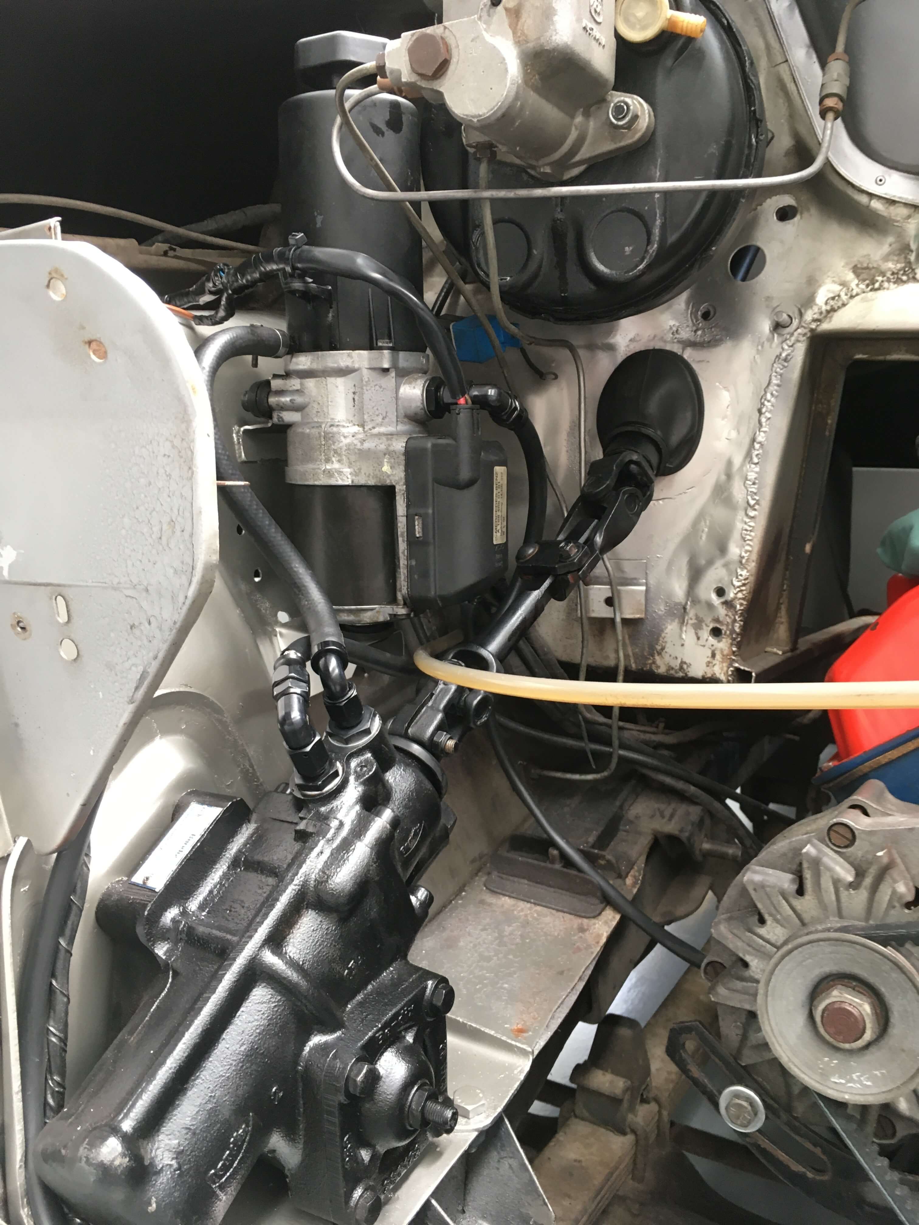

Popular Post browndog Posted January 9, 2020 Author Popular Post Posted January 9, 2020 I removed the steering box and original mounting plate. Mk3 Transit mounting plate now fitted and new steering box bolted in, much neater! https://oldschool.co.nz/index.php?/topic/45289-browndogs-1972-v8-transit/page/4/ 14 Quote
Popular Post browndog Posted January 27, 2020 Author Popular Post Posted January 27, 2020 Got the steering box and Mk5 column fitted in. Just needs the clamps welding to the column, and steering box mount welding to the inner wheelarch.I will fit a Mk1 bulkhead grommet to the lower end of the column to seal it at the bulkhead. I am going to use a VDO/Merc A class electro hydraulic pump to power this PS box, and this will be mounted just above the steering box. Engine is back together. I have installed a new Edelbrock cam and lifters,double row timing chain, and Edelbrock performer inlet manifold and carb to replace the standard 2 barrel carb and inlet manifold, and standard cam. I have a set of Hedman headers which I will also fit.Fortunately the engine had just been reconditioned before I bought the van, so still looks new inside!I deleted the engine driven power steering pump, which required a different crank and water pump pulley, and this has tidied up the front of the engine somewhat. https://oldschool.co.nz/index.php?/topic/45289-browndogs-1972-v8-transit/page/4/ 17 Quote

Popular Post browndog Posted March 10, 2020 Author Popular Post Posted March 10, 2020 Completed the steering today. Powered up the pump, and it seems to work well. Pump is a little bit noisy, it had a "jacket" which was wrapped around the pump, no doubt for sound deadening. I might refit it if it proves annoying. At the moment I have a Capri steering wheel fitted temporarily. But I think I will find a "Springalex" wheel, like they used to fit to the Mk1 Escort rally cars, and install that instead. The column is all welded up and bolted in too, complete with later "Tibbe" style ignition key, which is about a million times more secure than the original setup Discuss here: https://oldschool.co.nz/index.php?/topic/45289-browndogs-1972-v8-transit/page/4/ 12 Quote

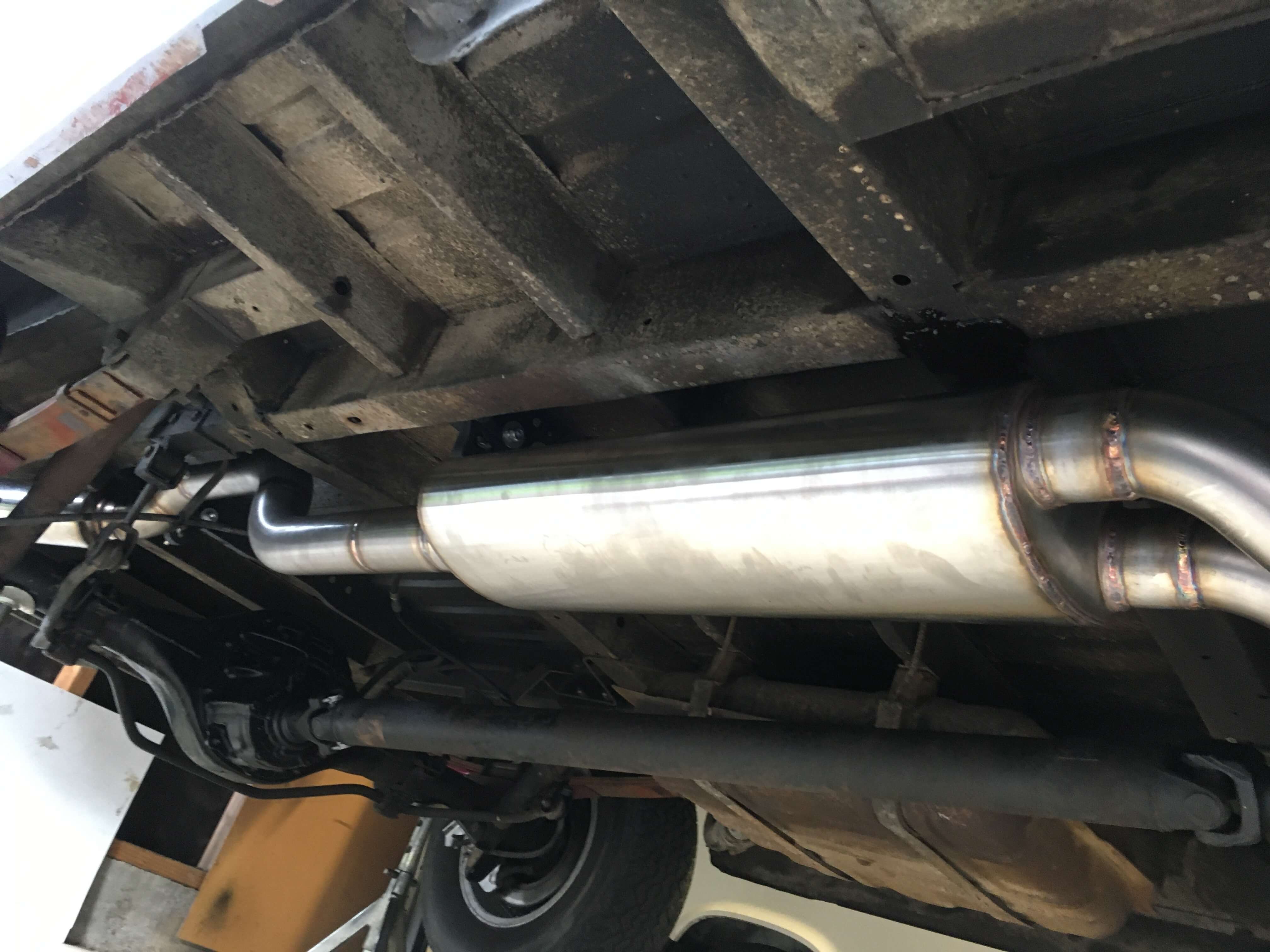

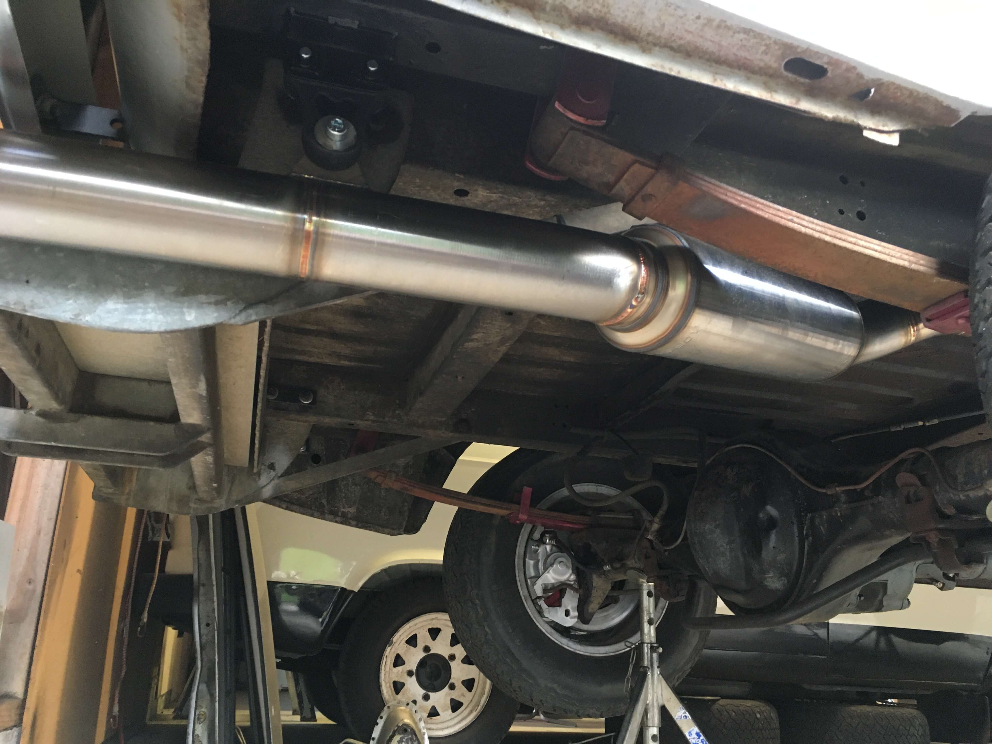

Popular Post browndog Posted March 11, 2020 Author Popular Post Posted March 11, 2020 A few pics of the new exhaust, which I forgot to post yesterday. Collectors feed into 2 1/2" diameter pipes, which feed into the first muffler. Then it's a single 3" all the way back, with a resonator just behind the rear axle. All 304 stainless, and TIG welded by someone with much better skills than me! Probably a bit overkill for the 300 or so horses, but who doesn't like big diameter stainless? ! Discuss: https://oldschool.co.nz/index.php?/topic/45289-browndogs-1972-v8-transit/page/4/ 15 Quote
