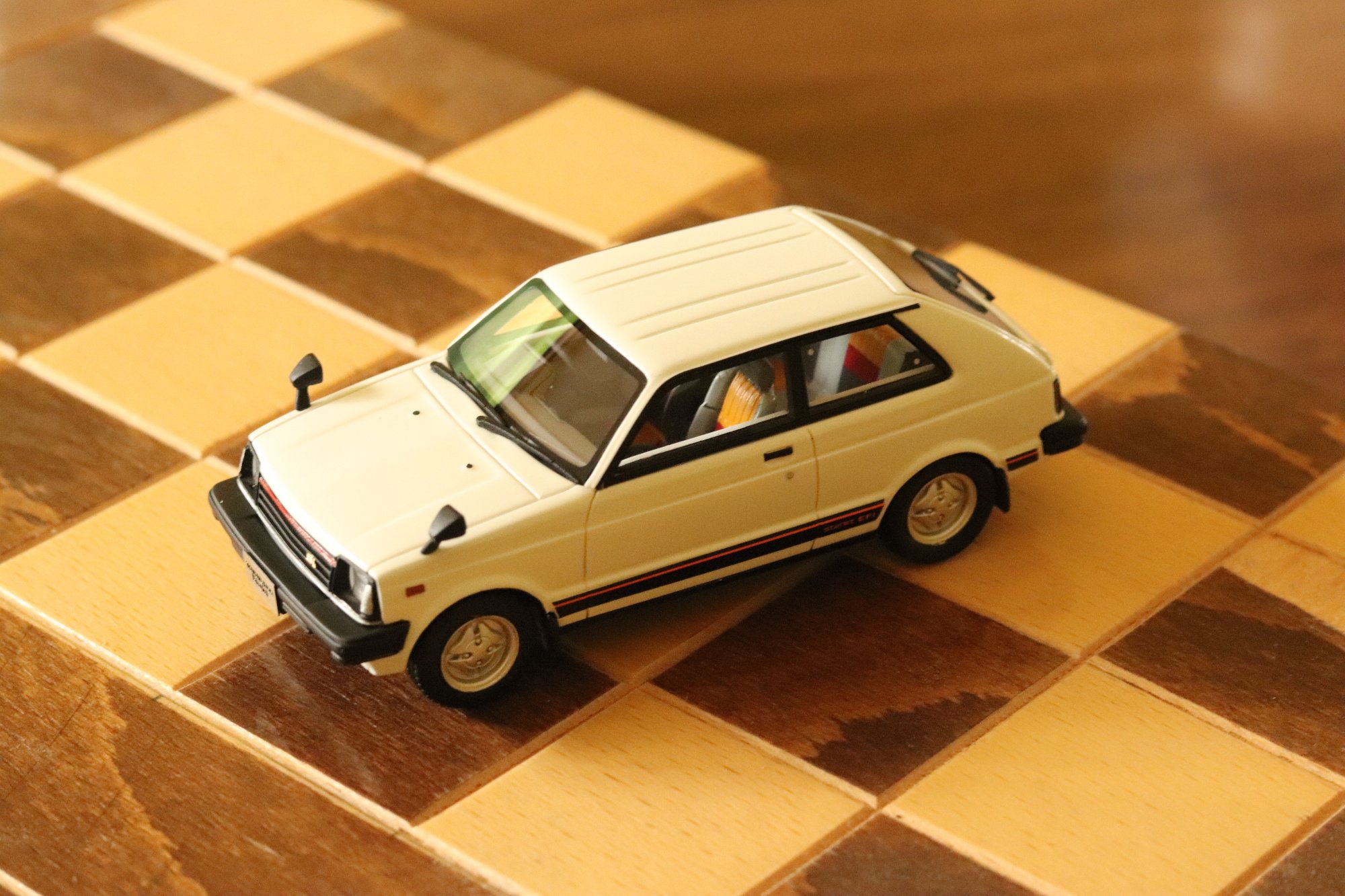

Popular Post ajg193 Posted December 13, 2021 Author Popular Post Posted December 13, 2021 An itty-bitty 1:43 Starlet just arrived in the mail today, super slow shipping from Japan. It's pretty rare to find a Slant front scale model, this one is made by Hi-Story and there was only one production run for them (this year). The detail on it is crazy, especially the interior. The only thing that lets it down is the wheels, they are slightly lacking in detail and don't actually turn. Oh and the JDM features like mirrors, bumpers and number plate lights. I'll probably just leave it on a shelf forever and let it gather dust. 17 2 Quote
