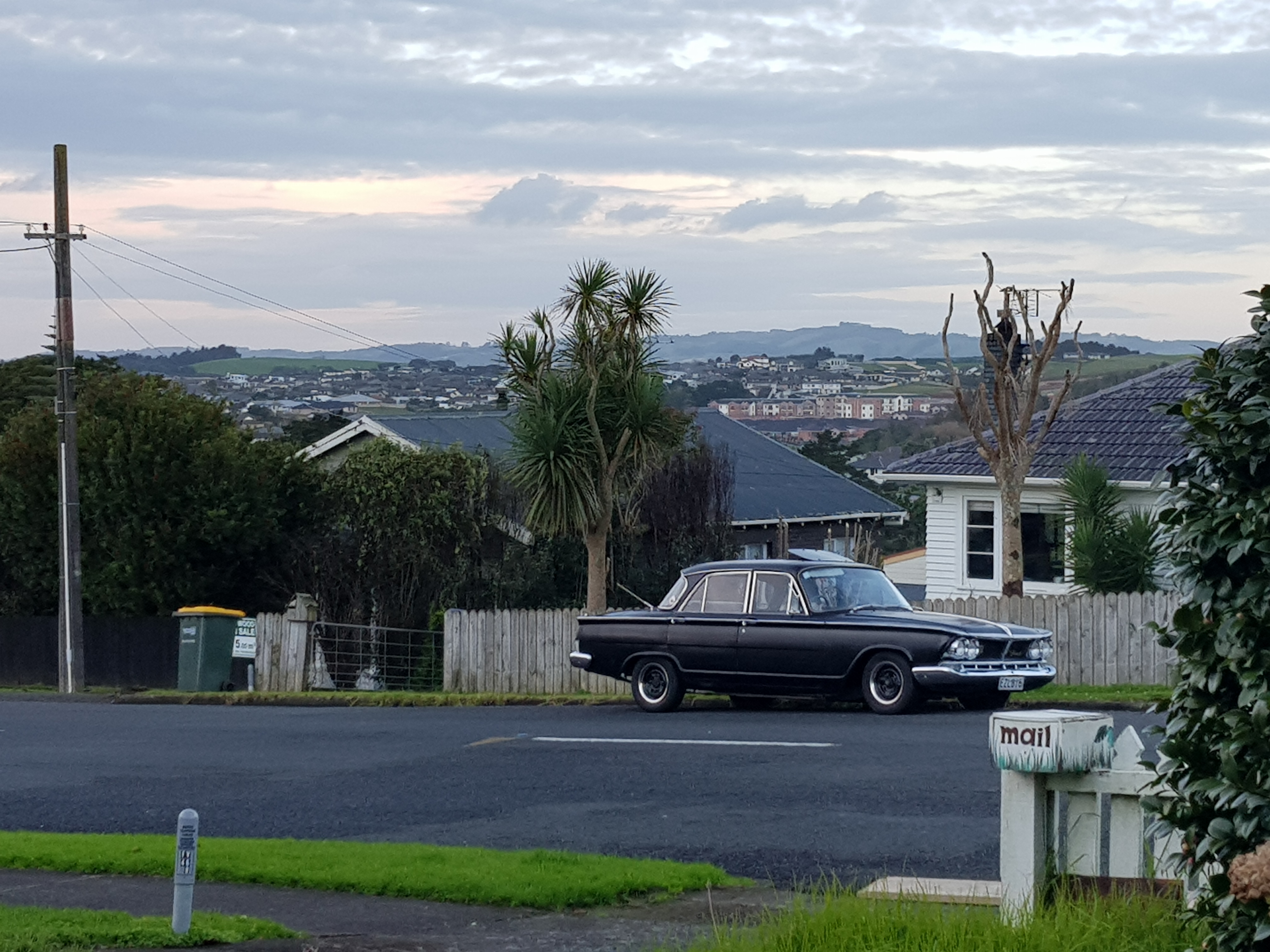

Matteybean Posted January 20, 2019 Posted January 20, 2019 Found a cool picture so thought id upload it. Really itching to get back to working on this!! Must Finish Crown! (Or buy a bigger garage on some land) Thanks for looking 6 Quote
