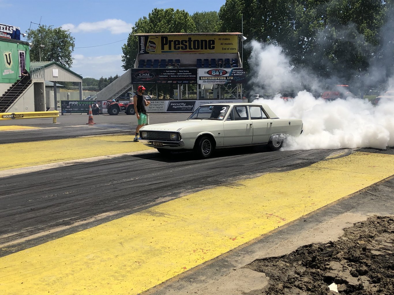

Popular Post cletus Posted July 11, 2017 Author Popular Post Posted July 11, 2017 since photobucket has turned into a bag o' dicks i downloaded all the good pics and deleted it. to celebrate heres some burnouts i did when i was cool and had a turbo still 37 1 Quote

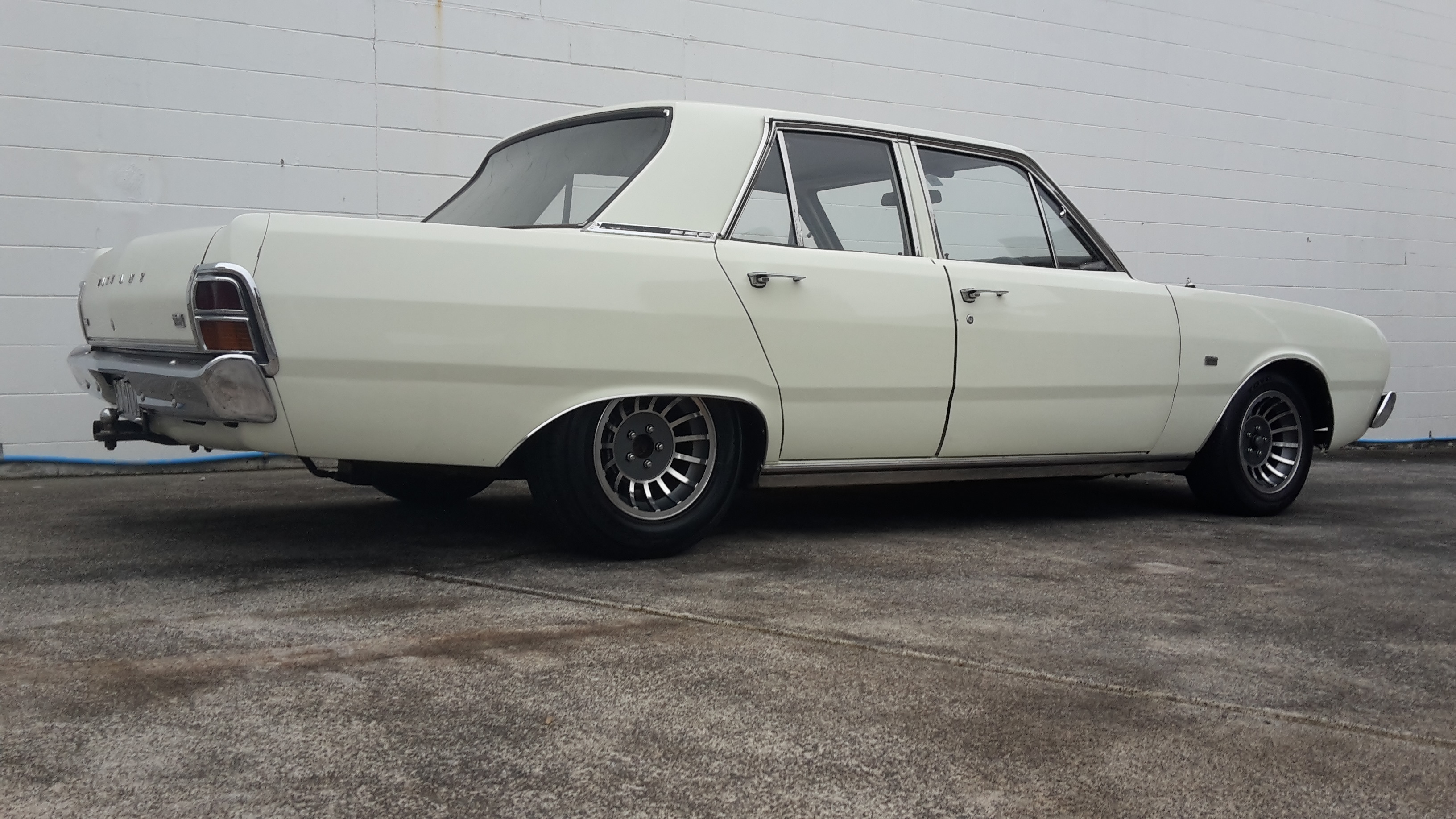

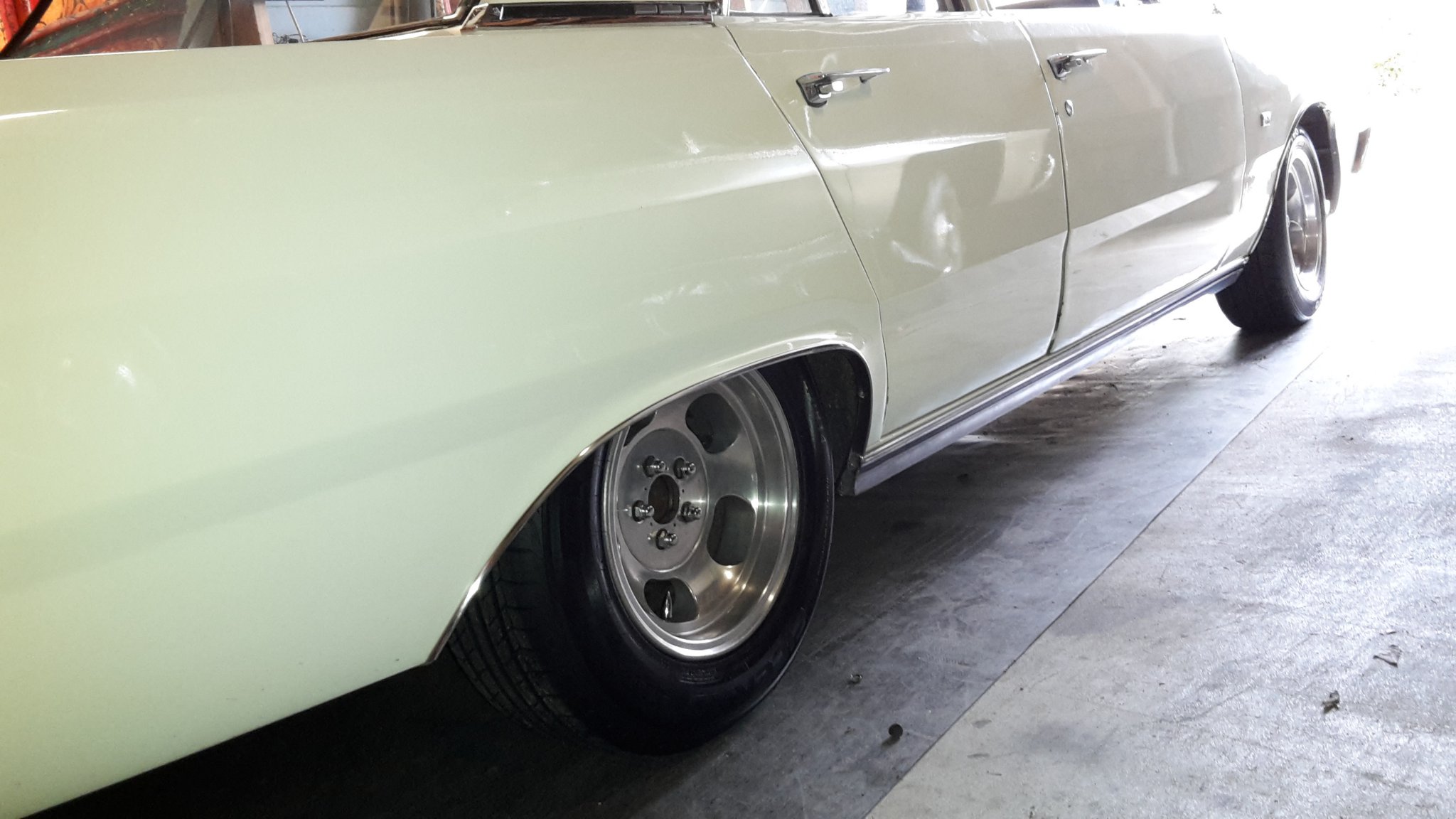

Popular Post cletus Posted June 2, 2018 Author Popular Post Posted June 2, 2018 Bought an alternative set of wheels. I bid on the original auction and lost, they were old crusty wheels that needed a tart up. then they ended up back on TM after being polished and painted the correct gunmetal colour, they got cheaper over a few weeks then I got them for $400 plus freight up from nelson. they are not perfect- but I got them on the car today with a couple of new rear tyres and I'm quite pleased. 205/60 front, 205/70 rear 15 1 Quote

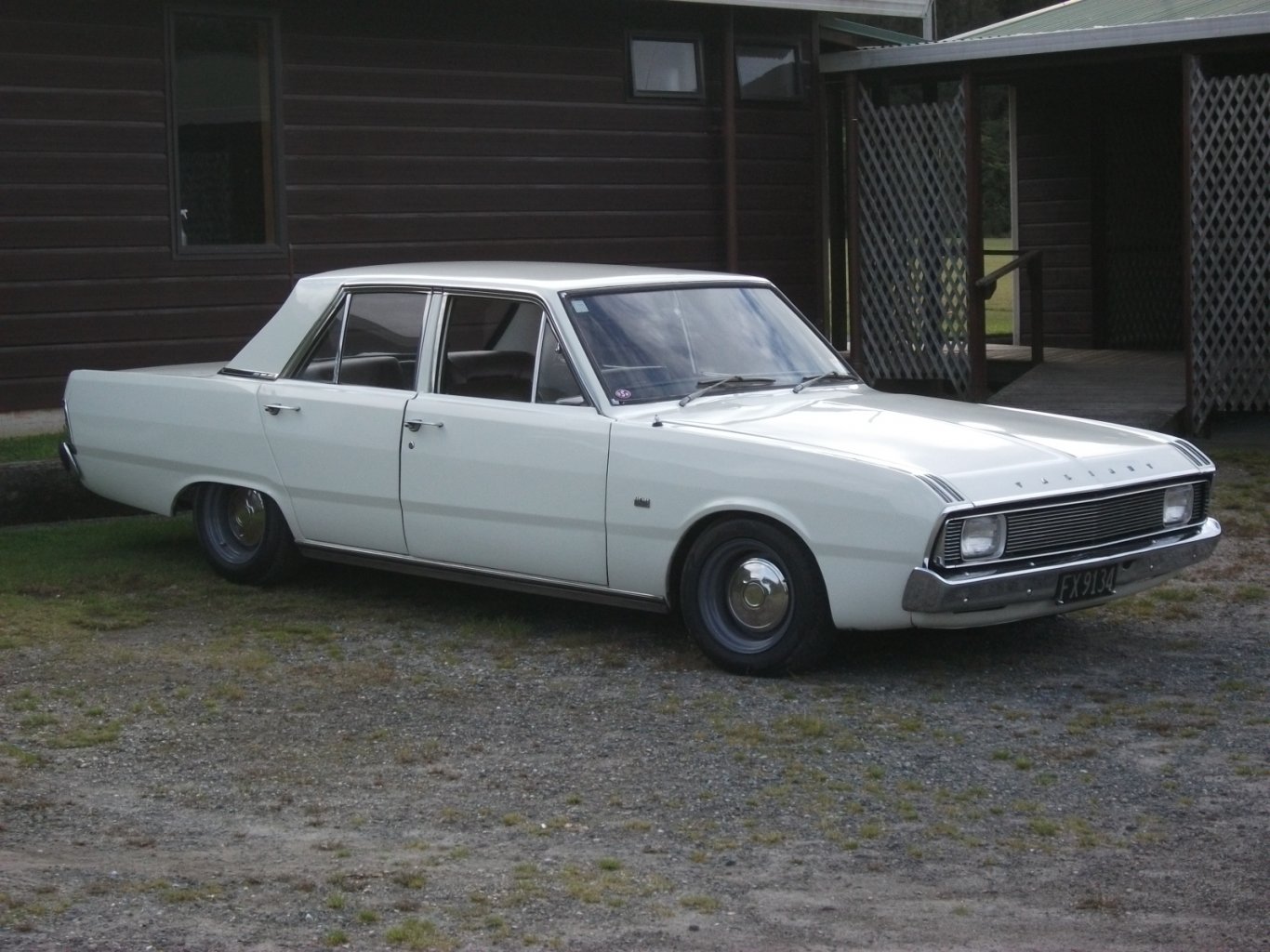

cletus Posted June 2, 2018 Author Posted June 2, 2018 then some slightly narrower tyres on the front, wheels painted black, hubcaps 6 Quote

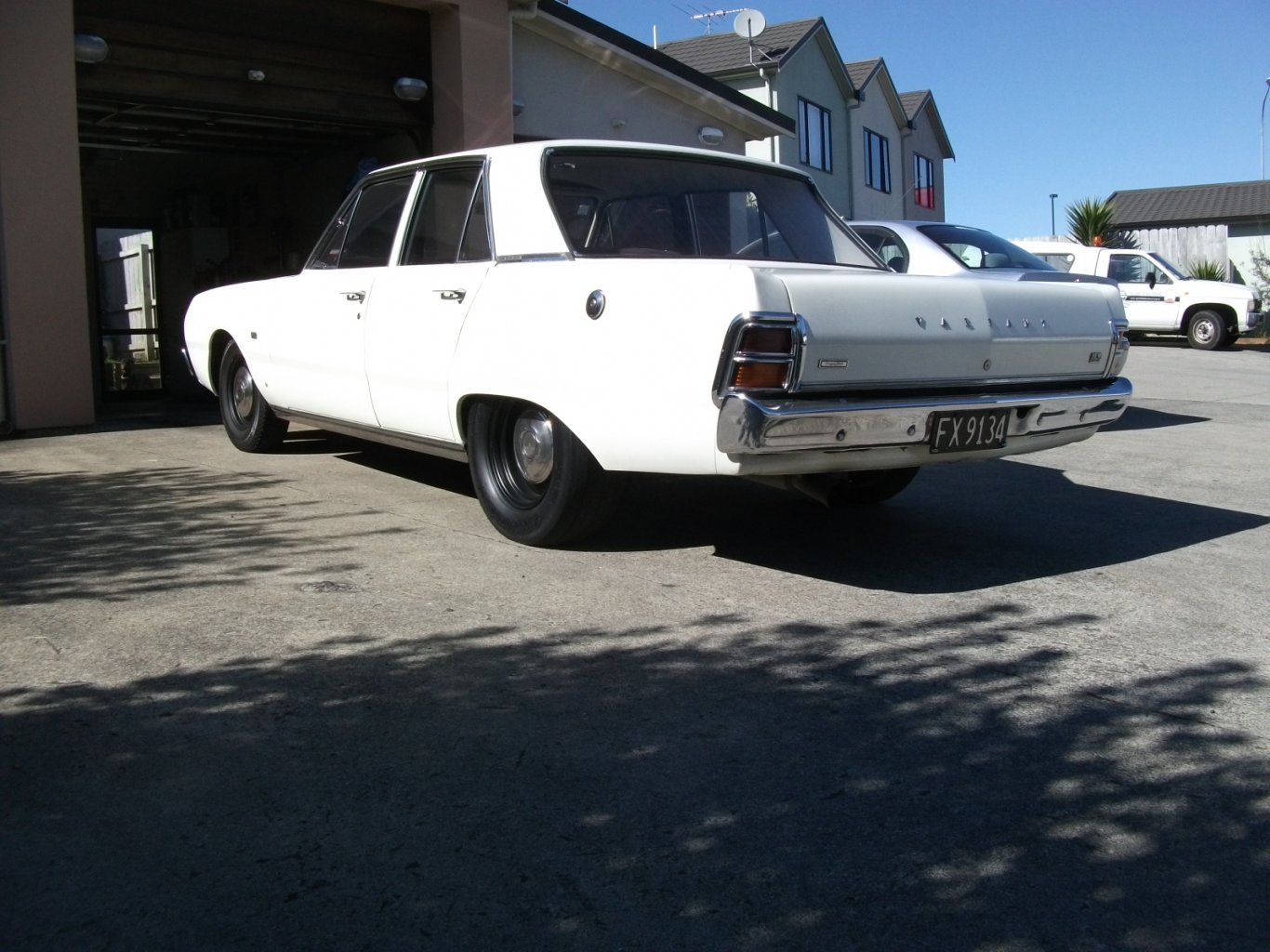

cletus Posted June 2, 2018 Author Posted June 2, 2018 then had some standard rims widened, 195/60 front and 205/60 rear, painted them grey to start with and had hubcaps, later powdercoated black and ran no hubcaps with bullet nuts 5 Quote

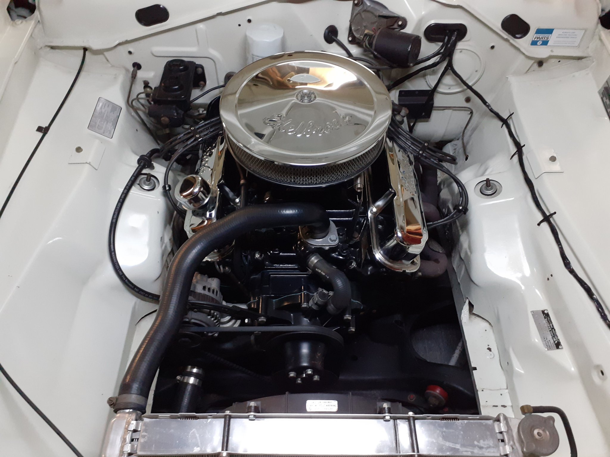

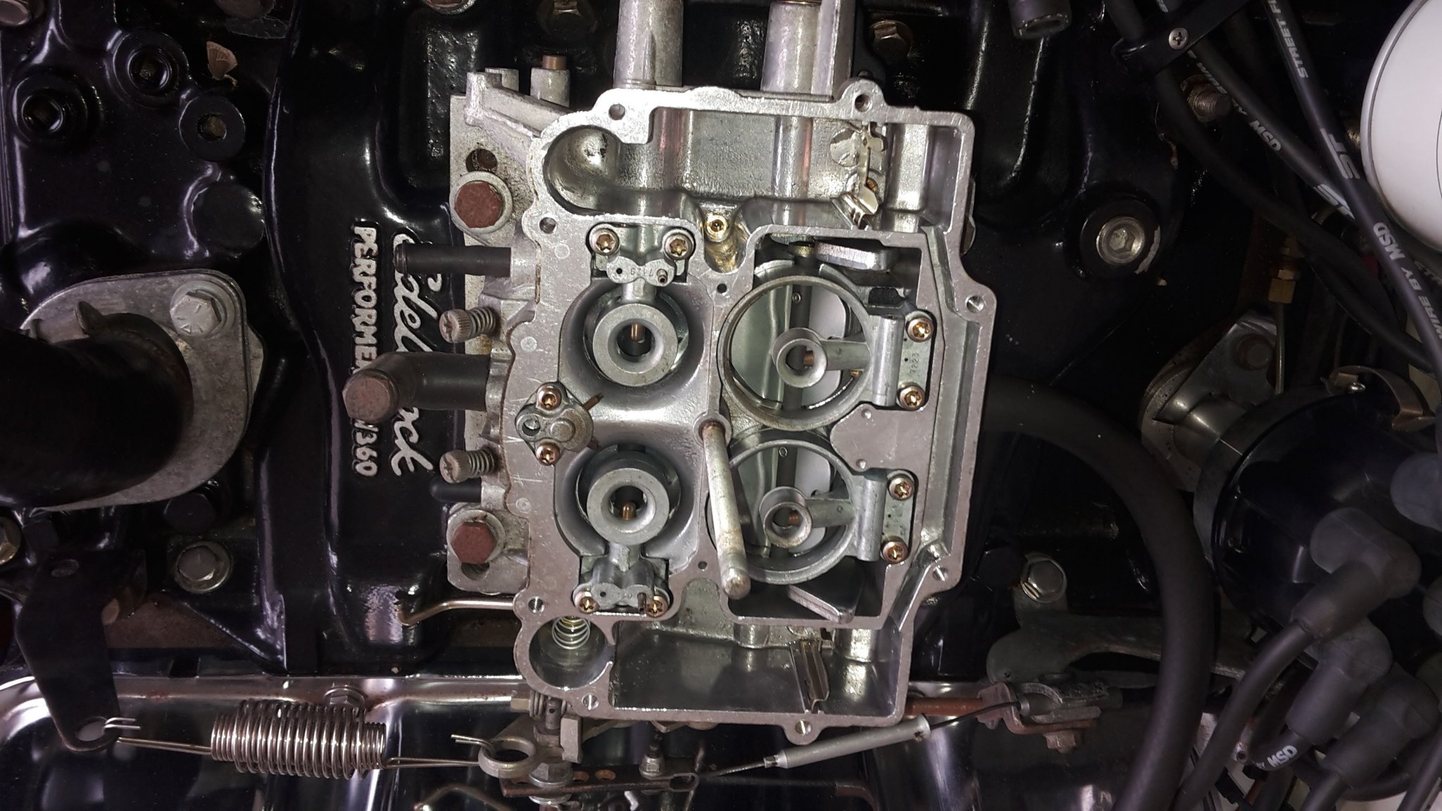

cletus Posted November 3, 2018 Author Posted November 3, 2018 Tuning time I went to Tauranga in it a few weeks ago and I figured out the fuel consumption at 15.6l/100km. Which is a bit dumb. It hasn't bothered me in the past but since gas is getting spendy I think there's no point wasting it. I've suspected it was a bit on the rich side as its never needed a choke and it runs good when it's cold. I put a wide band on it and it was a bit all over the place but averaged 13.5-14 afr when sitting at 100kph. Did some googling on tuning edelbrock carbs and found this 2 Quote
Popular Post cletus Posted November 3, 2018 Author Popular Post Posted November 3, 2018 So that got me confused cause I didn't know what the heck that means. Thought about putting a holley on it cause I know how they work but then found the manual and figured out how the chart works it's actually quite simple once you have the list that is on the next page which wasn't on the internet Edelbrock carbs have a primary system which has a jet, with a rod that goes in and out, controlled by vacuum . So you pick a combo of jets and needles based on where in the chart you want to be. 14 Quote
cletus Posted November 3, 2018 Author Posted November 3, 2018 Ended up at position 11 on the chart, tried 10 but that had a part throttle hesitation. 11 is a smaller (.083 instead of .086) jet and the standard rods. Put the wide band on today and went for a drive, seems pretty good, runs well, cruise afr is mid to high 15 now. Also put a bigger needle and seat in while the carb was apart, I suspect it has a fuel flow issue which only ever happens at the drags so I'll see if that helps 7 Quote
Popular Post cletus Posted December 13, 2018 Author Popular Post Posted December 13, 2018 Well the fuel usage is better. Worked out to be 13.8l/100km now. Also it ran it's best time at the drags with this engine, 14.2@94mph It still has a problem which only shows up at the drags, which i avoided by shifting at 5k. If i rev it any harder it gets the splutters . I thought it was fuel supply issues but now I think the lifters are pumping up . When I put it together the block was decked 40 thou plus the heads had a little skim. I took a punt on the stock pushrods still working, but they are longer than ideal. I would also like to get a distributor with a vac advance back on it to help with economy some more Here's a pic of a skid I stole from the drag day thread, just so I'm not a boring fuel efficiency nerd 29 Quote
Popular Post cletus Posted December 5, 2019 Author Popular Post Posted December 5, 2019 Ha Left it till the last minute before drag day, finally got around to getting some 50 thou shorter pushrods 5 years later. Put them in tonight but a bit late for road testing and waking up all the neighbors, but it did start, and didn't rattle Also rock auto to the rescue again, got a distributor with a vac advance so in another 5 years I might get around to putting it in 25 Quote

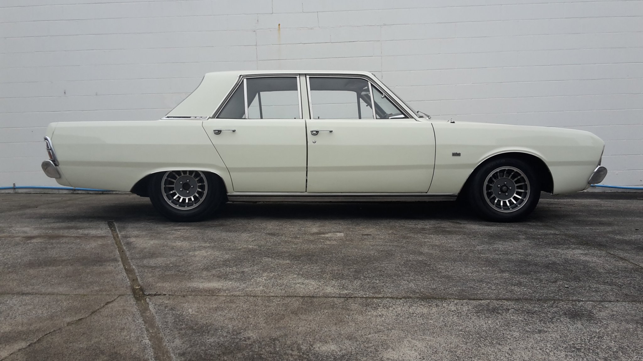

Popular Post cletus Posted October 29, 2022 Author Popular Post Posted October 29, 2022 Green car is out for a while to get certed so I thought I'd make the most of having some room in the garage, and do a bit of maintenance on this thing so it can get a wof New tyres, a quick polish of tridens and bolt those back on, adjust the brakes, grease balljoints etc, and a couple of little fixes I wanted to raise it a little bit as the roads are so chooched and there are speed bumps growing everywhere so I changed to a 205-70-14 on the front and a 215-70-14 on the back. They are pretty balloon spec, that plus a turn and a half on the torsion bars, plus a pair of more progressive shaped bump stops, it drives much differently now, it's quite a lot more comfortable. I ordered a windscreen rubber and filler strip a few weeks back and surprise @Valiant hemi performance didn't actually have the parts in stock so it's on back order 16 Quote

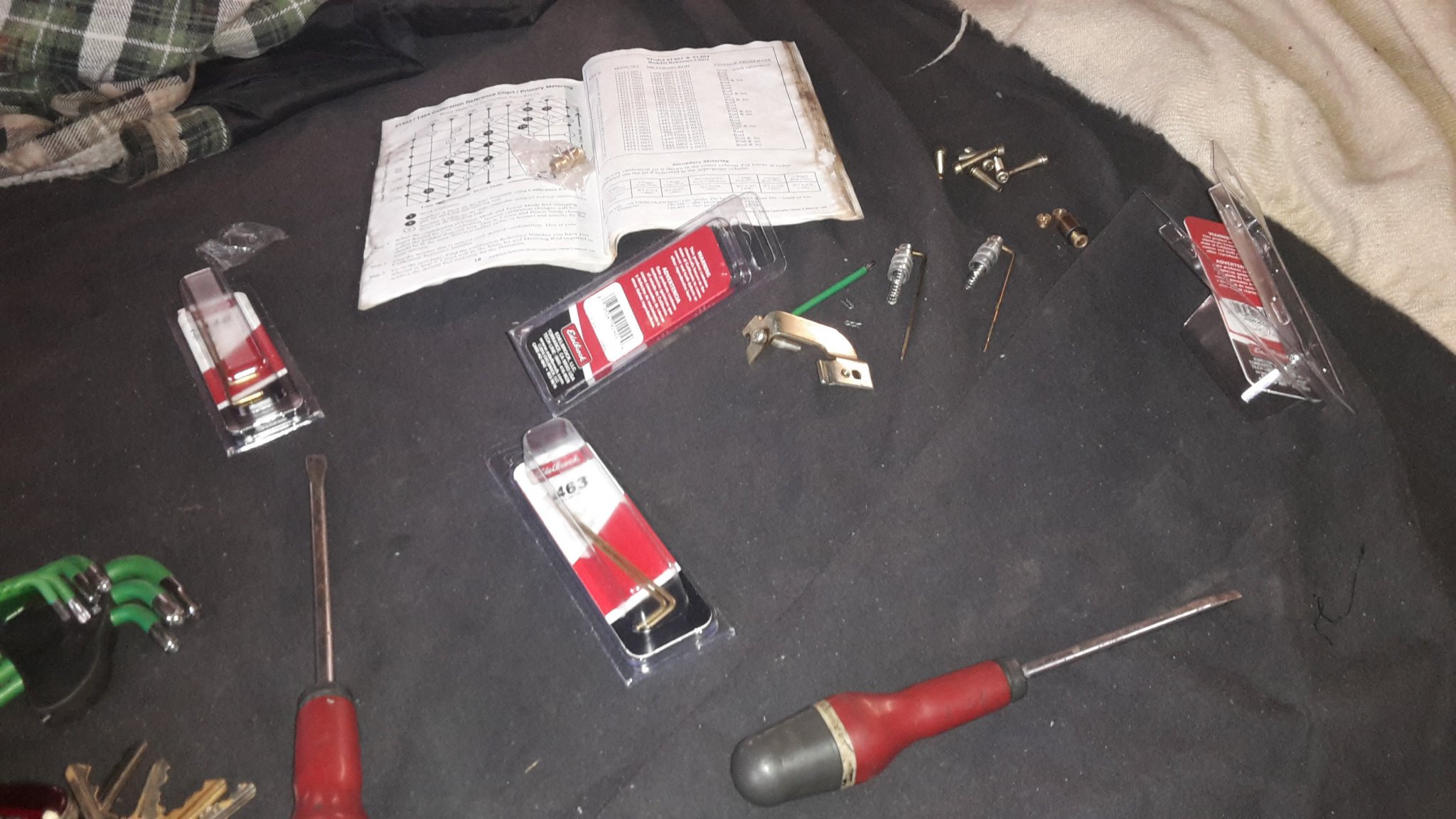

Popular Post cletus Posted October 29, 2022 Author Popular Post Posted October 29, 2022 Bunnings bumpstops. 40 dia at the bottom, 30 tall rubber. 8mm stud I've used them on a few different things now, they are reasonably soft so they work quite progressively And they are $13 each so pretty cheap 33 1 Quote
