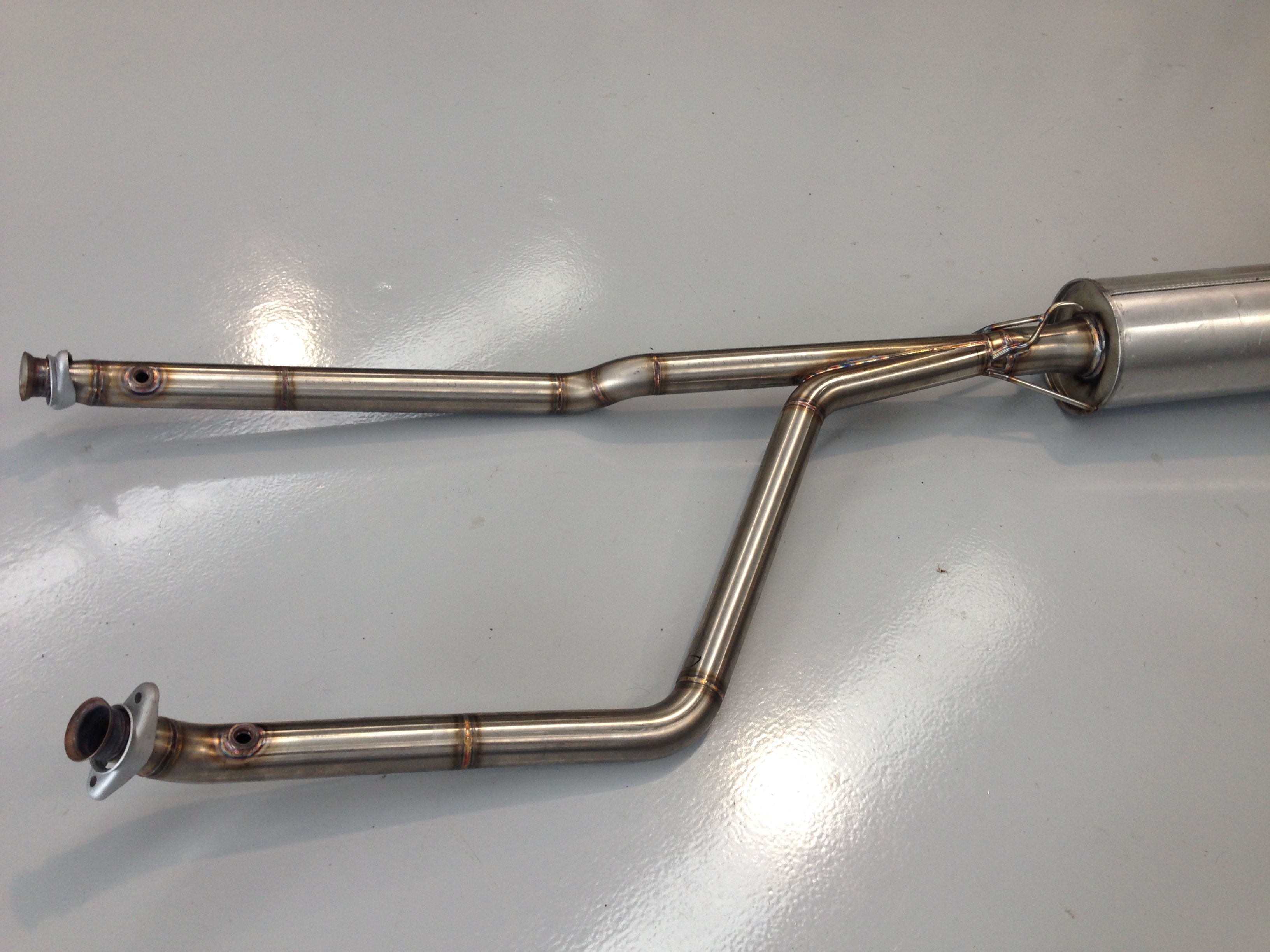

Time has been marching on, and I haven't touched the van for ages, as I have been so busy with other things.So I decided to book it in at work, as we have a new fabricator just started, and he is rather good! First job was to make the trans mount, and exhaust system. The trans crossmember is a tubular design, from 1 3/4" roll cage tubing. The exhaust is TIG welded 304 stainless, 2" primaries into 3" main pipe, and large muffler with side exit pipe. Next week will be a new engine crossmember and mounts, to a similar tubular design as the trans mount. Also a swirl pot for the fuel injection, weld in the battery tray on the RH side, wiring, fuel lines, air intake, etc.- 21 replies

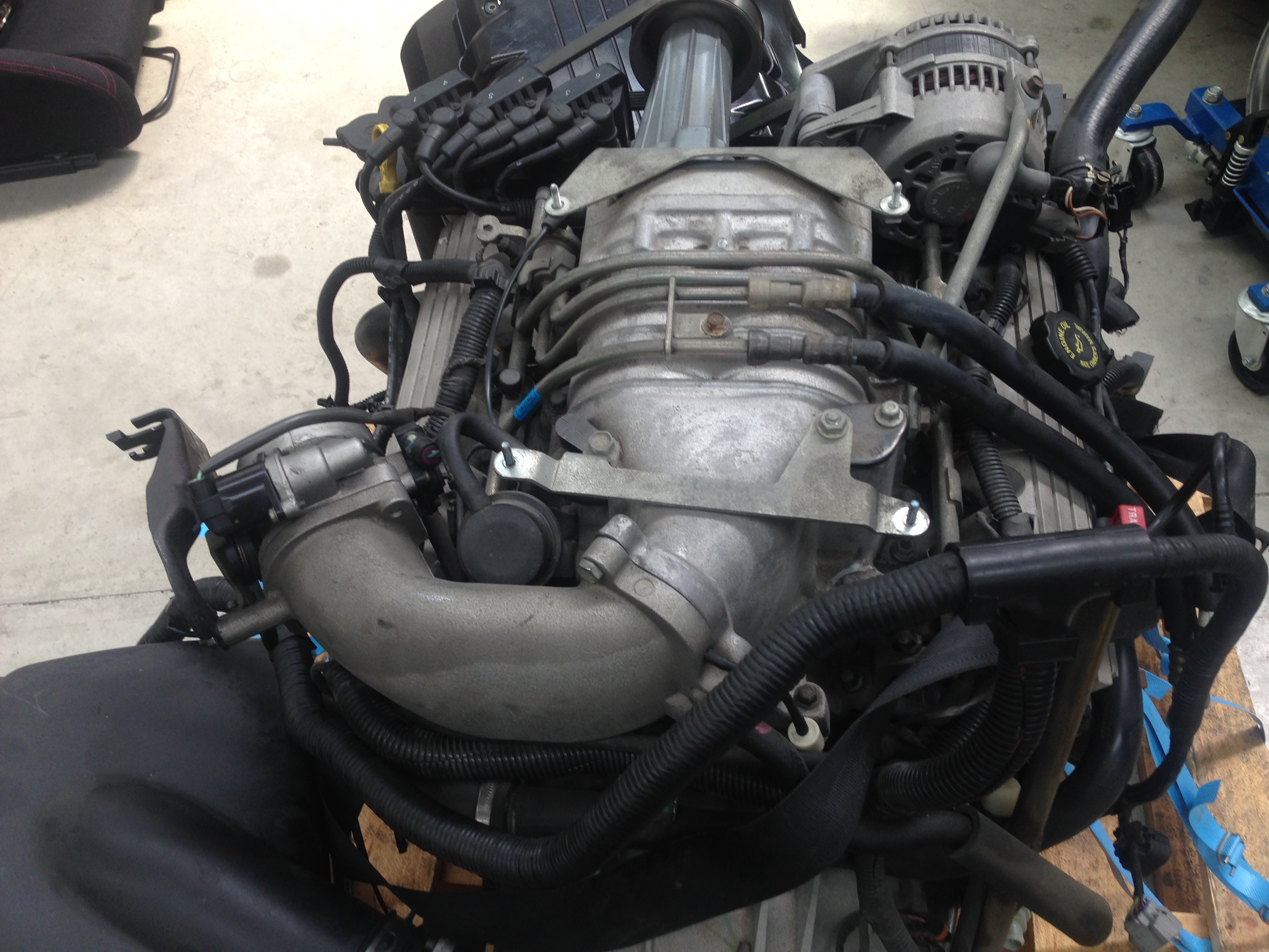

pulled the lid off to have a closer look. Here you can see the Eaton M90 supercharger, with throttle intake at the rear. These engines did not run an intercooler, although aftermarket ones are available. Looks like clearance to the throttle body will be tight, otherwise everywhere else looks easy -
