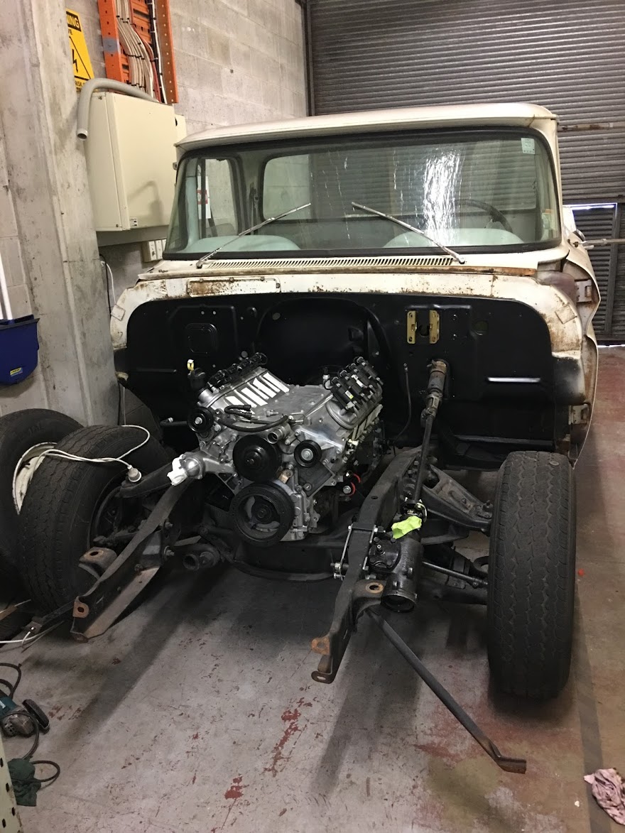

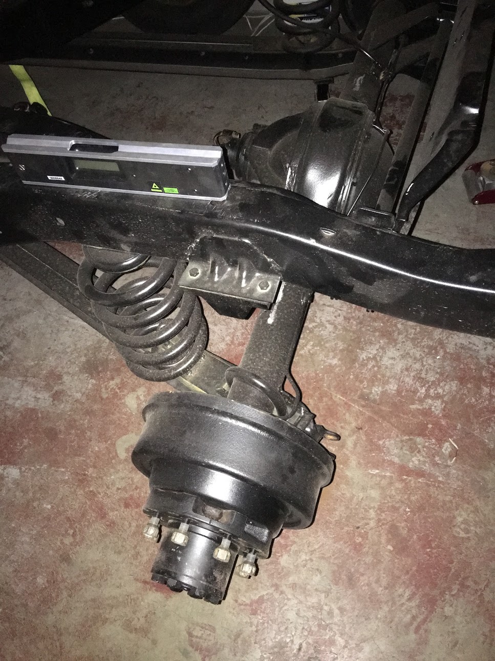

  4. Turned left after doing a bit more reading. Made front mounts and a trans mount. Assuming I have all my measurements right, its in the middle, and I have about 1.3 degrees slope on the 1st section of driveshaft which is where it needs to be according to the interweb. Im swapping the rear end to a 12 bolt, so I can set up the pinion angle. Been pretty productive really ! All just tacked together at the moment. Everything is just sitting there in the photos, need to drill a few holes and bolt it all up. not 100% happy with the trans effort and may rejig it a bit yet.

  6. Made some progress. Engine/tranny will fit without changing the front end, so Im not changing it. Cut a notch in the crossmember to get the box in the hole. This truck was a manual so has the high hump trans tunnel, so no cab modifications required. Rear output from the trans is about 4" further back than the original. Did a bit more research, and I will chop out the entire crossmember as it isnt needed, and I think I need to get the trans output down from where it is. Its all just a mock up, hence the 1" sq thinwall spacer under the perch, but it looks like this will work, unless there is a reason why I shouldnt. The perch is out of a 77, and they are roughly 30mm deeper in the chassis rail, so spacer. The chances of finding a 62 perch is virtually nil, not many of these trucks were ordered with autos, and all the manuals use a horseshoe mount at the front of the engine and another mount at the rear of the bellhousing, no perches. The tranny mount in the photo is the original holden one, should be straight forward to adapt that to the frame with a bit of angle and some gussets. If anyone has anything to offer in the way of driveline geometry advice that would be cool. Ive been playing with transaxle based shit for toooo long, and Im an old dog to boot, cant train etc. Driveshaft is a two piece, so its set from the centre bearing to the rear axle, and I really shouldve got a measurement on the output of the old box before removal... duh...

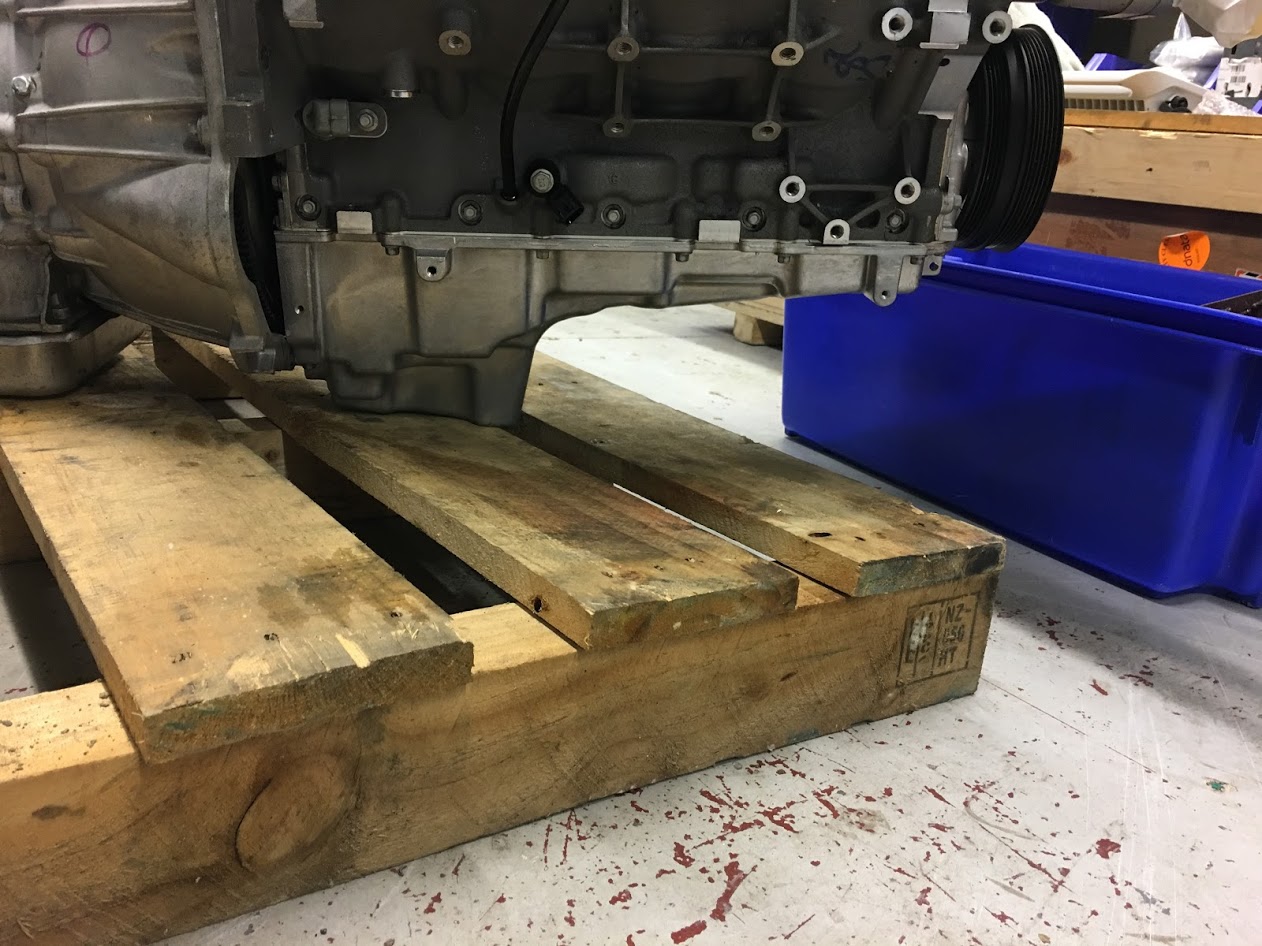

  7. So pulled the front end off and engine and box out over the weekend. Gearbox/driveshaft fought me for a couple of hours before admitting defeat at the hands of a bigger hammer. Have taken all the extraneous crap off the LS and changed the sump so it will clear the crossmember, will need to hang the AC compressor and the alternator off the heads, rather than off the base of the block they are in the Holdons. Pretty much every conversion I have managed to find, the torsion bar front end has been pulled in favour of a later model, basically the crossmember the torsion bars attach to is in the way. Im going to test fit before the front end swap happens, Id really like to keep it how it is... Also have obtained a 12 bolt rear end, this is off to be rebuilt and an eaton posi chucked in it because 11's. I will be doing the bulk of the conversion myself, the front end swap (if I have too) is basically a bolt in barring one mounting hole. The front end I have is out of a 77, and fortunately it is a front cut so lots of measuring to get the steering geometry right. What I do need is someone to do the welding on trans crossmember, once I get to that point. Any suggestions would be great, also at what point should I get a certifier involved, Im not cutting it up, rear diff is a bolt in, may go to a one piece drive shaft... etc... If anyone wants the old exhaust, come and get it, no holes, not rusty, but I chopped it in half to get it out
