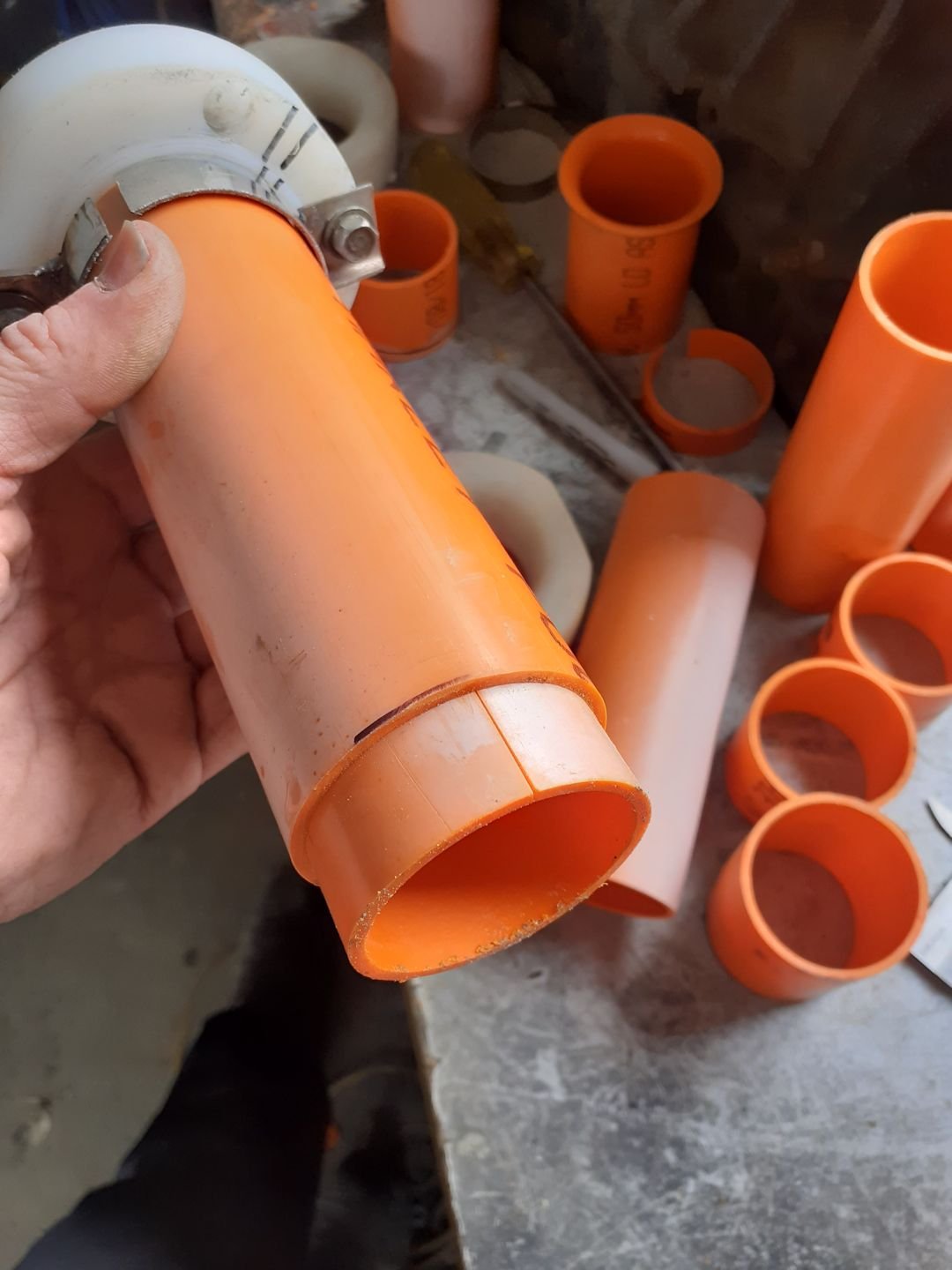

  13. Have done some butchery with some more power duct. This is same as one of the ones in last test (51m id). but ive cut a section out of some more pvc and slid it inside. making 46mm runner, will slide a second one inside make 41mm. just need to acquire some more to cut up
