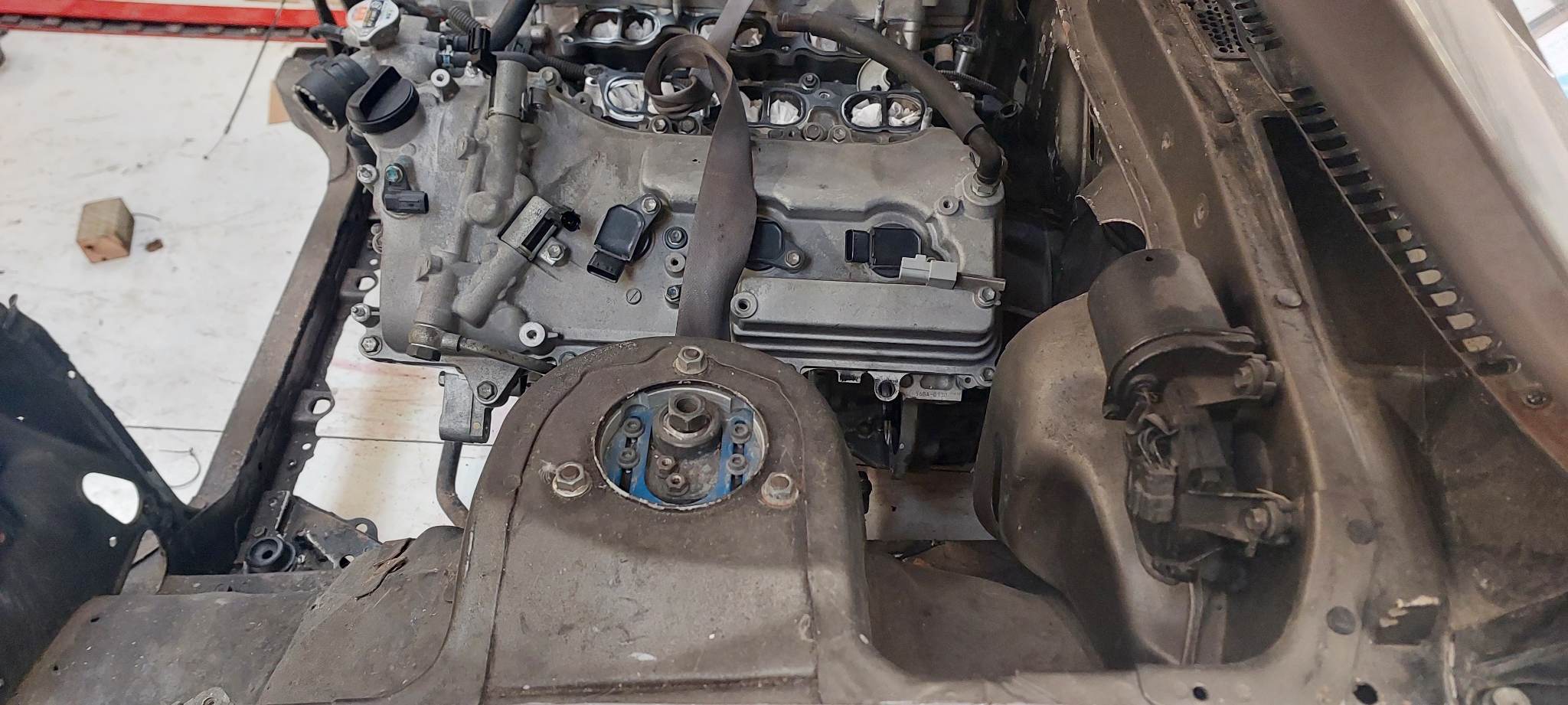

With the sump off everything's a piece of cake! Just slides in from the front, easy as. I can still push the motor a fair bit back , should be able to get the centerline of the first cylinder fairly close to being in line with the struts. (on this bank at least) So that should help the weight distribution a bit. So, that's good news. There's also some fairly decent looking clearance to the bonnet line as well. There's a decent amount of room for a front bowl type oil pan on the front. So will make some engine mounts, get it in the right place then start drawing up a sump.

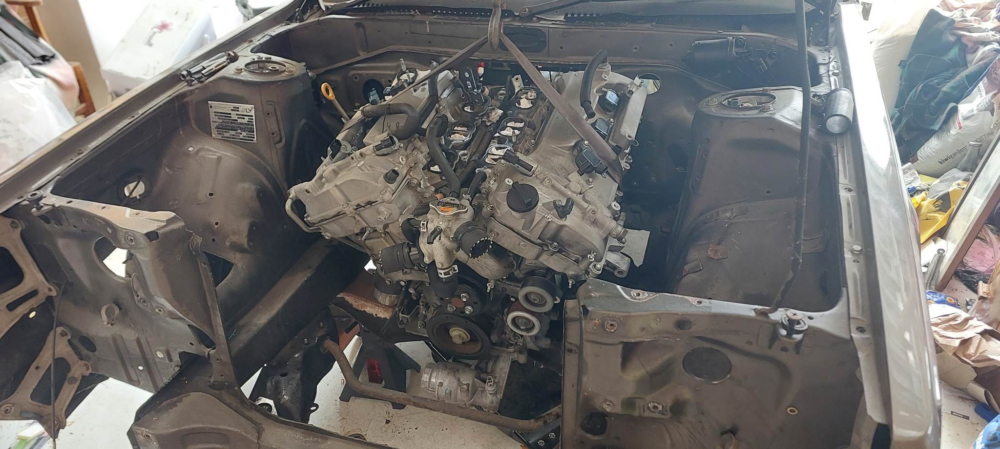

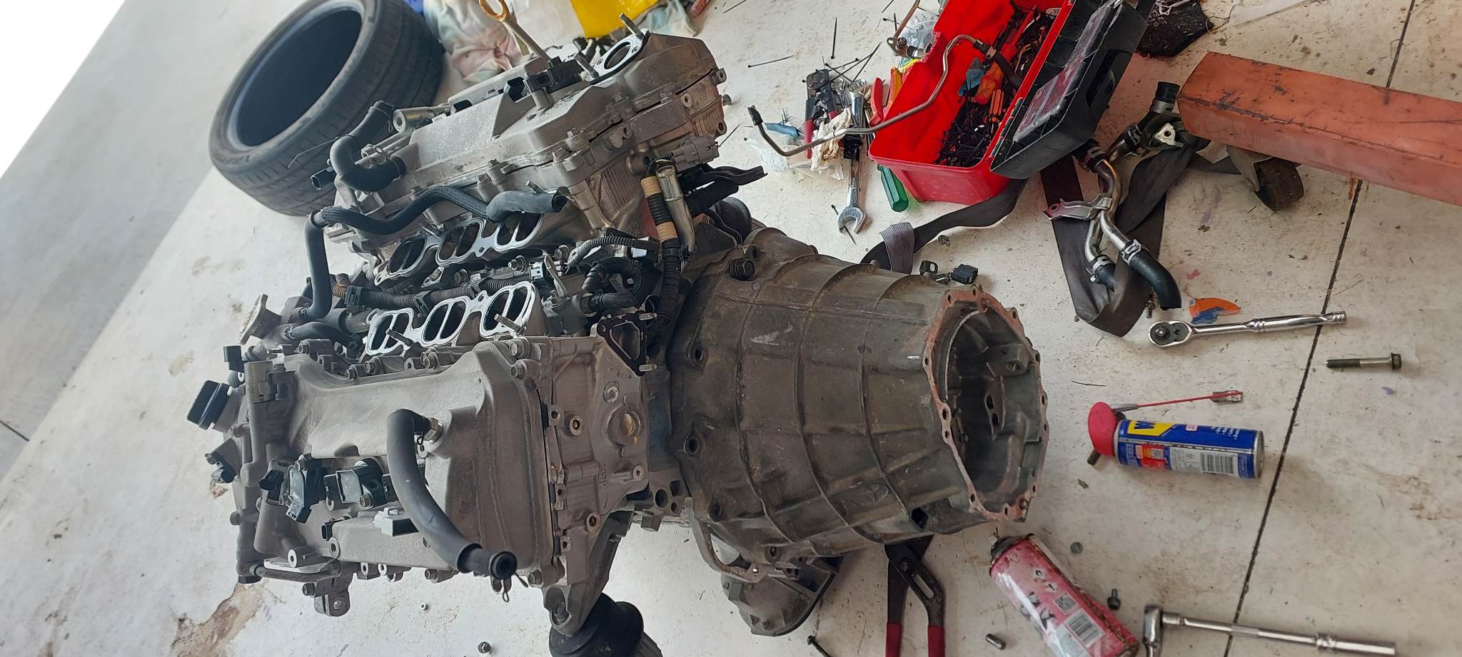

Disregarding gearbox issues for the moment. Because there's no point fretting over fitting a gearbox, if the motor wont fit anyway. I moved the car and got the old motor out, and did a test fit. Did some chop chop of the firewall after this photo to make one of the banks fit. But then with a gearbox on it's basically impossible to get the motor in because of the rear sump. It cant get past the engine mounts or the steering column, which is a pain. So I batted with it for ages, ended up cutting engine mounts off, dropping steering rack, then even dropping the crossmember to see if I could get it to fit that way. But still not working. As the gearbox wants to hit into the tapered part of the tunnel before the motor is far enough back for the oil filter thingy to clear the swaybar, and the sump to fit behind the crossmember. It just wont fit. So finished the day thinking it's probably a bit too big to work. But, after some sleep and thinking about it. I dont have an engine problem, I've got a sump problem. It's the stupid rear sump that is tripping me up, not the rest of it. So rather than chopping more tunnel and firewall I'm gonna take the sump off then see how we are looking. Chopping and changing to a front sump is probably going to be the way to go. Thankfully this motor is really designed with a front sump in mind anyway. The 2GR motor has the sump at the front, but doesnt necessarily fit this engine - and it wont necessarily clear anything anyway. This is what the sump currently looks like. Is there a Briscoes sale on sumps? Because there's about to be 50% off

Rear sump is the current headache. The sump cant get past the steering column. So, I dropped the rack down. Cant get past engine mounts. so chopped those off. Cant sit far enough back so chopped part of the firewall so one of the banks could sit further back. The bellhousing hits the tunnel before the motor is far enough back to drop down past the steering rack. Even when I dropped the crossmember and rack, I still cant get it to fit. " I tried the Hyperblade trick of flipping the crossmember around, but the bolts for the crossmember arent on the centreline of the lower arms, so it doesnt work. It might work if I chop some of the tunnel out, where it's hitting the gearbox. But its not going to be an easy motor to get in and out. If I do persist with chopping more stuff out, it does look like it will sit fairly decently low and fair back though. Good room for intake activites. Exhaust manifolds should have plenty of room, dont think the steering column will make life too difficult. But that's enough for one day.

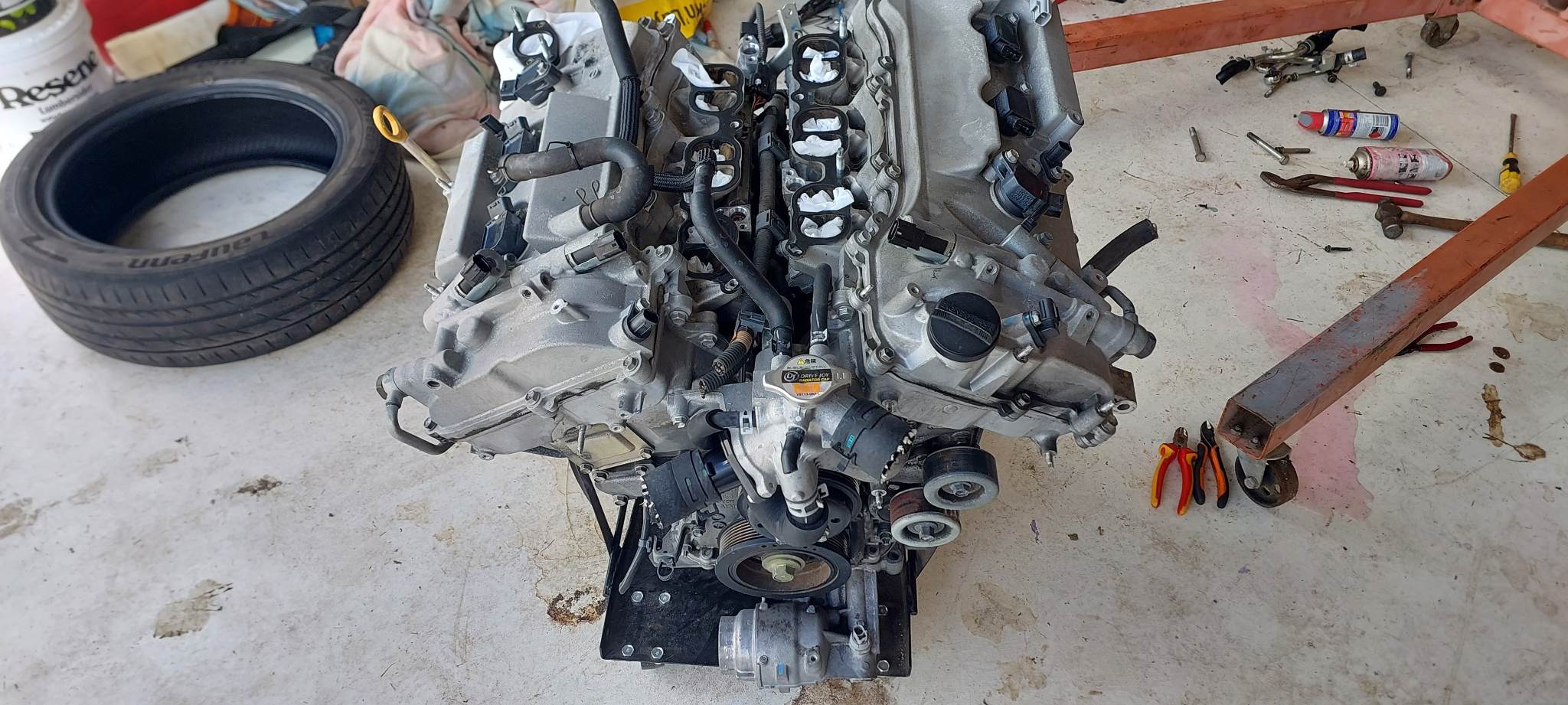

Got this home and stripped a bunch of junk off it. And jesus jibbly christ it is MONSTROUS. Here is a 1NZ cam cover compared to 4GR to show size. I thought being a V6 it would be a fair bit shorter than beams motor. But looks like it might be even longer. To be fair a lot of the front of the motor is just empty spacing holding the timing chain etc, so the centre of mass is further back than it visually appears. However there are some other issues. My engine bay tips in at the middle a bit to accomodate the motor sitting back. But it does not do this where you need to fit a Vee motor. So to get this in a position that will fit the rear sump, it looks like it'll need to choppy chop heaps of this out. Which is even more troublesome on the other side, as that's where the brake booster etc wants to live. If I try put the motor further forward instead, I dont think the rear mount sump is going to fit past the crossmember. The whole motor is just way way bigger than I was anticipating hahaha. Here's a pic of the 3S bellhousing placed up against the motor. It looks like the east-west 2GR motors do have the 3S bellhousing pattern, but they totally changed it for the north/south motors which is annoying. So at this stage, pretty disheartened. This thing is honestly monstrous and feels really heavy too. I dont want to have to chop a massive amount of my car out to make it fit. The difference in overall size from 2 litre beams motor, to 2.5 motor for this is insane. I guess that makes sense when considering the block size is essentially for a 3.5 litre motor instead. What to do from here? Dunno. Need some time to think about it. Not so confident it's the right choice anymore. However I think I'll at least try get it sitting in the engine bay and see how it looks. If it can physically fit okay, will perhaps try persist with solving the other issues. But I dont think I'm gonna "hand drill engine block" my way out of this one.
