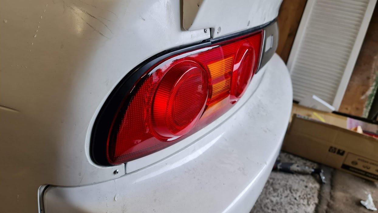

Found that the wiring for the brake lights on the original style brake lights are the same inside so used some from a damaged set. Removed the plug from the preface lift type lights and soldered/shrink wrapped: Yay, working type-x lights, the photo came out really dull/washed out but in real life they are a nice vibrant dark red: Sacrificial brake lights, cracked and chipped etc, in the bin:

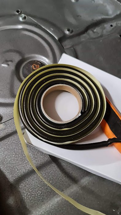

Fitted lights: Car is filthy: Sooo much nicer: Did it properly with this stuff: Here is what the cracks in the st215 injectors look like: No update on the engine, except that it should be getting over bored at some stage soon based on the piston specs. Still a shame to hide these away, look at them! Have to wire the lights in since they changed the plug type and even the wire gauge on the later 180sx.

I hadnt thought of checking reisistance, thanks for the idea. It'll be interesting to see if there is a difference but eitherway I won't be using the ones with the cracks. Will take a photo when I get them back. I haven't yet bought new ones but think I will get them flow tested before using them. In other news it was my birthday the other day and months ago I had ordered some genuine Type X rear lights. I'd put it off for years since they are pretty expensive. Bit better buying direct from Japan but the shipping was still pretty bad. They arrived a while ago but decided to keep them until my birthday to semi justify buying them to the wife lol. Anyway, here's one in a box. Feels kind of silly since the car has no engine in it now.
