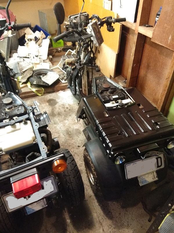

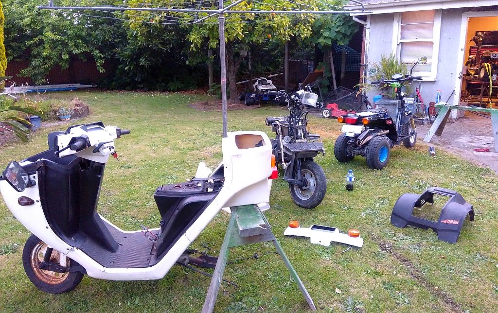

Looks really silly with the wheelbarrow spec wheels now! Am trying to track down a nasty vibration, changing wheels helped a LOT but I think there's something off balance in the CVT area buzzing a bit. Am carefully stripping all the plastics and stuff back off to get the step/floor into the painters ASAP as I have yet again ended up with a 2 week dead line to get it finished again, but this time I have got 2 to sort out as I've taken on fixing up another one "Yeah mate, there still good engines, just need to clean the kick start parts and put a belt on it" Besides everything being filthy and any bearings that aren't seized are dry and noisy sounding it all looks like it is in perfect condition, so that's a plus! I'm pretty sure I ordered all the odd size bearings and seals that Honda used in these in my latest Japan order, so hopefully @Vintage Grumble can get hold of the others easy enough. -
