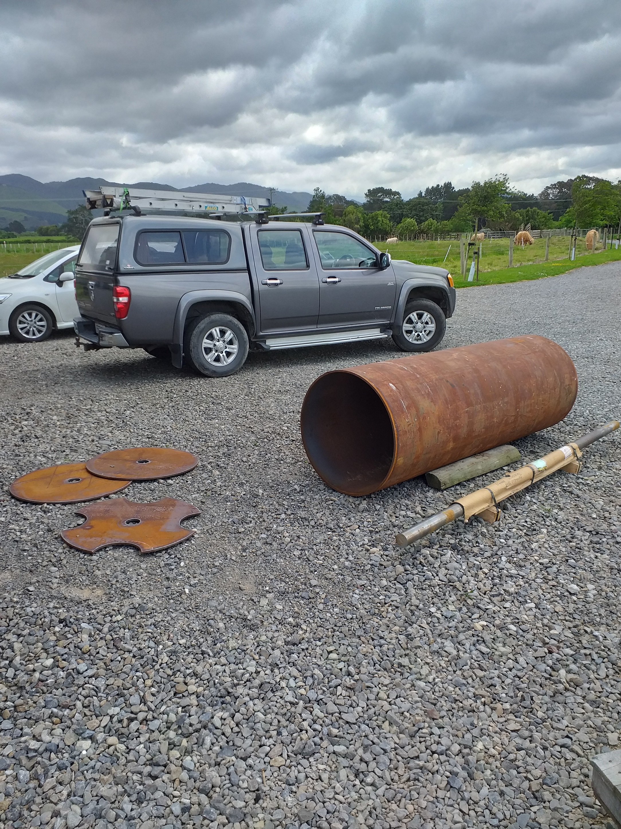

I then zapped the center cap in, followed by the end caps and shaft. - This took quite some fiddling to get it all as close to round as possible as well as getting the shaft as central as possible. With the roller sitting on it's bearings, I checked it all with a dial gauge near both ends and center, with the worst being almost 3mm out of round - which would give me 8.7mm or so minimum thickness after machining in a couple of small areas. Most of it was within 1.5mm, so I was happy enough with that.

I talked to Egmont industrial supply who I had bought my lathe off previously, because I remembered they had stock of large diameter pipe in various sizes. After telling them I was making a roller, they said they could also supply end plates and shaft to suit. Mint! Fast forward a few weeks and this lot showed up. 2.1m of 762mm x 12.7mm culvert pipe, end caps, center plate and 70mm shaft. The reason for the large roller is due to the RPM limit of the retarder as explained in my previous post. One benefit to this though, is better traction than small rollers due to the increased contact patch, which also reduces stress on the tyre. It turns out that culvert pipe is hugely out of round. But that's nothing that a couple of dodgy 20t bottle jacks and some wood can't fix though!
