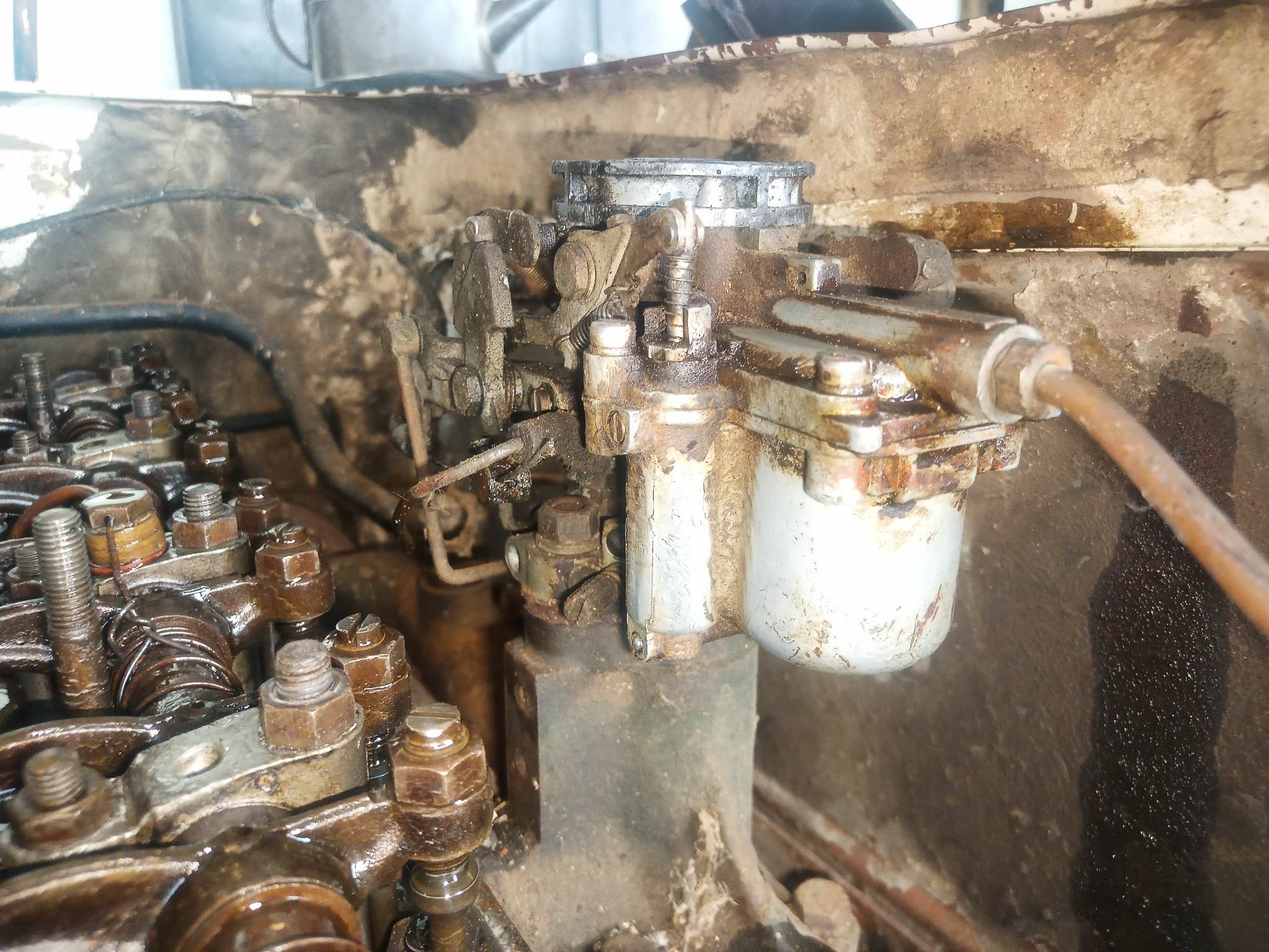

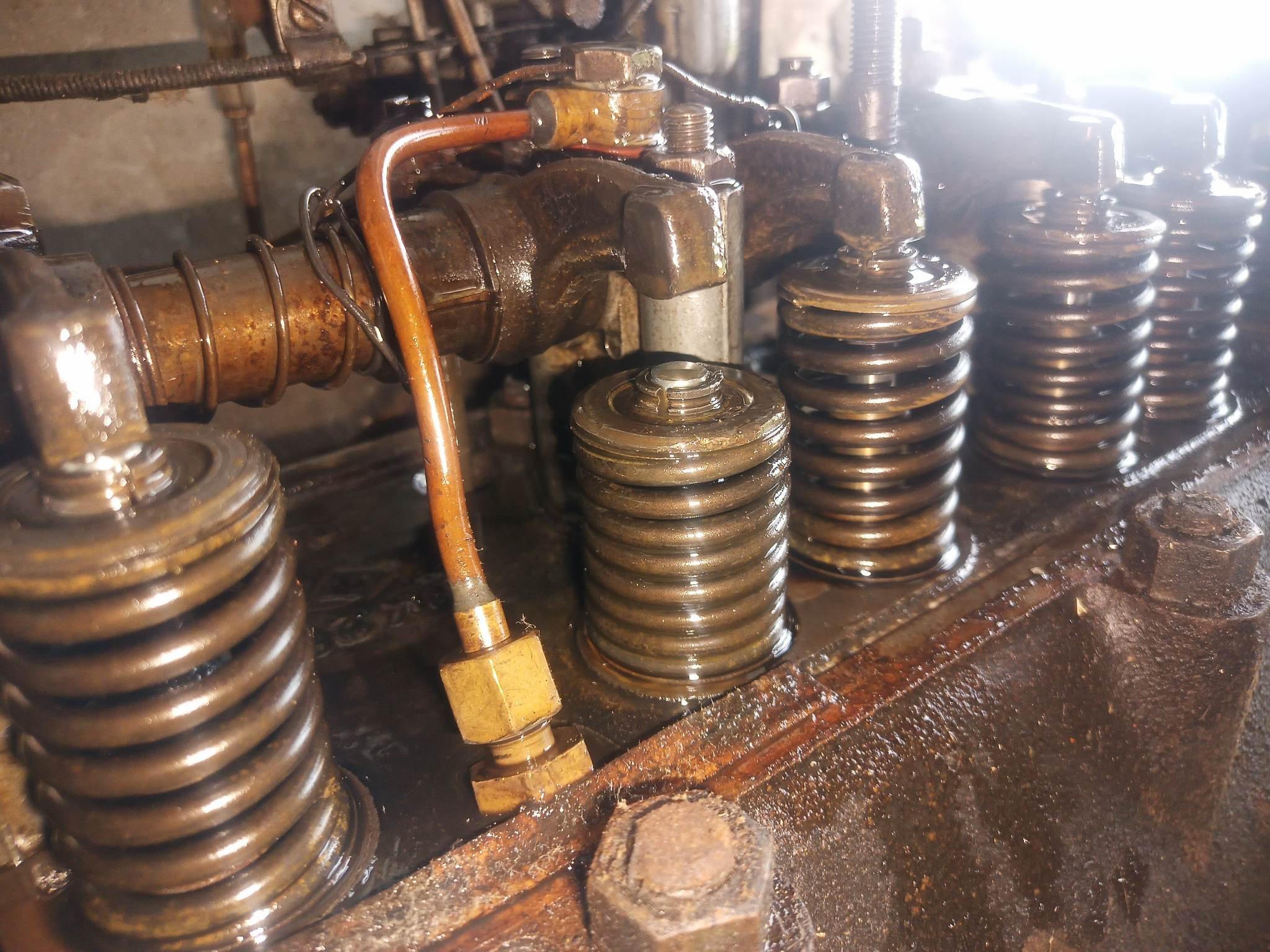

  9. The first three things on the list I need to sort: The carb is leaking and doesn't inspire confidence. I might look at replacing it with a new carter single barrel. The generator has a rooted bearing. Makes an awful noise. I was worried it was the water pump but that seems fine although it does need new rad hoses. As you can see here there is a stuck valve. I have soaked it with loads of oil last night and this morning. I'm reluctant to hit it with a hammer just yet.

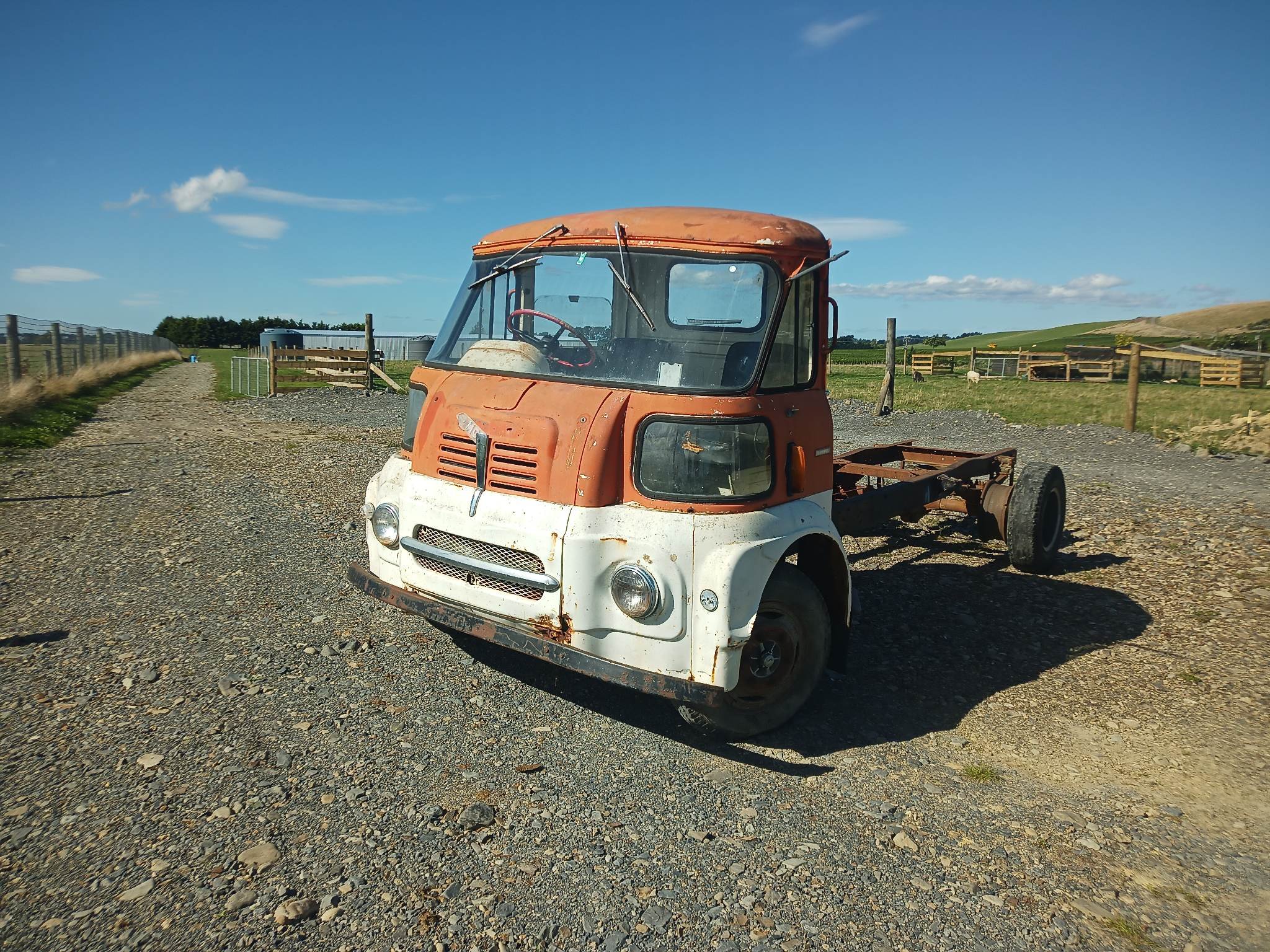

  10. With help from @cubastreet we managed to get this thing started. I have 5 billion other projects but with the Imp going into tinkering retirement I don't mind having this to play on. The plan will be to put it on farm rego to move between the quarry and my two properties. I have no idea what it can carry but if it can manage 3.5 tonnes I'll use it to cart my dozer around. If it can't, I'll put a tipping bed on it. I know from driving it, it feels like a truck. Zero suspension travel. One thing I have no idea about is how to get a truck back on the road having been out of rego. Although I do have a couple of shreds of evidence it was registered back in the day floating around the cab. I'd love to do a chassis swap and lower it but I can only imagine that would be an LVV nightmare. So I'll probably go the path of least resistance here.

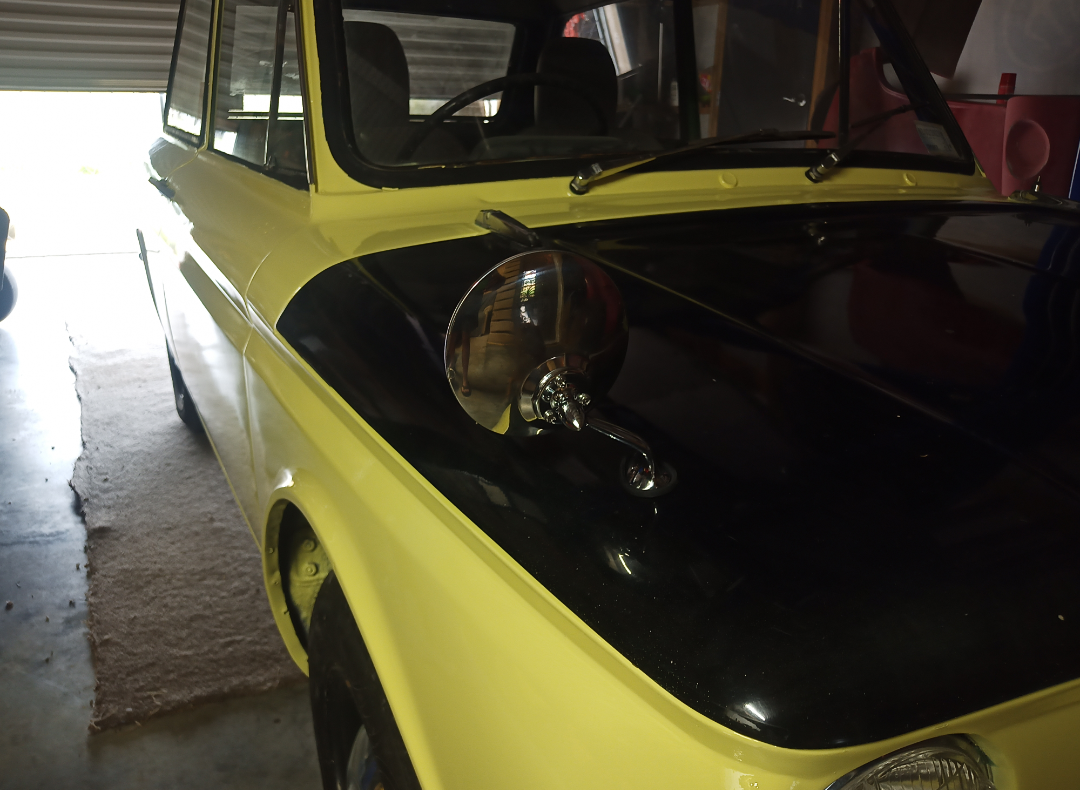

  20. A side mirror on the door means you're looking over your shoulder every time you see who is tailgating you this time. Took the opportunity to drill a hole in the bonnet for an easier glance behind me. Only problem in an Imp is that everybody looks like a truck running you down!
