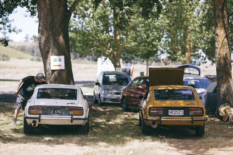

  9. Still not having a garage meant the car was still stored at my parents place, while I was living across town. The box of parts sat on the shelf gather dust, for that one day when I would be able to work on the car and have the space. I would make an effort at least once I month to get out for a weekend spin in the 240z. Also managed to get too Leadfoot in 2018 which was super rad. its nice turning up and get special treatment to park in the field closest to the entrance ahahah. A few photos I grabbed from the day:
