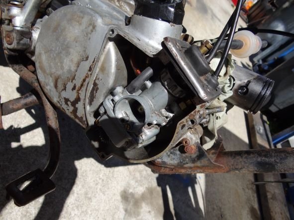

  1. No bull, it was mostly engine oil, I could smell concentrated fuel from the tank but this smelled like oil and but it was mixed with the unleaded varnish. I reckon because it's a rotary valve and the carb being so low the piston was causing a splash when it was going up the liner as it was scaping 90% of it off and that was when the the rotary valve would be open and feeding the crank case vacuum. I have pulled down and built up heaps of 2strokes and never have I had this, usually the left over fuel solidifies and this bike sat for over 10 years in an open shed until now. Honestly the carb throat was being flooded with oil and then having the needle lifted so high because someone had it about 15mm open probably because it was the only way it would run. Even the jets were like new from the oil.

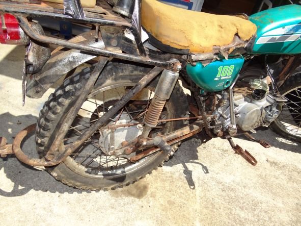

  2. NEW ADDITION 1974 Suzuki TC100 - described as not going for many years. It has been a farm bike all it's life and came with original black plate and ownership papers and had a cool 12k on the clock. Talking to the owner and he said the engine wore out so he put another piston in it and rode until it refused to start but was a bit smokey' I pulled the side cover off and removed the carb as thought i better check it and found it full of oil?, replace the fuel line as it was hard and brittle and added a filter to stop the rust and stuff in the tank blocking the carb. Kicked it over and oil kept going into the carb lean the bike over a little and oil ran out. checked oil level and was about right, plugs were wet and oil soaked. puled the exhaust off and about 100ml of oil in the exhaust. Even the Air filter crumbled as well so it needed some TLC. lifted the head and barrel and the rings are very worn and the piston wall was thick with oil. I have pulled down a lot of 2 strokes and I have never had this issue and honestly I have no idea how the heck it was even running before this. I am hoping that's all it is as someone had the carb adjusted to about 1/4 throttle and the clutch was adjusted and wasn't disengaging. Brakes work good. Bent handlebars, broken speedo, seized front forks and the auto-oiler isn't connected Ordered the engine bits I need and parked till they arrive, I will order a new seat cover and any other stuff once I have it running and then give it a clean and leave it like it is as I love the look of this 48 year old workhorse

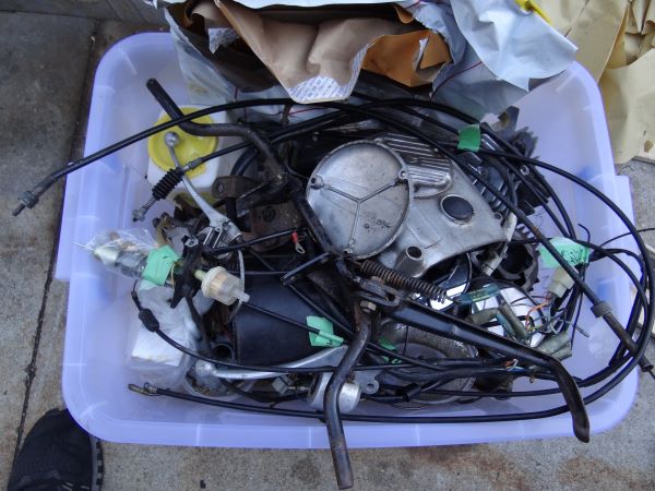

  15. So I took it out for about an hour or so to try and loosen up the engine as it was struggling to pull past 100 and barely got to 105 last time where it also created a fuel/carb issue and I thought I was going to have to call out for help but after running it on choke for a couple of ks it came ok, guess it was a small blockage. This time I had no issues and gave it a few blasts down the highway and around town. I then brought it home and made a small modification then took it down the highway and it pulled nicely to just over 100km/h in 4th then 5th tapped out at 120km/h, it may have been a fluke but from what I can gather the norm seems about 110 but I doubt I will try again as I would feel like a mug getting a speeding ticket on a GN250 as most people wouldn't believe me anyway.

  17. Start with some basics, needle/seat ok? vacuum leak? check brake booster hose, timing, take air cleaner off try, any fuel leaks?
