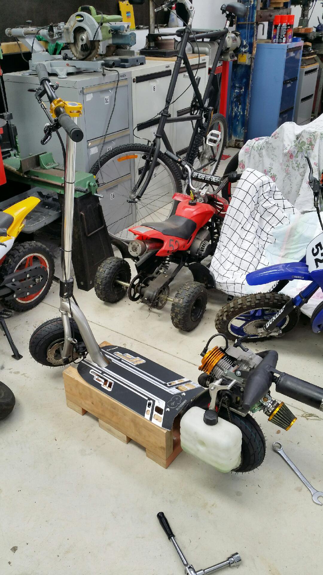

Small set back, I found a broken stud in the little G23LH motor. Luckily for me I brought a frame for spare parts a while back...by chance it had half an engine lower case stuck on the frame! Seriously what's the odds? It was in terrible shape. But using some trusty oven cleaner it scrubbed up okay. The bearings are fucked, as too are the oil/crank seals. I'll go to seal imports and get new ones. So with that setback sorted. I thought while it's apart...may as well port the fuck out of it! So I did: I always label my halves left and right. Plus draw the crankshaft rotation on as a reminder. The black is bad. That's about as dumbed down as it gets. So basically the blacks gotta go. It causes restrictions and ruins flow by creating eddies and turbulence. Note how badly the ports are mismatched...basically the air/fuel charge is hitting a wall! About 25% of the port is blocked by this sharp edge. So, to speed things up I'm using a milling machine to rough out some larger parts. Also I milled the skirt down on one side by about 2mm all the way around. Then it's time to rough out the rest with a burr in the dremel: Roughed out. Now time to tidy up a little. Below is a great before and after shot. Before. Note the sharp shelf and edges. Very bad for flow. After. All edges now flow and transfer ports opened up and port matched...much better. Finally. Here's a good side by side comparison of the cylinder. Look how much bigger the transfer ports are on the right hand (ported) cylinder...at least 50% if not more. That should flow way more air/fuel. The exhaust will get polished. The intake will be roughed up a little. But no real changes other than port matching the exhaust and intake will be needed as the specs for port timing are already very good. Only small wins could be made at the risk of ruining the motor. I'll replace the bearings and seals...slap it back together and it should be way better than before.
Yip! Sure is. It's not quite in tune yet, and I want to experiment with closing the hole down a bit on the pipes exit, as I think I'll make more back pressure and that could be beneficial? Here it is parked up with some of the fleet;) Sad thing is there's many more to come...
Yes...yes it is! Finished. 49cc of stupidly fast goped!!! It's slipping on the wheel a bit, as the wheel is worn-out and has become egg shaped. However that is genuine wheel spinning power your witnessing in that youtube clip. Seriously when in powerband it spins the rear wheel! Yeah buddy...it rips!!! Wheel spinning goodness. This hard tyre goped is awesome! Back to basics motorised fun!

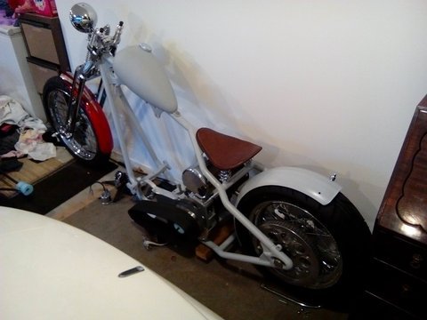

Then on to the starter motor. These big block motors take a fair bit of torque to turn them over. So I'm not going to fuck around...going straght for the big gun here! It's perfectly normal if this photo gives you an erection! As it's one fucking sexy chunk of billet aluminium. Test fit for clearance. It's a tight fit...but appears to fit without fouling on anything. So gotta be happy with that.

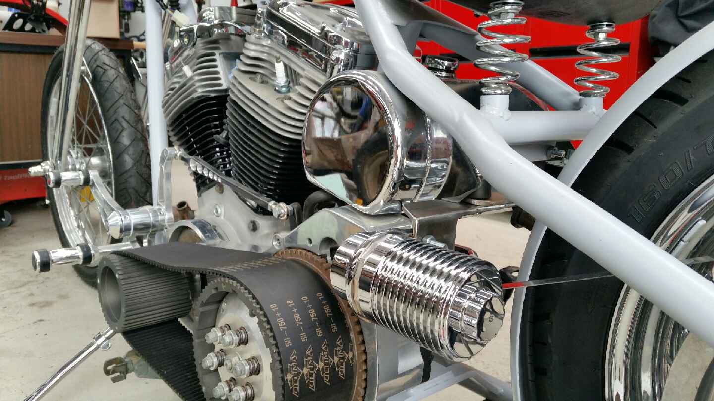

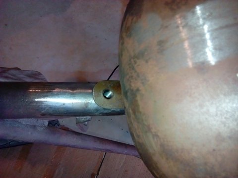

I'm using secondhand Vance and Hines exhausts off a soft tail. I'm no exhaust expert...but I don't think this cable tie is a long term solution? I need to remake these brackets, as my frame is longer than a soft tail (hence the cable tie for now). But luckily they're still making steel, so this should be achievable. The headers fit the big block motor just fine. I may need to cut the bottom pipe to eliminate it contacting the road - when I really lean it over into a corner. Hopefully I'm able to "tweak" the pipes up a bit without looking to stupid? That may buy me the ground clearance without having to cut them?

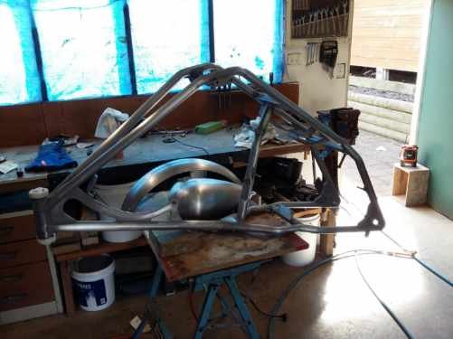

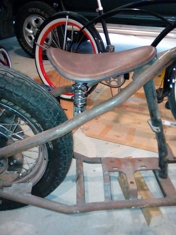

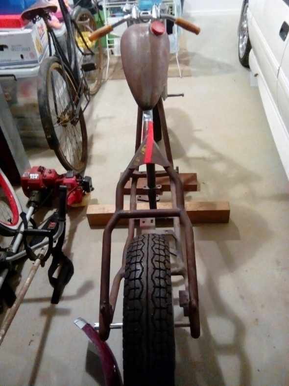

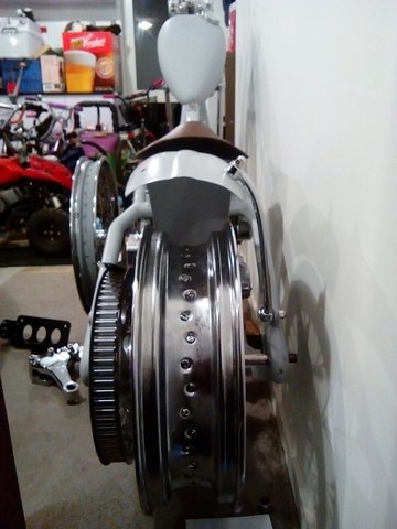

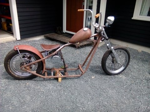

Found some old photos from about 4 years ago, when I started to make this thing. I totally loved this look..however I made it way to low. It was heartbreaking when I finally admitted that I'd fucked up my measurements and would have to redo it again to raise it up...balls!!! But after walking around in circles constantly saying "fuck...fuckity fuck, fuck, fuck!!!"...then I got over myself and excepted the situation for what it was and moved onto producing a solution. A bit of nip and tuck, then bare metal goodness...mmmmm...tasty. Etched and primed. Looking sexy! Same bike now 4 inches higher after a fuckload of changes made. I also had a custom wheel made for me which put my hub into a 17"rim. 17" had taller tyres than all other options in that width due to aspect ratios. When I did the maths on 16" & 18"...the 17" won. So there's a brief history lesson on how I got to this point now. Ups and downs...shit loads of time, effort and money...but I think it's been worth it.
A lazy 6 hours spent on it today. This is the version 1.3 attempt at getting this right. Yup 3 attempts to get it perfect. Doesn't look much...but often the best ideas don't. Anyway harleys have an oil filter in the front that's hard to empty without dumping oil all over the place and spilling it on you motor/frame etc. So I purchased a remote oil filter to relocate it to a better place. I also picked up a really nice Perf-form oil filter kit that uses disposable cartridges...and looks fucking cool too! Here it is mounted in place. It is just mocked up for test fit. I'll send it away for chrome later. As you can appreciate, there's no bonnet on a motorbike, so everything has to be perfect as it's all out there on display. There's a lot going on in this location, drive belt, oil tank, downtube, rear fender, primary drive belt etc... this oil filter has to clear all these things as well as look good. Hence why I made this bracket three times before getting it right. Fucken stoked with it!

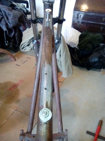

Kimjon replied to h4nd's topic in Other Projects
Yeah I reckon you're right too...but I'm making it for a mate who thinks otherwise. Guess I'll weld one on next week when he realises he's wrong:)
