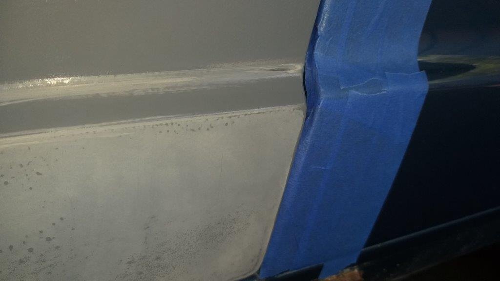

  4. In my last update I was battling to get the filler on the driver's door lower panel sanded evenly. Luckily @tortron stepped in with some much needed advice and a link to a really good "how to" video clip and I was soon back on track.
  5. Gave the angle sanding a go today using a shorter block and its looking much better. Thanks again for the advice.
  6. Yep, the ripples are a real bugger. Just below the inner skin too so I can't even get in from behind to knock them. I'm cursing my decision to pull all the bog out, but I wanted to make sure there was no more rust lurking under there and also the bottom panel definitely had that bloated look that you get when too much bog has been applied. Was also sitting way proud of the same lower panel on the front fender and back quarter panel with all that mud. So having said all of that I'm glad I removed it. It's just dealing with the aftermath now. I reckon the cross hatch sanding pattern that the video shows is going to be the silver bullet. Never even crossed my mind to try that, so I'm really grateful to you for the suggestion. Can't wait to give it another go.

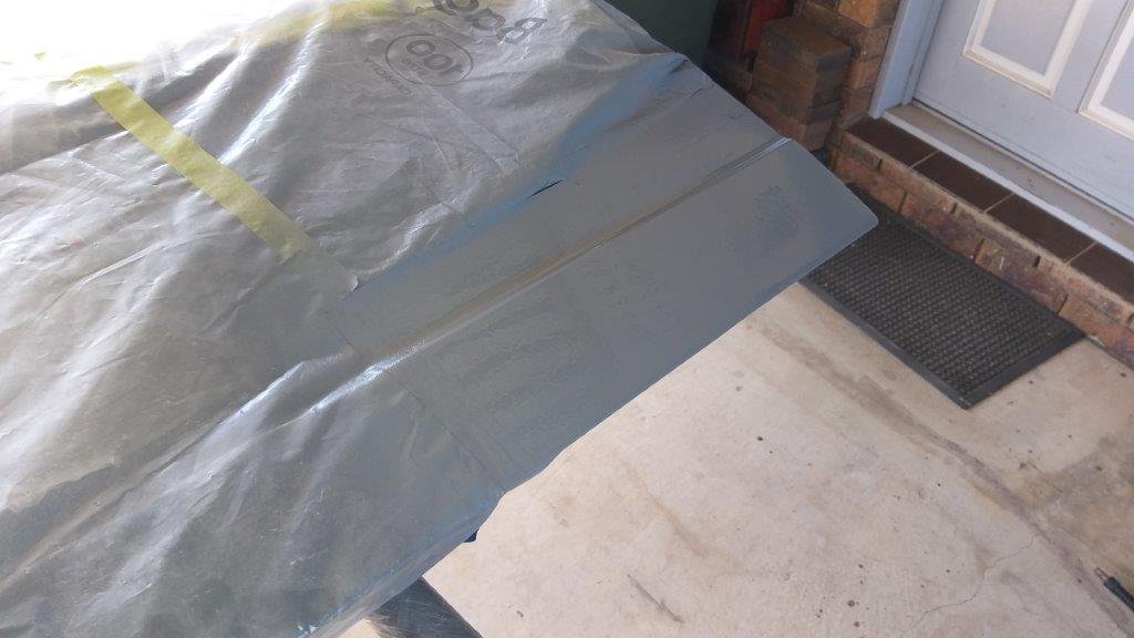

  8. The driver's door is another matter though. I am really battling to get the whole lower panel even. As mentioned earlier whoever had previously had a go at that door decided that taking to the bottom panel with a ball peen hammer would help keep the thick layer of bog in place. Try as I might I just couldn't get rid of the waves. Desperate times call for desperate measures so I ended up ordering a roll of 3M stick back sand paper which arrived yesterday, so this morning I hooked into it. Created the world's longest sanding block using an off cut of hardwood decking, but I'm still not 100% happy. I'm thinking that the board needs to be even longer so that the block never leaves the door surface. I'll re bog and try with a longer piece of wood. Hopefully this will do the trick. Thanks for looking.
