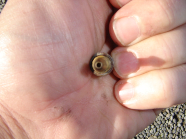

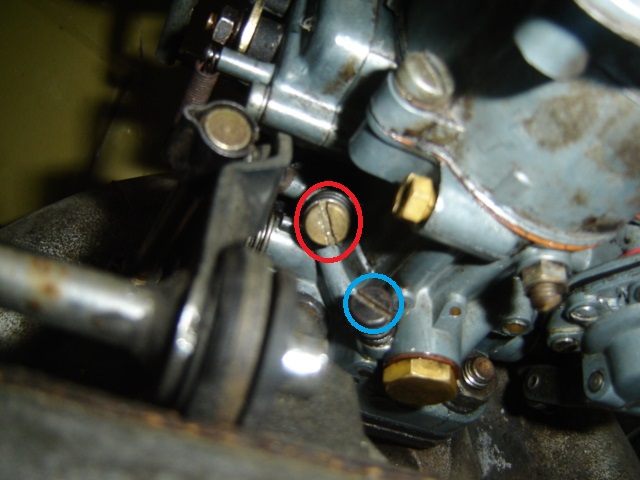

  2. The Fiat is running well on the road, but there are some starting and idling issues and transition issues to deal with. The first thing I have done is block off a vacuum take off that had nothing on it. This is clearly a source of un metered air and I had to tweak the throttle stop/ idle adjustment about 4 turns to compensate. I've just been for a drive to get the engine fully warmed up , re adjust the idle speed and have another twiddle with the mixture screw. I think the tip of the screw or the seat may be buggered because only when the screw goes tight does the idle even begin to pick up. I think the engine would prefer to idle a touch leaner even. I'm still baffled by the 3rd screw on the carb. I cannot find what it is in any literature I have or indeed the googlebox. I have had a fiddle with it, but I don't know what it's doing. I can see the results though... As received, this screw was snugged into its housing. backing it out half a turn increases the idle by about 1200rpm, but does nothing for the hesitation in pickup. I suspect the hesitation may be related to insufficient fuel from the accelerator pump circuit, although the pump diaphragm and seals are brand new. I need to find out what the mystery screw is anyway, it will drive me mad otherwise. Also takes a lot of cranking to get going when cold. These poxy carbs don't have a traditional choke either, it's some sort of magical enrichment circuit... Or this...... currently on TM for 6 hundy. Wrong manifold tho, for a worked 4K. Too much $ anyway for now, but we can dream.

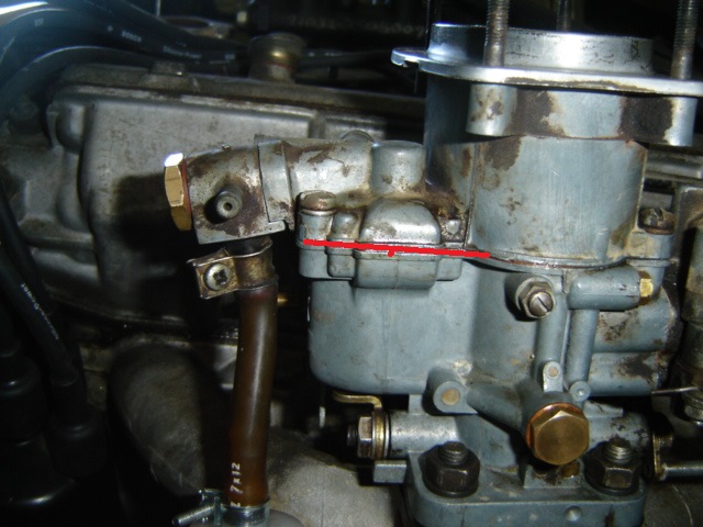

  4. My first instinct was breather for the fuel bowl..

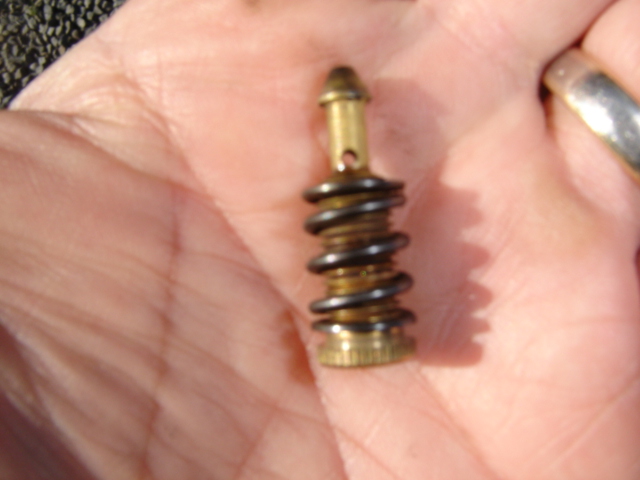

  5. 3. The idle mix and throttle stop are self evident. The other one looks like this when removed.
  6. Hmmm. The small breather was attached here....

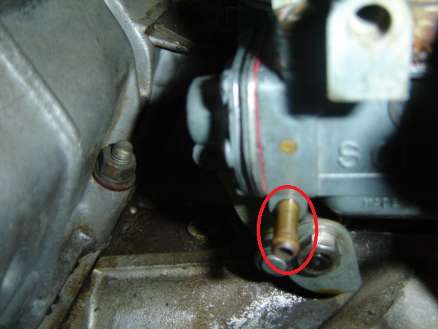

  9. I have fitted the carb kit. This is the easy bit. It did fire right up but doesn't actually run any better. Now, according to my manual it seems my particular Solex carb C34 PAIA/9 is an "exhaust emissions control" model. These words strike fear into my heart as this is usually a euphemism for "this is a shit carb and you will never get it to run properly". I must admit I am a bit of a noob when it comes to carbs (except for dirtbike carbs). I have a few questions for those more knowledgeable on the subject. Firstly, the screw outlined in red. None of the diagrams in the workshop manual show it. This was nipped up tight when I disassembled it and so I did it up the same. Twisting it with the engine running even 1/8th of a turn has a profound effect on the sucking noise the carb makes. I have no idea what it does. The blue circled screw is the idle mixture adjustment. Secondly, none of the diagrams show this spigot either. There was nothing hooked up to it, but it is sucking air. Blocking it with my finger with the engine idling makes it die. Thirdly, fuel is weeping from the red lined area despite the fact it is a new gasket, the surfaces are clean and look flat, and the fuel level in the float chamber is 12mm below this line. Actually I don't know if this is right as I can't find a correct float level anywhere in my books or on the google, just reference to special tool xyzabc to bend the float arm correctly...
  10. The little Fiat seemed to be running horrendously rich. There was fuel oozing out around the emulsion tube due to a bad seal. Also, it turns out the mixture screw was set 7 full turns out... 6 and a half turns in later and it's much better. I took it for a good fang up the road and the plugs are a much nicer colour. 3 days after this, a carb kit turned up. So easy to get at, I love it. Minutes later... Take one of these and call me in the morning.

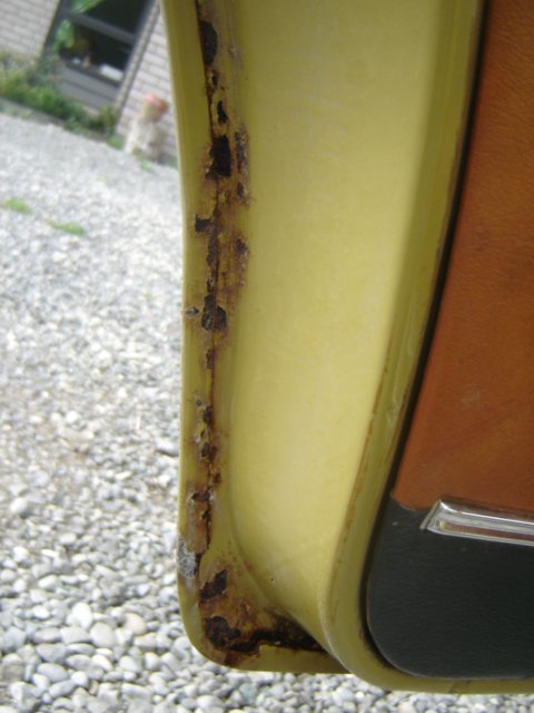

  14. Some of you may be thinking "hey that's not a proper project car, it's too flash eh" So, to prove its pedigree, here is a rust. There is another rust in the radiator support panel and I suspect a good quantity of bog in the front valance. Otherwise for one of these it's quite good.

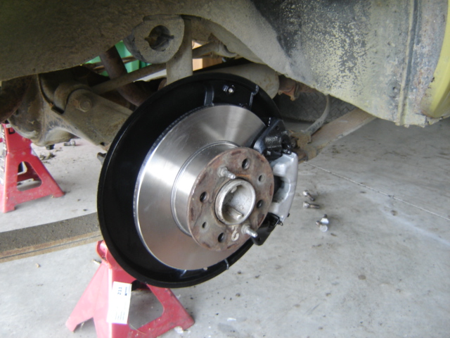

  16. Today is the day when after nearly 3 months on axle stands in the garage, the wheels are back on! Much excite. The painfully slow brake rebuild is finished. The daughters helped me bleed the brakes (they are finally tall enough to push the pedal). Once bleeding was complete I got number 2 daughter to put both feet on the brake pedal and hold it down to check for leaks of which there were 2. I managed to stop the leaks by nipping up some fittings. Actually by doing them up quite a bit more tight than I'm comfortable with... I felt brave enough to drive it to the servo to pump up the tyres. The car looks quite non-derelict so I don't think I'd get pulled over unless I was doing something stupid. The brakes feel really good. Got treated to a wash too!
