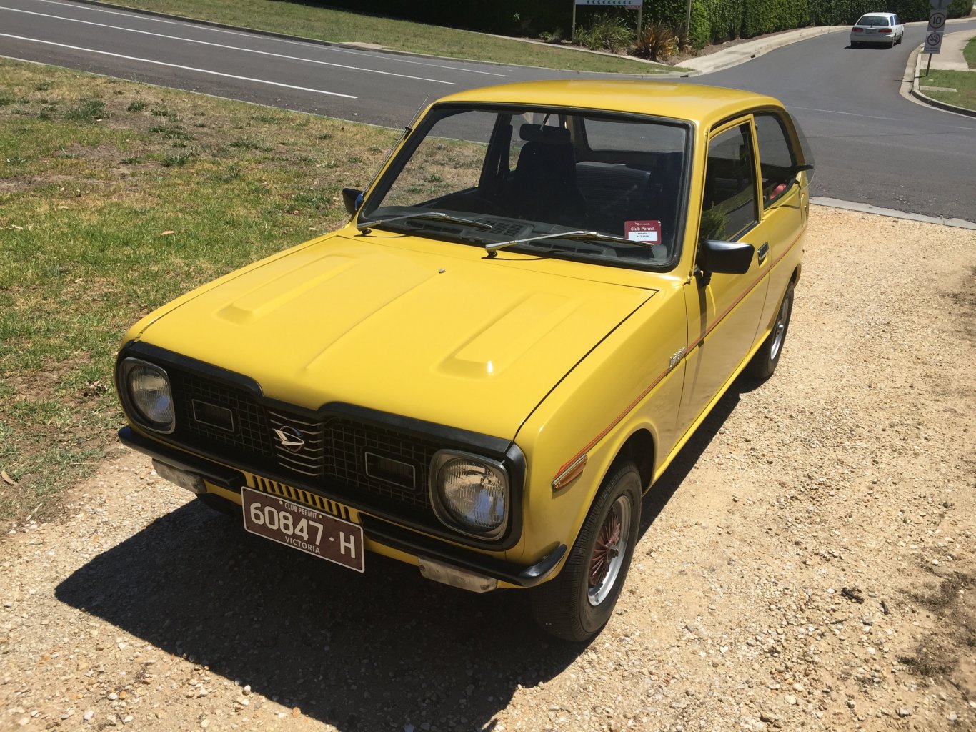

  3. After almost 5 years my Max is now fully restored. The mechanical work was finished a while back but this year I got stuck in to the paintwork/bodywork. After some poor attempts at doing it myself a mate helped me do it right. Several months later all dints and surface rust etc removed - the body was repainted in the original Daihatsu yellow. Also, we re-painted/finished the bumpers and grill, and even the air cleaner (back to original blue under the bonnet!). The finish looks great and it is now really like a new car. I have put in new grey carpets and a new set of seatbelts in maroon red, as the old ones were well past it. A final big clean of the insides and it has come up a treat with all those who say Max as the sad and broken little car 5 years back transformed now simply amazed at the difference. Here he is...

  6. My 1972 Daihatsu Max 360X has now been some 4 years in restoration. Starting with full brake rebuild then on to fuel tank restoration (sealing the old rust!). I got it running though very poorly, so decided to leave the engine until last. I took it to a local mechanic to get it roadworthy - so plenty of small jobs were needed for that. Biggest obstacle seemed to be the windscreen. They wanted it replaced but eventually accepted it was OK with a re-polish. The engine needed a total rebuild and took some 18 months of tedious work. Sourcing parts is such a headache from Japan! Finally little Max is registered (Club) and running on the road. He just may be the only one is captivity still? Next job is stripping the surface rust and doing a repaint. I am having a go at that myself. Here is a pix of Max as he is today...
  7. I have been getting a 1972 Daihatsu 360X back on the road over the last 4 years. Starting with a full brake rebuild, then fuel tank repair and seal, radiator flush and restore, new battery, plugs, and coil. It looked hopeful little Max would run. A startup produced hopeful signs, but the previous owner had played with the oil injection system - disabling ti and getting it to run on pre-mix. Why!?? After a trip to a regular mechanic (ignoring the engine issues) it took several more months to get it roadworthy and Club registered. But I did! Only to discover the engine a non-goer... A further stint of over 12 months with a trusted mechanic and 2-stroke expert pulled the engine completely down and discovered blanking plates inside to stop the injection system. Oh dear. Fortunately, I had bought a heap of spares when I got Max, and had spare pistons, etc. So a rebore and engine rebuild got the mighty 360cc engine putt-putting again. It still has a bit of an idle issue... but runs well, and once I re-attuned myself to the start and driving techniques suitable for it, I find it is a great around town runabout. It has created a lot of local interest here and it is really pleasing to have a Daihatsu 360X that really does 'go'! Now I am working to restore the paintwork and get Max prettied up, though keeping everything original. Love to chat to any NZ people with this kind of car? (Visiting NZ in September) [ Catch me chatting about classics - including Max - on 'Car Talk' on MAIN FM radio, Saturdays 8-10am (Aussie Eastern time) : it streams from mainfm.net ] I have some parts available I may be able to help with... Any Daihatsu 360s running in NZ??
