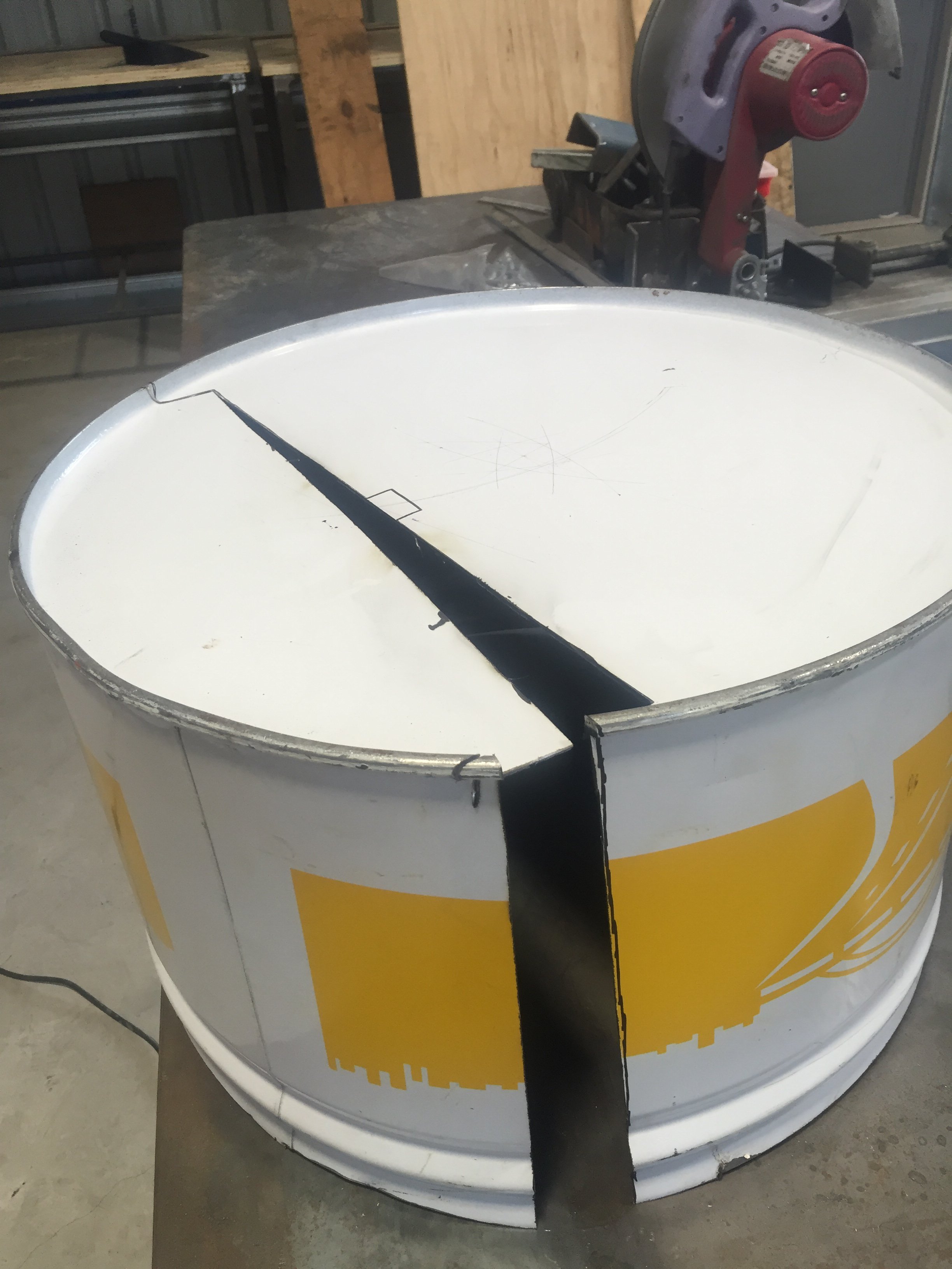

So I lied, I do know why. I had done a welding job on a mates sisters Corolla wagon and as payment received an old Lazer sedan. I thought I would use said Lazer as a track hack until me old Anglia was up and running. The problem was at the time I only had a single garage with a skinny drive I could park mine and the wife's cars one behind the other. This meant nil room for a transportation device of standard car trailer dimensions, so I thought, why not a dolly I could stand up against a wall. Research was undertaken and the frame was welded up....then I changed jobs and moved to a much betterer home. Lazer was sold and the Anglia project was concentrated on, and the new job didn't leave much time for anything else but pottered away on it, but as I finish up with this job in 2 days the rush has been on to finish it. As I wasn't going to put the Anglia on this dolly, but on a proper trailer, I decided to carry on with the dolly and get Wof and Reg and flick off for Anglia funds. I wanted to make it as low as possible with low guards, so went with JetSki trailer wheels and tyres, 8x8.5, nice and fat. The guards available for JetSki trailers were fugly, so racked the old pea in the noggin and stuck one of the wheels on top of a 200L oil drum at work, and Lo it had virtually the right radius. I liked the idea of the guard going past the 90 degree level front and rear, to get that custom look. I think they turned out quite cool. The fiddliest bit of the build would have been running the cables in the frame and connecting up 11 lights without having a rats nest, but I managed to get it all clean and tidy and hidden away. In the next day or two I will replace the 3 missing wheel nuts I managed to push into the matrix, stick 2 reflectors on, get rego'd and Wof'd and put up for sale. Can't wait to start my car trailer. pics in a mo, once I remember how to use host sight again....damn peabrain
