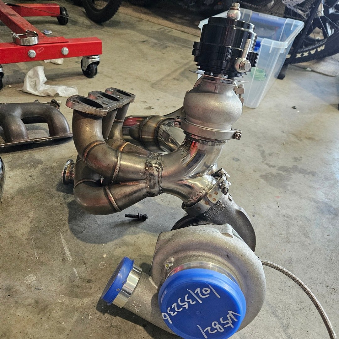

Well first cock-up found.... up pipe from cross over doesn't fit needs a zig zag easy fix I just didn't account for the depth of engine bay when making on dummy block Zach stripped the exhaust manifold off for me and made a start on wiring for too surprisingly once unwrapped all but a few wires reached the drivers side where airflow meter and throttle body is.- 744 replies
The size of the hotside assembly off the engine is quite considerable and looks mental when you pick it up and turn it around to check things out. I'm very happy with my driveway cobbling together on this occasion- 744 replies

Thought I had crossover pipe all sorted so did wee trial fit today found it ends up straight into sway bar mount. Fuck it re do it all. Turned out nice had a good few hours asphyxiating my self with argon loved every minute. Engine is now sitting at the perfect angle I can see it in garage from dinner table.- 744 replies
