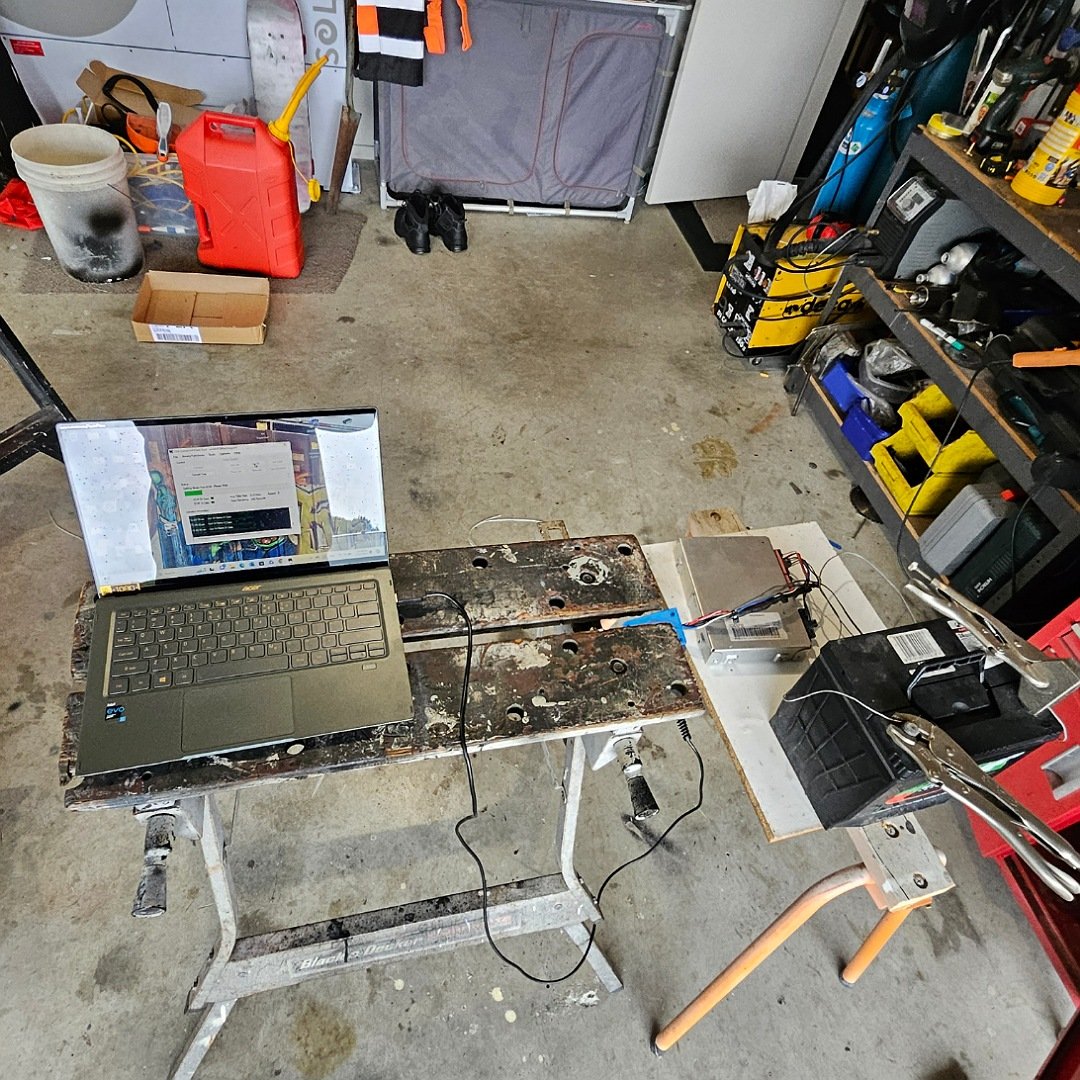

I decided to rule out anything weird it's time to stick the Factory PCM back in I fitted second hand one ages ago so I didn't risk bricking it while learning flash tuning. Seeing as car is now so far from stock it wouldn't run on it anyway with a stock tune nothing to lose. Flashed in my new Tune I've built on my bench setup tested coms are good everything was happy plugged it in started first pop. Tested in car on logging the wideband is definitely giving a signal to the ecu im unsure what its been displayed as through tunerpro if it's AFR it's running at 10.7:1 if it's voltage I've fucked up somewhere along lines as output should be 0-5 volts the signal is clean at least and tracks same as narrowband, I can work with that.- 754 replies

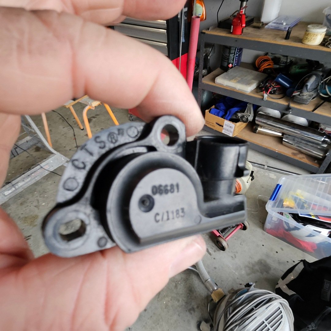

Did some stuff today fitted the new genuine Delphi TPS I got from @vk327 looks like the one on there was another Knock off brand any none genuine sensor has royally screwed me with this car, photo of old fake one compared old to new one with car plugged in to laptop there was some weird shit going on with voltage jumping around at certain place. New one linear as no dicking around.- 754 replies
