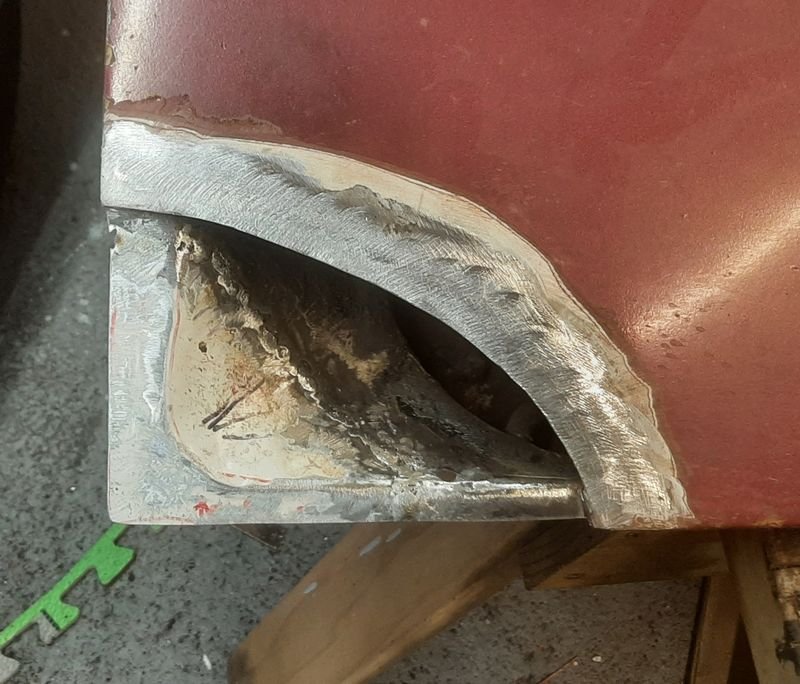

Popular Post azzurro Posted December 4, 2025 Author Popular Post Posted December 4, 2025 moving down a bit, more classic HQ rust, (and some dents). You can tell its classic rust, because the outline of the patch panel lines up pretty good with where i need to patch... yum! Gunk and dirt from the boot, wheel arches and door vents just collects in there and rusts from the inside out cleaning up good, no patches needed on the inner arch on this side, but the rear of the wheel arch panel did need replacing Just underlapped this patch as the outer will cover it and there is meant to be a factory leaded seam there too Patch panels are missing some details, the arch patch panel joins to it but its not quite right either Not that pretty but it is brazed from factory and hidden by the door, and many more rounds to weld 'n grind to go (and then many rounds of fill 'n sand after that) and in. 21 1 Quote
Popular Post azzurro Posted December 4, 2025 Author Popular Post Posted December 4, 2025 And of course the gunk at the top of the arch also gets into the bottom of it as well. For some reason i didnt do this area on the drivers side, and its not becasue its good! Drilled the dog leg out to reuse, its been patched (with braze) already, but i need to reuse it Doesnt look too bad but all these panels had sections with pitting and pinholes Didnt take many photos of the process of making patch panels and etc, but there is a lot of new metal here it was just easier to cut it out and remake than try to patch the rustholes. this is just after installing the lower third of the dog leg patch panel. Now the new sills will have something decent to join to. and cleaned up - ive left the original brazed patch in as it was still good, and i think cutting it out and letting in a new bit would have made it worse. Also for some weird reason it makes me smile to think that someone in the future restoring this might think this has only been repaired the once, way back in the day The back of it all got rust trated and primed etc before going back on, whcih is way better than it was so it should last another 40 years. and then a pic of round 27 of 58 fill 'n sands, still a few wobbles to smooth out... Apart from the drivers side rear dog leg that will need more or less the same work as this side, we are pretty much at the point now where the next step is to have the (bonded) windscreen removed to make a start on working my way down the A-pillars starting with the plenum corners, which i have patches for the outer - the inner will need some work too but ill make those. Anyway I dont think the rust has got up behind the windscreen and the surround and inside the door jambs looks good, but having the screen out will make it much easier to both know for sure and make a proper job of the repairs i already know i need to do. One bite at a time... 30 1 Quote
