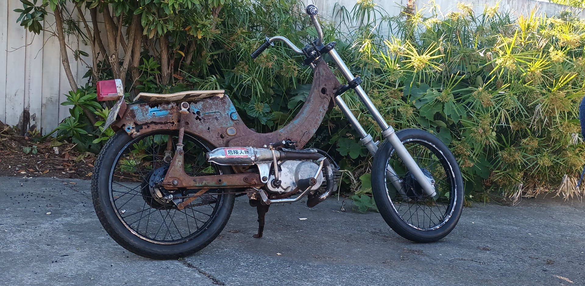

Had some time lately to work on this pos, for anyone who wants to know but AG front forks fit perfectly even with using the u5 headset bearings, score!!
Think ive nailed down the look now, searching for a 19 or 21 inch front wheel to run a skinny tyre and some sort of tall bias ply rear tyre on the back but for now this will do.
V90 motor sitting in the frame now too, needed to cut more of the frame and "massage" with a blunt instrument to fit but hey its in i guess.
My mate is pestering me to go for a ride so should make steady progress each week
  • Like 5

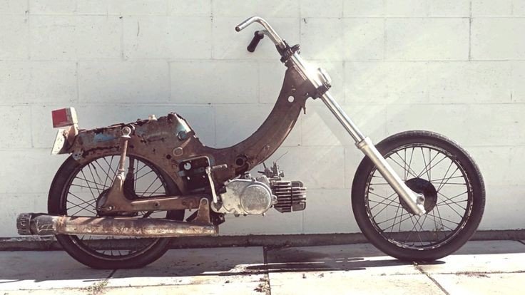

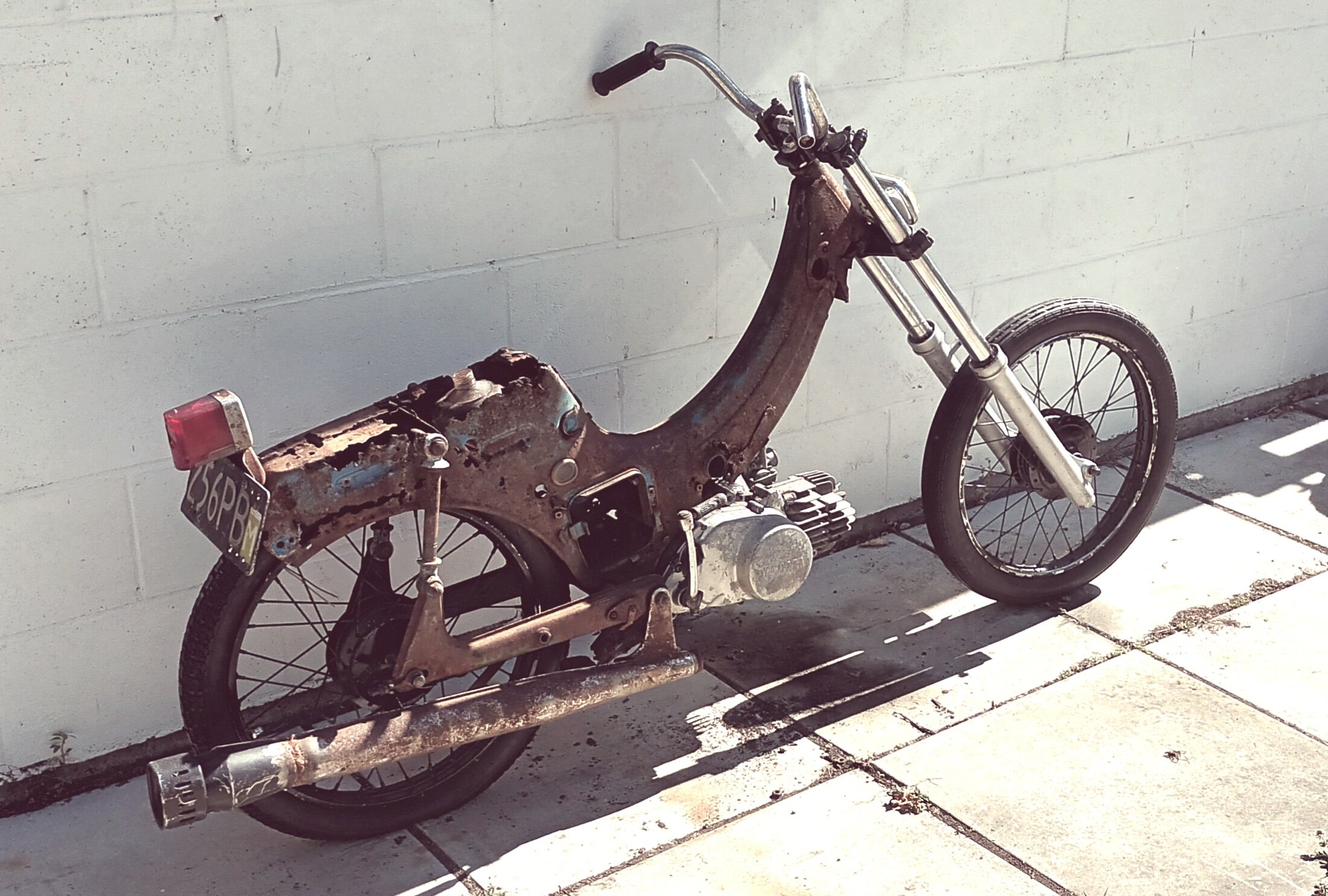

Decided to do something different with the exhaust, just enough clearance for the kick start lever
Rear brakes hooked up and "working"
Engine mounted along with foot pegs
Front wheel spacers made up and in, need to make something to keep the drum hub still
Realistically only needs throttle cable, fuel line and wire up the key and coil
Yee
  • Thanks 1

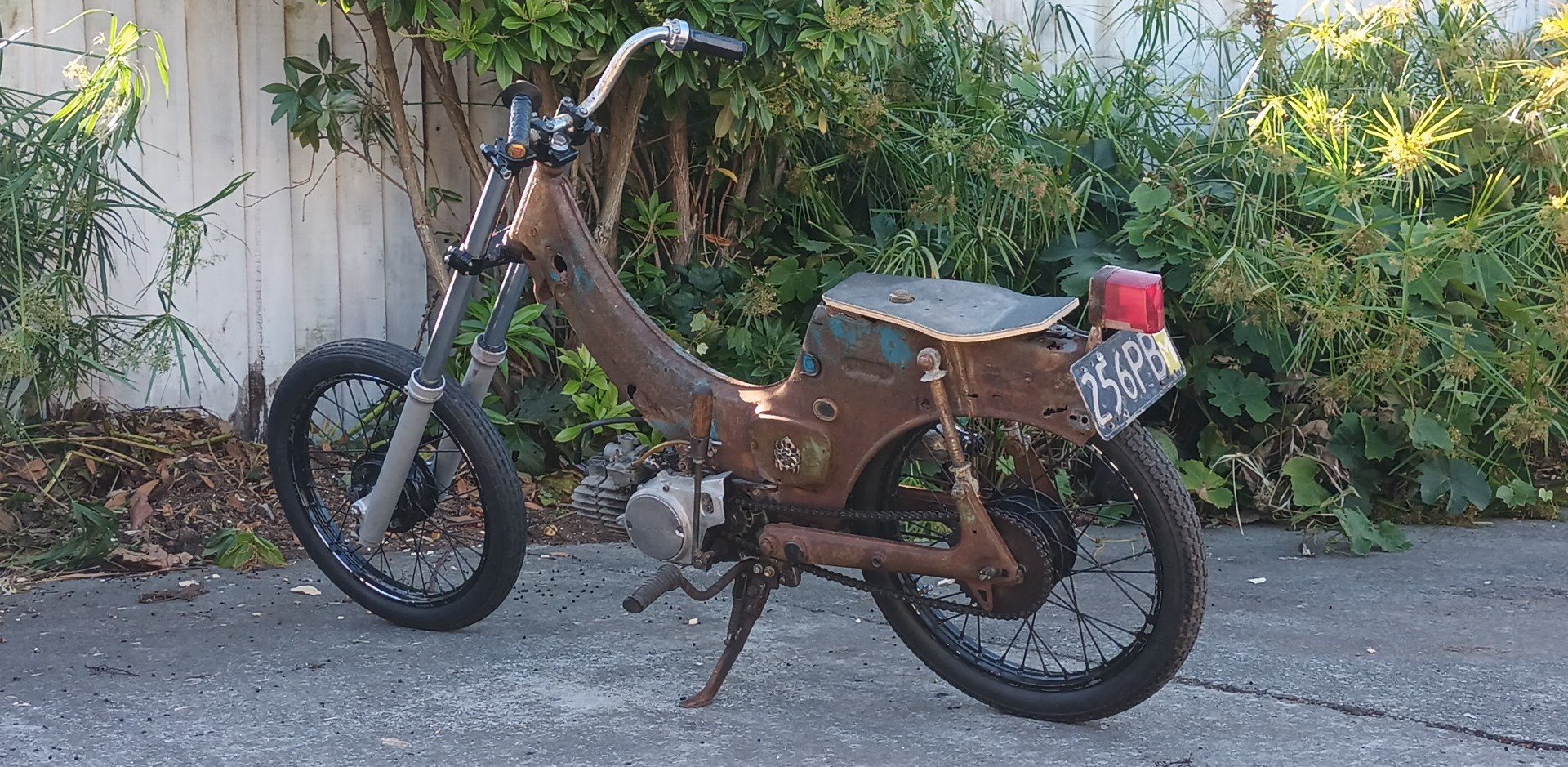

Last 2 things before it can go on its maiden voyage
Need a m18x1.25 nut for the rear hub to finish that off
Has also decided to run a bit fucky wucky. Starts awesome, revs nicely and comes back to idle no worries but as soon as you jam it in gear it dies. If i have it on a stand i can put it in gear, go wide open throttle and it will pop/fart until it finally clears its throat. Guessing its way too rich but i cant lean it out any more, need some decent 2 stroke oil and gas though so will start there and try again
