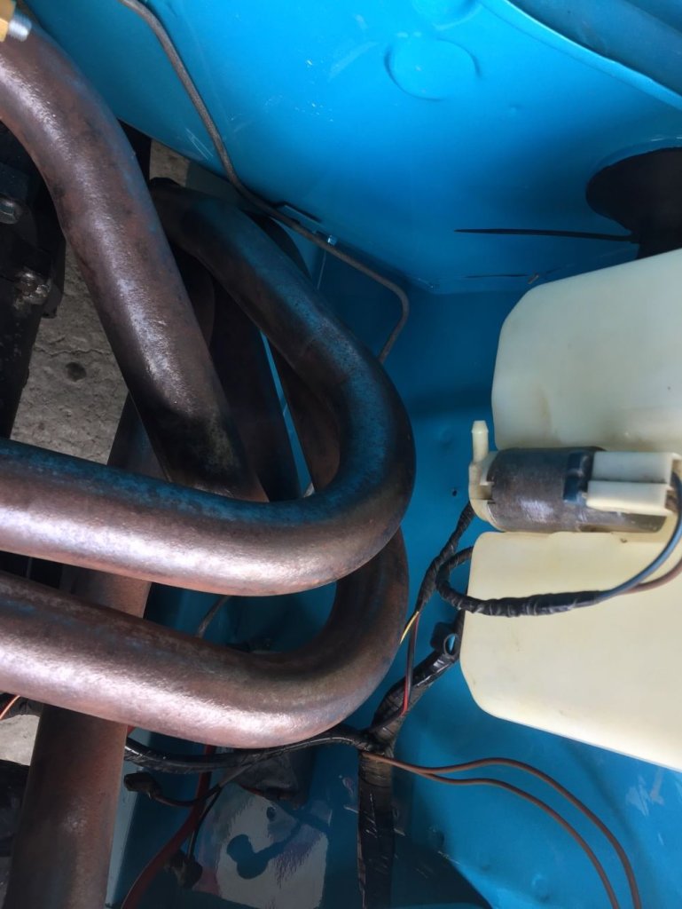

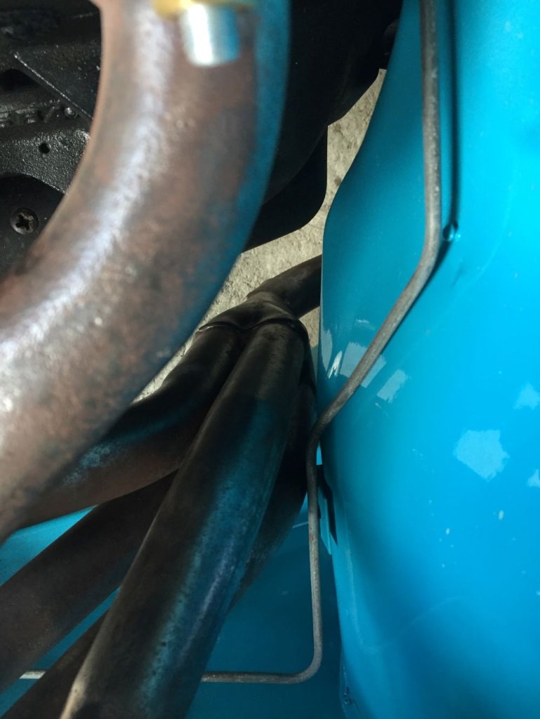

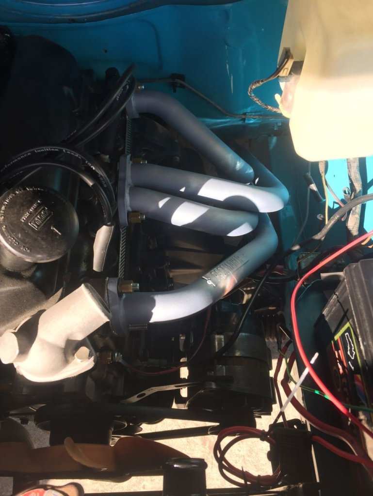

Popular Post Petes mk2 Posted January 25, 2024 Author Popular Post Posted January 25, 2024 One of the last things to sort out is the exhaust for car. Started out by cleaning up extractors that came with car but on a 1300 motor. I think they are coby's and cleaned up really well. Winner I thought until fitted. They are hard up to firewall and very close to washer bottle. Not going to work, so onto the next option. A set of Ashley extractors which were not much better. Not sure why these are not working for me . After a 6 week wait for a set of Pacemakers which are now in place I'm very pleased with alignment and clearances from other componets. Will hookup to old exhaust for startup and get it replaced later. Just have to sort out what size pipe I'm going to use. Project Discussion https://oldschool.co.nz/index.php?/topic/84912-petes-mk2-escort-1600-sports/page/2/#comment-2614933 16 Quote

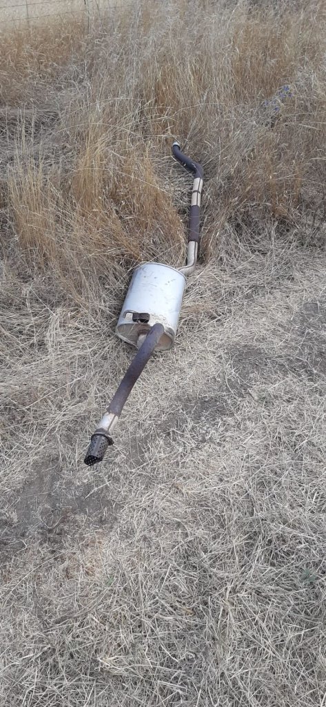

Popular Post Petes mk2 Posted March 20, 2024 Author Popular Post Posted March 20, 2024 We had great weather in the weekend so decided it was time to take Jenny, my long suffering wife out for a drive in the escort. Things wrer going really well until I noticed a change in the exhuast sound followed by metal scraping on road. Quick stop and inspection shows that they don't make baked bean cans like they use to. Managed to remove exhuast from under car while jen was busy taking photo's and letting family and friends know how her first outing in the escort went. Needless to say it was a very noisy 8km trip home. Lucky we live in the country so left exhuast on the side of the road to be picked up later and booked in to get new exhuast fitted. Project Discussion https://oldschool.co.nz/index.php?/topic/84912-petes-mk2-escort-1600-sports/page/3/#comment-2625686 6 2 7 Quote

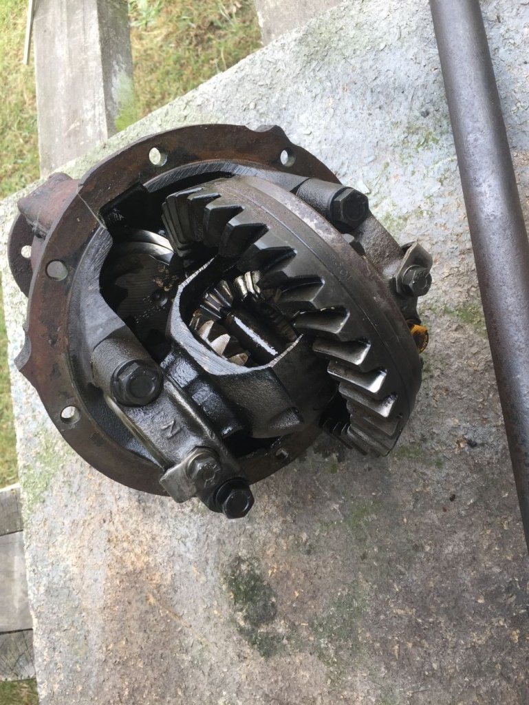

Popular Post Petes mk2 Posted January 9 Author Popular Post Posted January 9 Next on the list of things to do is reduce the rpm to get 100km highway speed. When I got the car it had a 4.1:1 ratio diff in it. To drive on open road at 100km/h you were doing 3900 rpm. To reduce this I decided to change to 3.54:1 diff head. Retrieved old axle from yard and removed diff head (4.1:1). Diff head looked pretty good considering it had been sitting out in paddock for 15yrs. Had this rebuilt with new 3.54:1 crown and pinon. Put this in and road tested. Now we get 100kmh at 3100rpm which makes driving on the road much more pleasant. Speedo not so accurate now. Not sure what to do about this. At the moment using phone as GPS speedo Project Discussion Petes Mk2 Escort 1600 Sports - Page 3 - Project Discussion - oldschool.co.nz 16 Quote
