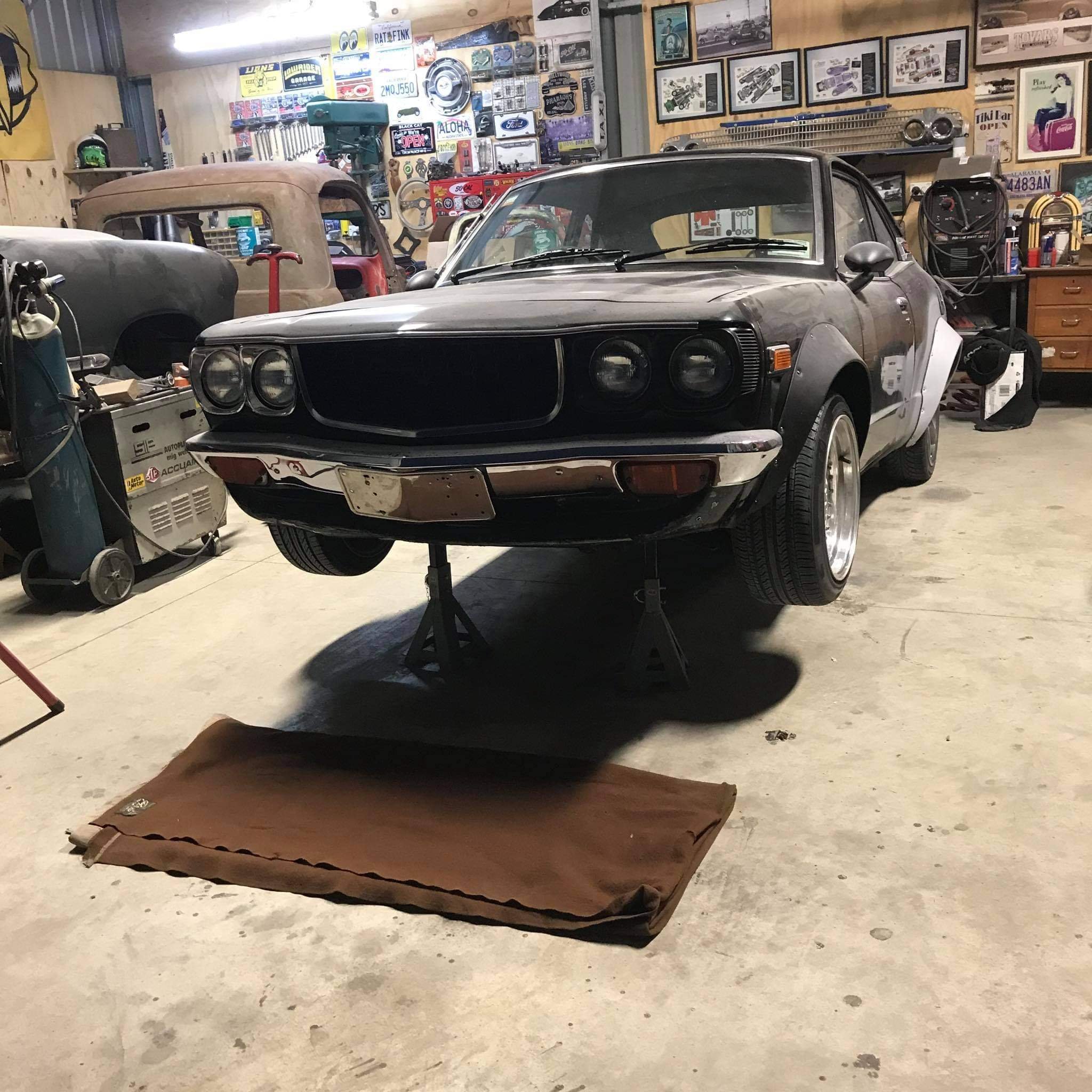

Popular Post MRWEST Posted April 27, 2020 Popular Post Posted April 27, 2020 Just before Xmas came across this 808 Coupe on trademe/insta for sale. Have always wanted a RX3/808 Coupe and timing and things kinda fell into place. Basic details are 808 Coupe: -12A Steel nose cone -13b bridgeport, 48mm IDA -S4/5 RX7 5 Speed box -S3 LSD rear end -Coilover front -Tidy black interior -Savanna Tail lights -Bolt on flares -15 x 10 with a 195/40/15 (stretched to tomorrow) and 15 x 11 with a 205/40/15 (Also stretched to tomorrow) BBS RS wheels. Got good bones and the right bits and pieces on it just needs a bit of love, has a few things to sort out and work through to get her sorted. Wasnt running when i picked it up which was a bit of a gamble. Pics of when i picked it up and bought it home, late night mission got home at 1am on a school night zzzzzzzz. Have done a fair bit already will post more updates during the week. Discussion fred below 35 4 Quote

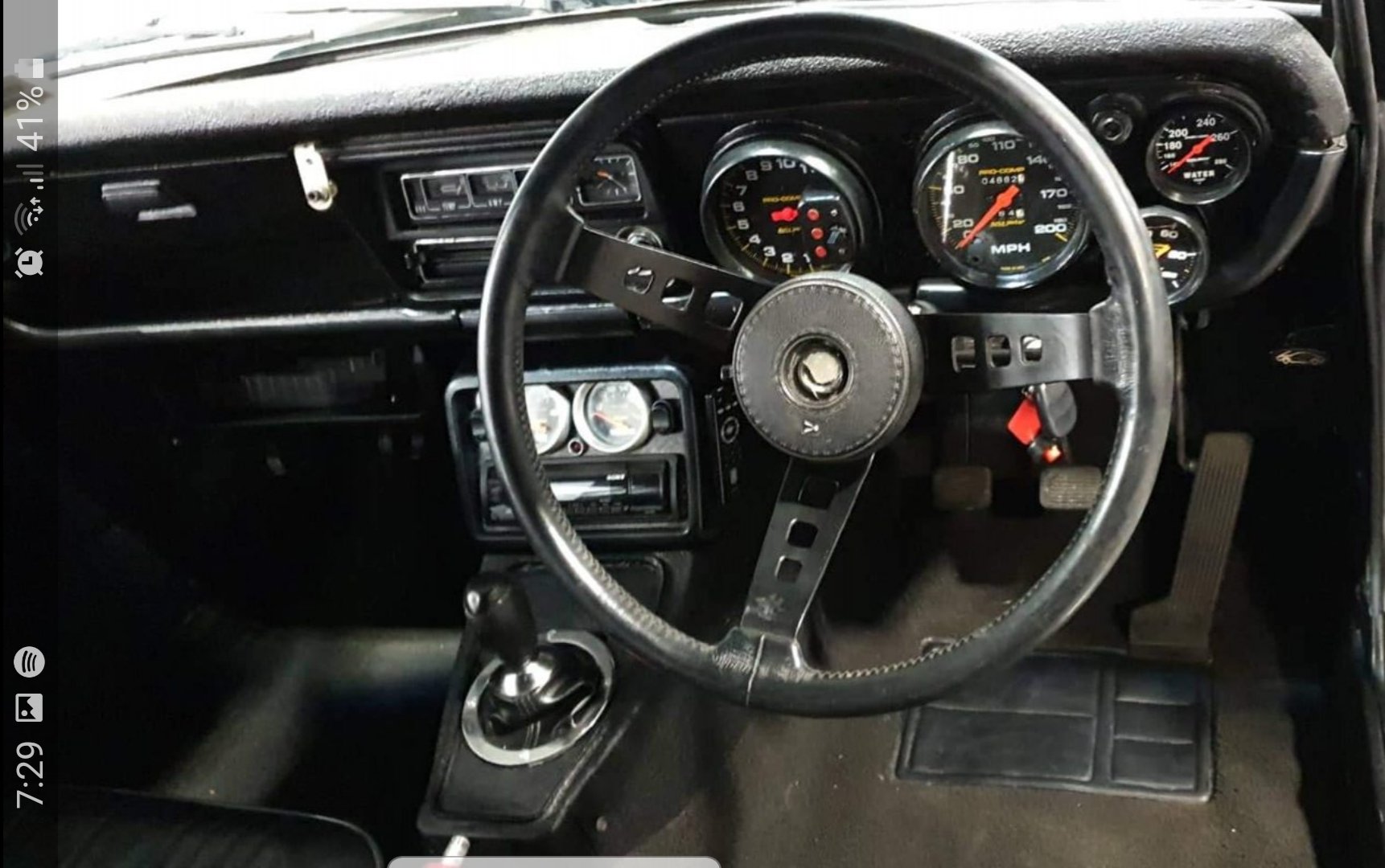

Popular Post MRWEST Posted May 3, 2020 Author Popular Post Posted May 3, 2020 So when i got the car the dash topper, gauge cluster, centre console had all been black winkle painted. Had a modified factory cluster to fit a set of autometer guages. Black wrinkle paint not really my thing so decided ill put the dash and cluster out and clean it up and repaint it satin black. So pulled the dash out, tried to clean up the topper but wasnt having much success so a quick call to the man @64valiant and will be getting the dash topper over to him to trim in a nice black something. Will repaint the steel part of the dash top while its out too. Got the gauge cluster out to clean that up which also turned into a can of worms. Ended up finding a brown factory cluster with speedo etc to either run factory cluster and flick the volts gauge, mount tacho below dash next to steering column and change the gauges around in centre console so only the ones needed are left. But then after that also found a factory black cluster with no gauges so will have a look how easy its going to be to modify that one (tidly and not wrinkle painted) to fit these gauges back in similar to as they are now. Both of them are on their way to me so will see what happens when they get there and make a plan to tidy it up as best as possible without buying a heap of new stuff. 12 Quote

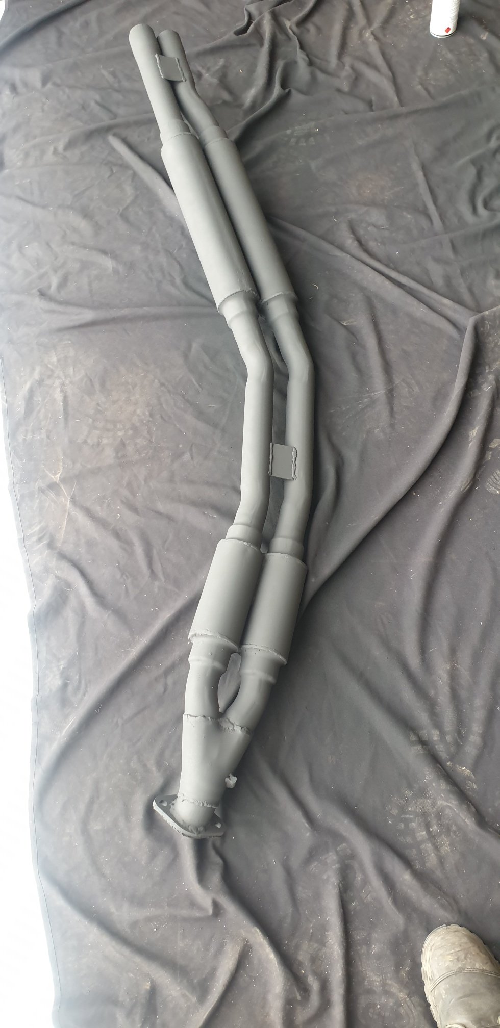

Popular Post MRWEST Posted May 17, 2020 Author Popular Post Posted May 17, 2020 Got the new exhaust last week, Good score for $350, alot better than mine and is well made. Had a mate come on the weekend and weld my muffler on so just need to pull apart and clean up and put new exhaust manifold gasket on and thats the exhaust sorted. Got one side of the front brakes on, front suspension wound up a bit and its looking good. Ordered some HAWK pads from SpeedScience a few weeks ago which turn up today so ill get those in and bled up and thatll be the front brakes/suspension sorted. All coming along nicely. 15 Quote

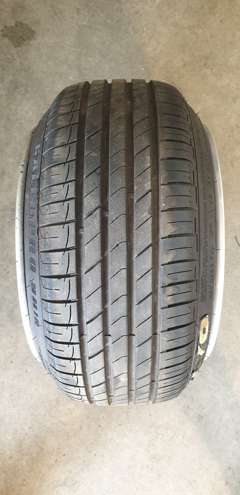

MRWEST Posted June 4, 2020 Author Posted June 4, 2020 Havent done much in the last couple weeks been sorting the truck vin and other bits. Ordered some new tyres for the rear, Have gone with 225/45/R15 Nexen semis (best priced tyre in this size by a long way) to go on the 10" rim. Also was putting a new speedo cable into the truck and realised the chev factory gauge end fitting looked similar to the autometer speedo i had with no cable. Tested it and sure enough it did. Had a mazda cable to fit the s4 box so sent it all down to CBC in Christchurch who made me a new cable to suit which looks to work perfectly. Got to sort the last of the truck vin repairs this weekend then ill be back into this to get it sorted and rolling again. 8 Quote
Popular Post MRWEST Posted June 7, 2020 Author Popular Post Posted June 7, 2020 Got the new tyres put on the 10" for the rear over the weekend. Much better and less strech haha. 14 1 Quote
Popular Post MRWEST Posted June 21, 2020 Author Popular Post Posted June 21, 2020 Havent done much for the last month or so as had a bit going on. Got the full new exhaust painted with heat paint and on this weekend, sounds primo and alot better than the one that was on it. Got some new Hawk HP Plus pads for the S6 Brake setup and have fitted that up, should be a good stopping package now! Just waiting on some new front brake lines and that can be bled up and car can hit the ground again. All booked in to get the rust sorted in a couple of weeks so will get that sorted next. 10 Quote
