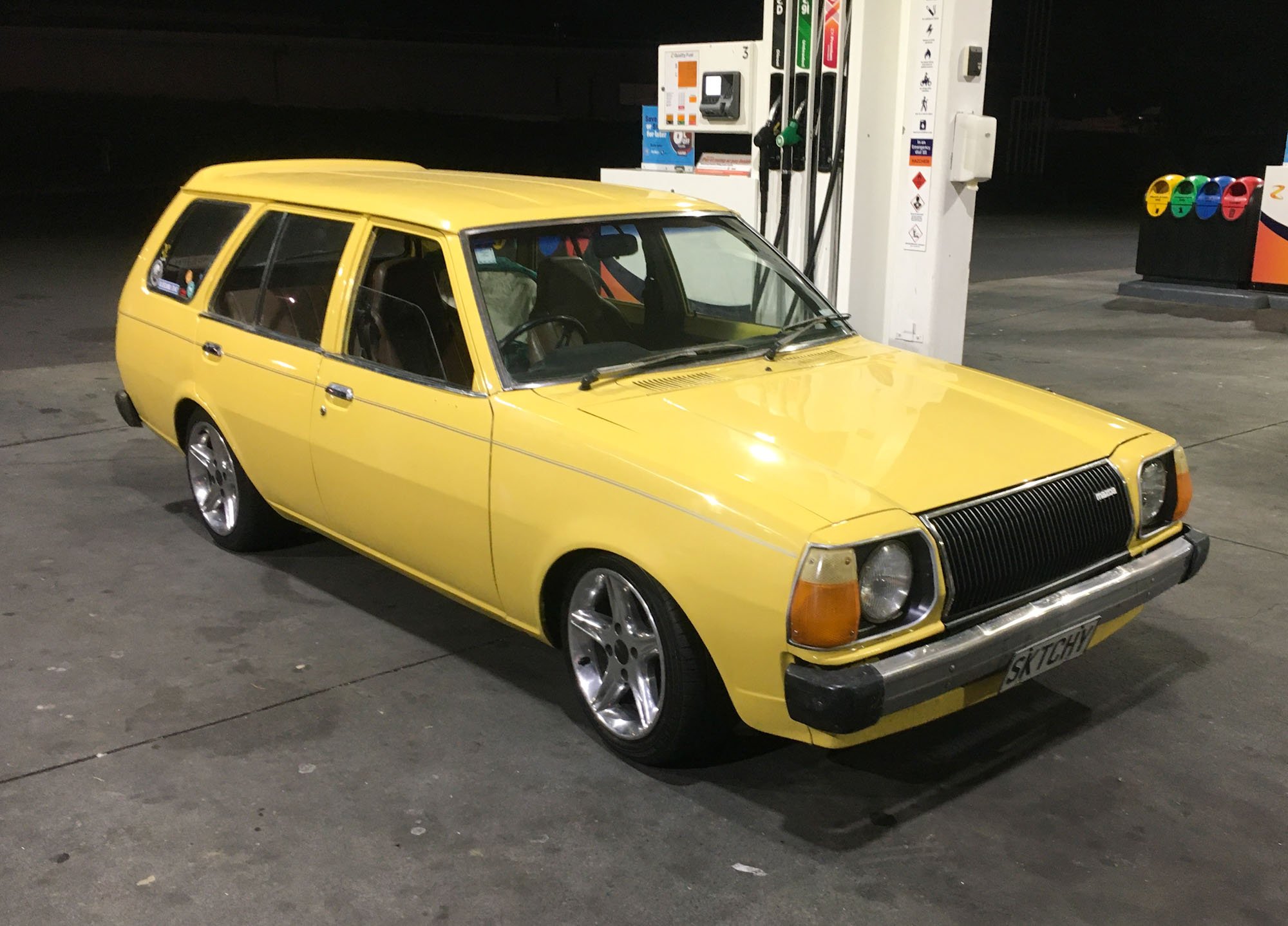

Popular Post oldrx7 Posted May 24, 2020 Author Popular Post Posted May 24, 2020 Sold the modgies and found some nice n cheap wheels to put on for now - could do with a re-polish but I'll see if I can be bothered spending the time on them. Need to sort some front shocks as the springs aren't captive, and get a set of 1" blocks for the back. 22 1 Quote

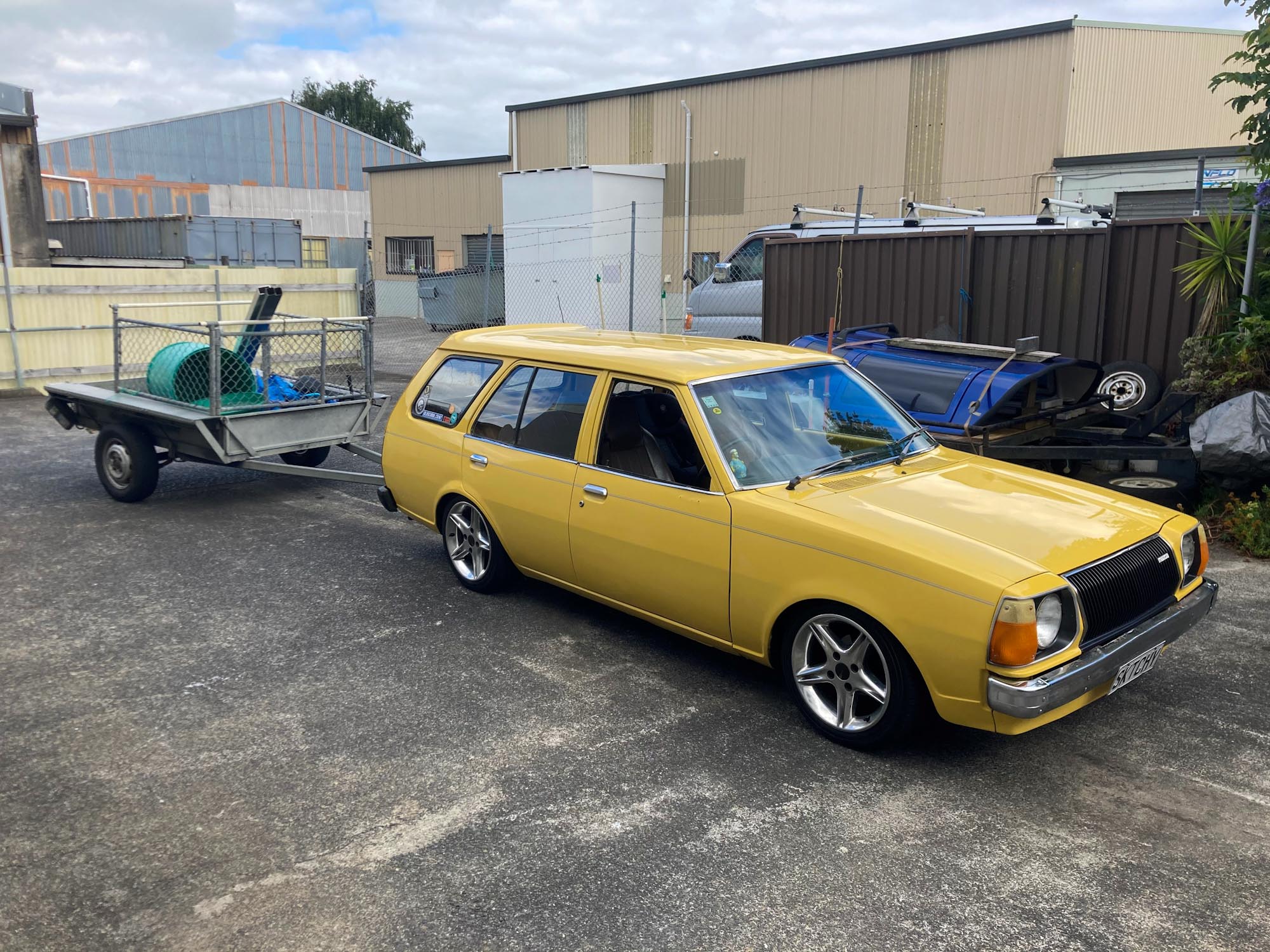

Popular Post oldrx7 Posted February 2, 2021 Author Popular Post Posted February 2, 2021 Had a ton of fun taking this down the strip at Meremere at the drag day back December. Slow racing is just as fun as quick(er) cars I've taken down the drag strip. Was running low-mid 20's all day, then a mate suggested taking off the air filter. Ran 3 mid 19 second passes after that! Sold this as of last week. Had someone approach me offering what I think is silly money for it, so that had me curious as to what people might be wanting to pay. Put it up on FB and it was gone in 24 hours, so must have been priced right and I'm glad it was a quick and easy sale. Was tempted to try a home build 12a and do the rotary conversion on it, but being registered as a 1985 instead of a 1979-81 car may have opened a can of worms during the cert process which I wasn't too keen on potentially opening. Would probably have to be a mazda geek to know the differences, but yeh ... Anyways, it's gone to a nice guy near Hamilton, who wants it for similar reasons I did, to putt around in, and not having to worry about it too much as it's a bit rough around the edges. 17 Quote
