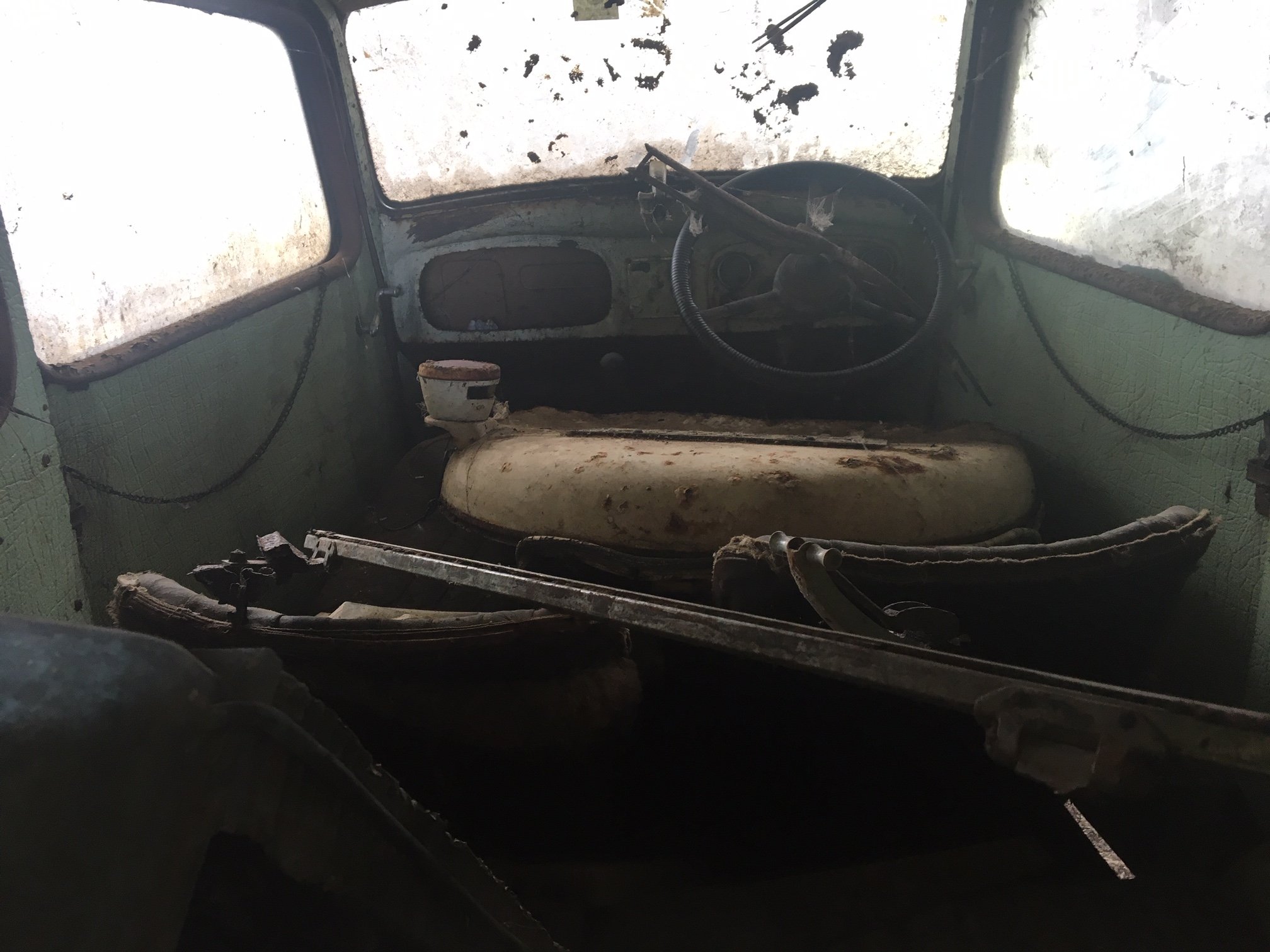

Popular Post anglia4 Posted July 11, 2019 Popular Post Posted July 11, 2019 Discussion: Lurking in the back shed at my grandads farm for all of eternity has been an old Austin 7. There was a bunch of old cars there that as kids we used to play in, but the Austin had been there for so long that it was completely buried under hoarded shit and was far too scary to play in, but was always interesting to see if you peered past the old L300, Fergie 19 & piles of old timber. As a 10 year old kid, I was smart enough to know that this one was well beyond rescue... Fast forward 20 years: Grandad has passed on and the sheds have been mostly cleaned out for the next generation of hoarding, revealing this little Austin. Now 30 year old Jeff is not half as smart as his 10 year old self... So now I look at it and think "I reckon I can save that... maybe..." 33 Quote

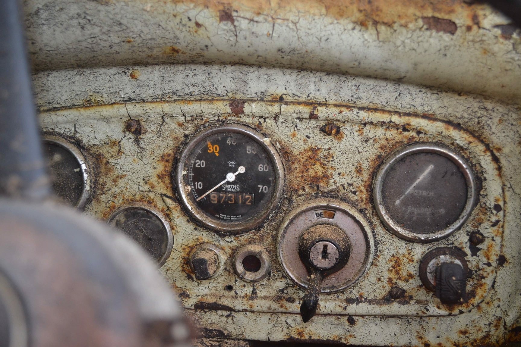

Popular Post anglia4 Posted July 14, 2019 Author Popular Post Posted July 14, 2019 So given this complete bombshell of how easy this was looking like being, we put a strop around the diff. Put the VX landcruiser in low ratio, and gently towed it out of the shed. To blow my mind even more, I think I jokingly said, "wouldn't it be easy to steer if I could wind the window down" at which point I grabbed the window winder and wound down the bloody window! This little car blowing my mind with how much of it still works is kind of becoming a theme. 18 1 Quote
Popular Post anglia4 Posted July 14, 2019 Author Popular Post Posted July 14, 2019 The interior has this lovely shade of green everywhere, which somehow looked quite familiar. I asked dad if it was in fact the same shade as the benching in the kitchen at my grandparents house when I was little. The very same. Jeez grandad was resourceful. 12 1 Quote
