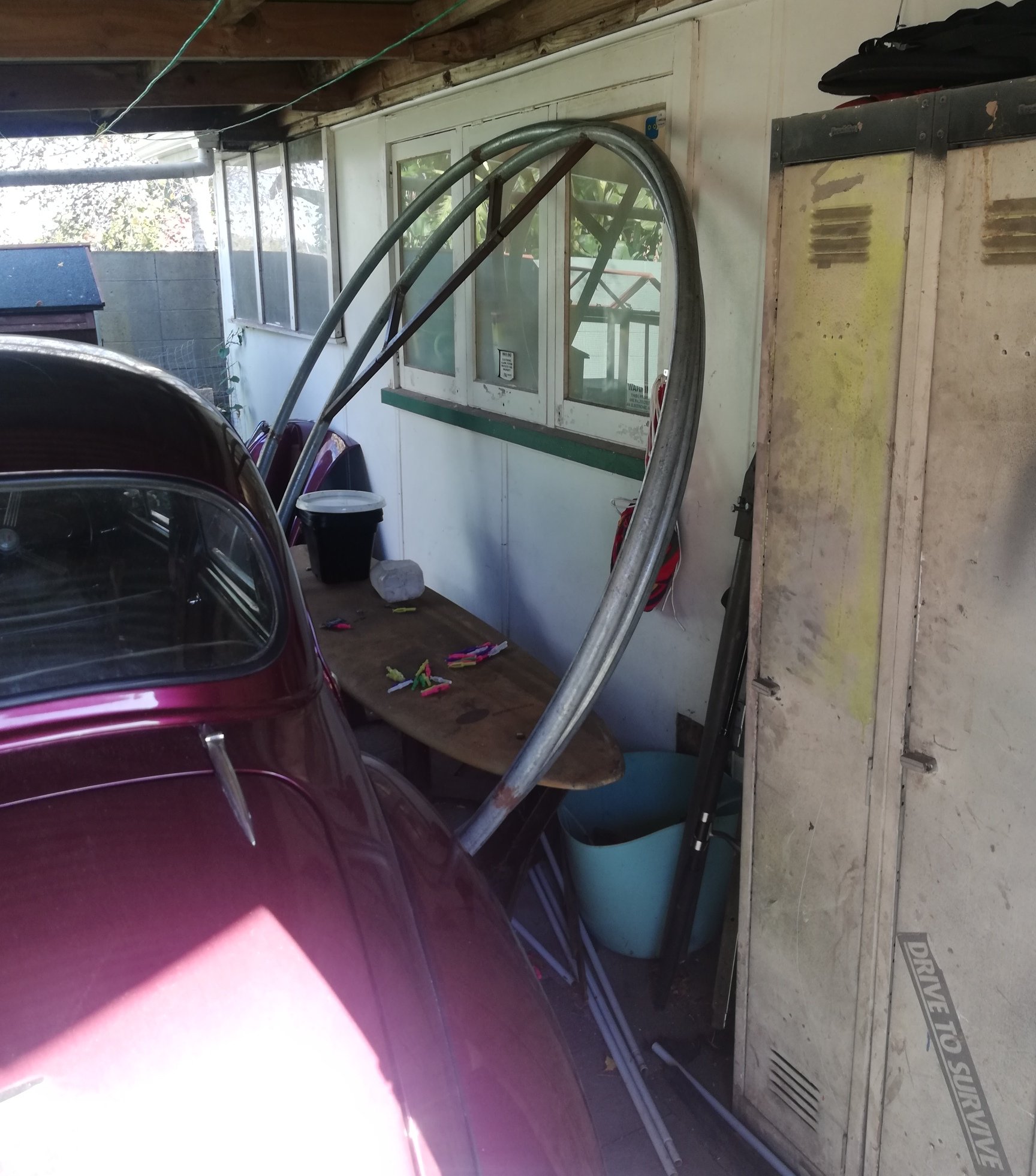

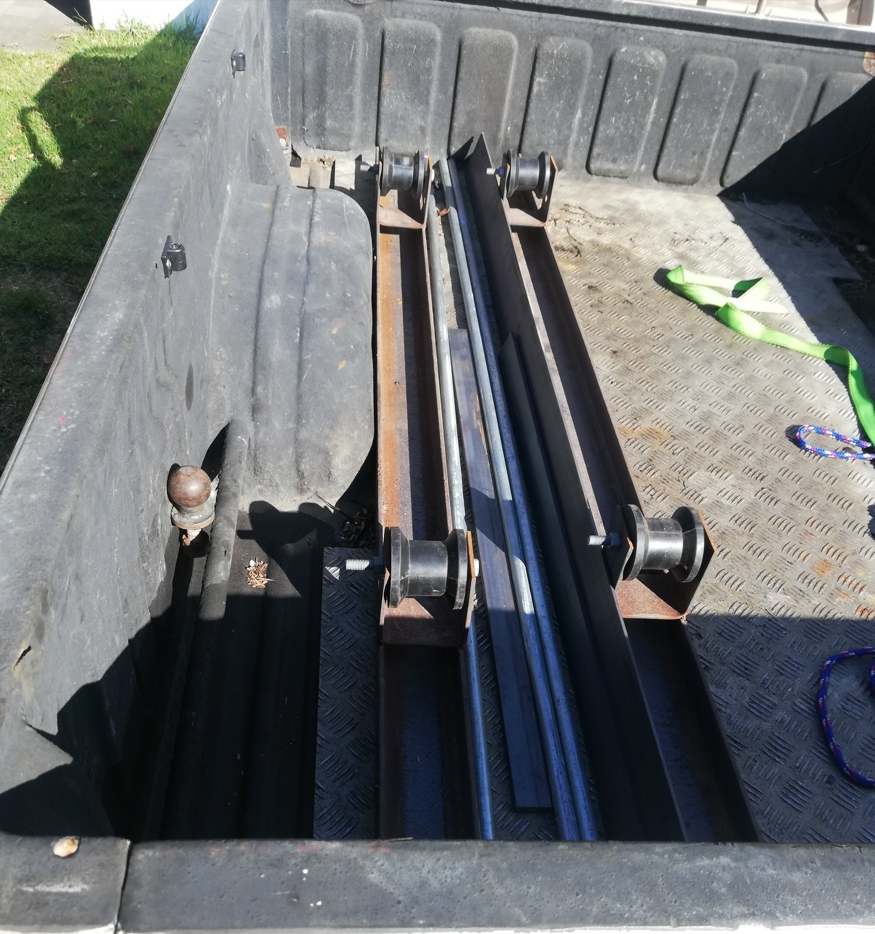

Popular Post tortron Posted May 4, 2019 Author Popular Post Posted May 4, 2019 Replacement chassis legs and engine bay tie plate A roller hoop rotisserie And a bunch of steel plate and tube for various chassis jigs. I'll make something like this from the BLMC minor chassis repair manual. 17 Quote
