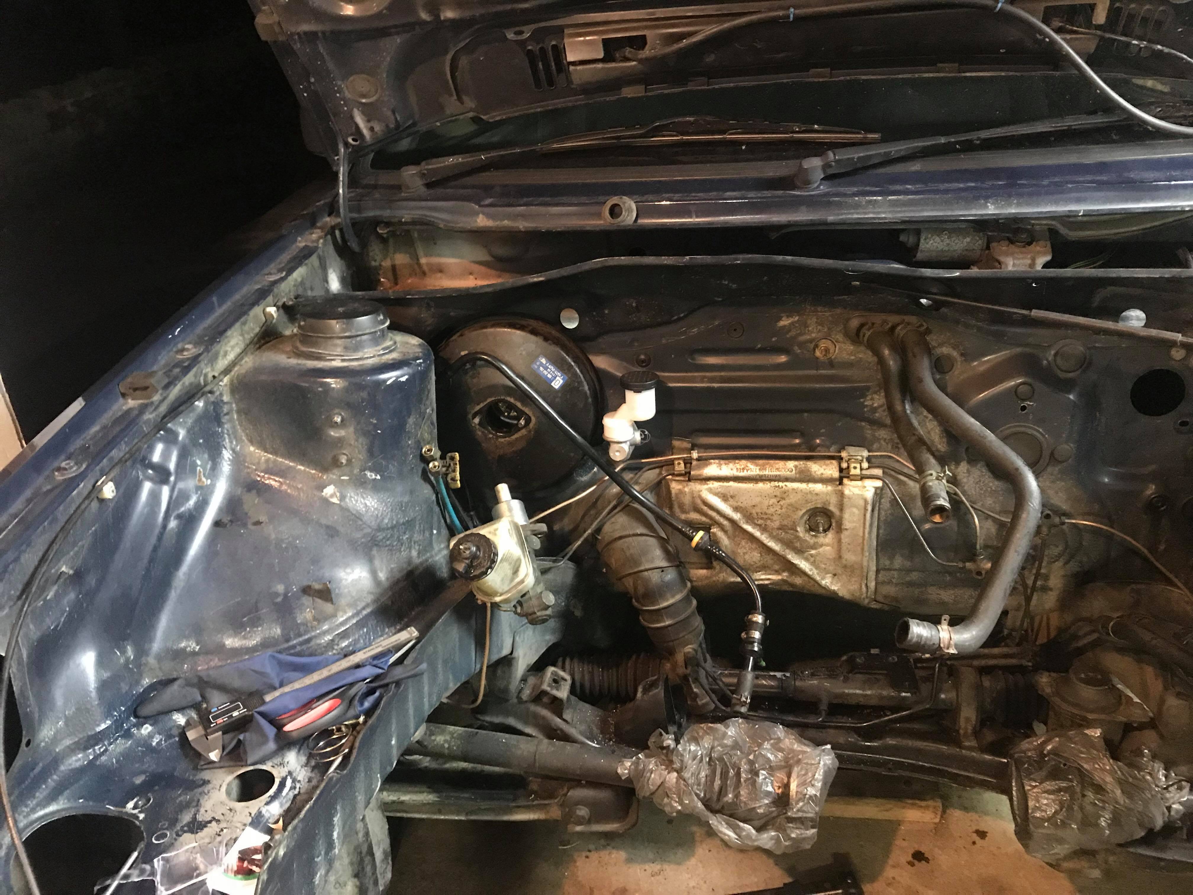

vwthomas Posted February 3, 2019 Author Posted February 3, 2019 So November 2018 after a little bit of time collecting parts I decided I wanted a little more power and a new challenge so the plan was set for a 1.8 20v turbo setup to be swapped in from a mk4 gti. Anyhow here is the disassembly. 3 Quote
Popular Post vwthomas Posted February 4, 2019 Author Popular Post Posted February 4, 2019 Started retro fitting a Pajero clutch MC to my firewall so we can convert the car to hydro clutch as the new gearbox requires in. 3D printed a spacer to make the distance between the clutch pedal and MC correct Also began filling any unused holes, and bits and pieces that weren't needed. Got to learn to mig weld during this which is something ive not really done before. 12 Quote
