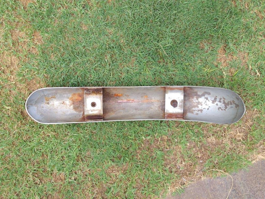

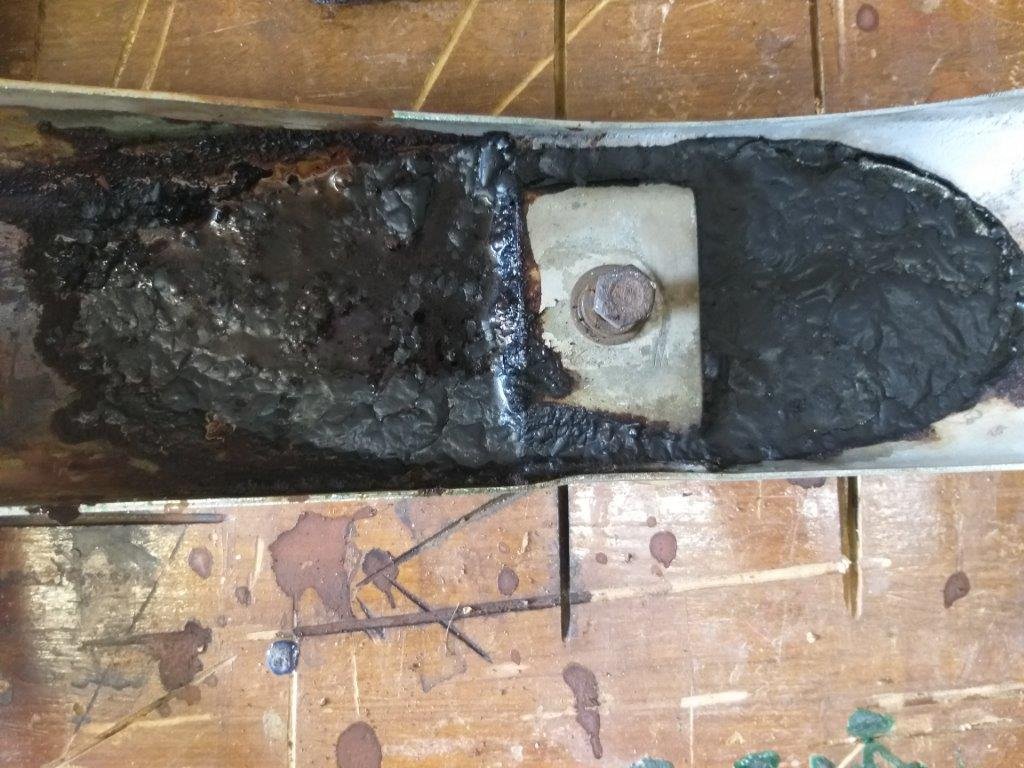

In the time that was left I carried on doing a bit of work on the rear bumpers. When I bought the van they were sitting in a cardboard box so have never been fitted during my ownership. The outside chrome shows a bit of patina, but might come up with the old "coke and tin foil trick". The insides are a different story with quite a bit of rust build up. So yesterday I turned them over to create little "boats", filled them up with vinegar and left them overnight. Checked progress this morning and the vinegar had turned into a thick black crud. Scraped off the crud, gave them a wash and they are looking a bit better.
Might just give the insides a bit of a sand and hit them with some silver paint to preserve them.

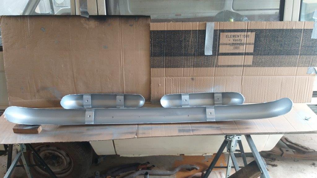

While I was on a roll I thought I'd give the front bumper the once over. There is a dent in the lower part which I'll have a go at knocking out. I'll need to be gentle to preserve the chrome. Luckily most of it is hidden by the rego plate, so no major drama if I can't get it straight. Talking about rego plates there are two manky looking brackets that I suspect either used to hold the older style long rego plate or maybe a set of spot lights . Anyway they stand out like balls on a greyhound so a plan was needed. Luckily I had two spare round headed chrome bumper bolts in my stash from when I built the Bedford and on closer inspection they are the right size, so the brackets are now a thing of the past.
The inside of the bumper is quite rusty. Unfortunately the bracket holes and the long sweeping corners prevent me from being able to try the overnight vinegar soak trick, so I might just hit it with a flapper disk and then give it some silver paint.
The outside chrome is in similar condition to the rear bumpers so will need a bit of elbow grease.

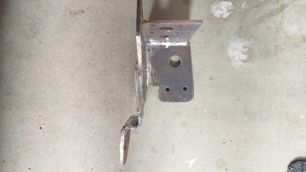

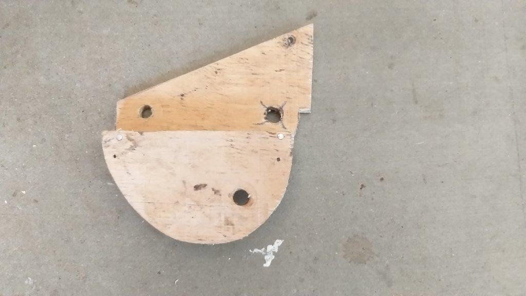

This morning I thought I'd make a start on the second portion of the steering bracket which is the part that the L300 angled steering box mounts up to. Did a bit of plywood aided design and successfully managed a test fit. With the Thames steering column mounted in its final position the L300 UJ that I had welded onto my Thames steering column runs nice and true.
Tomorrow I'll replicate the plywood mock up in 6 mm steel plate and will then glue it to the existing part.

And that's the bottom portion of the steering bracket carved out of 6 mm plate. It took a few goes before I got the offset perfect. Next step is to glue it to the main bracket and then do a final tidy up of the welds.
Heavy rain stopped play yesterday, so I only got to glue the steering bracket together today.
Just needs a final tidy up with a flapper disk before I call it done.
