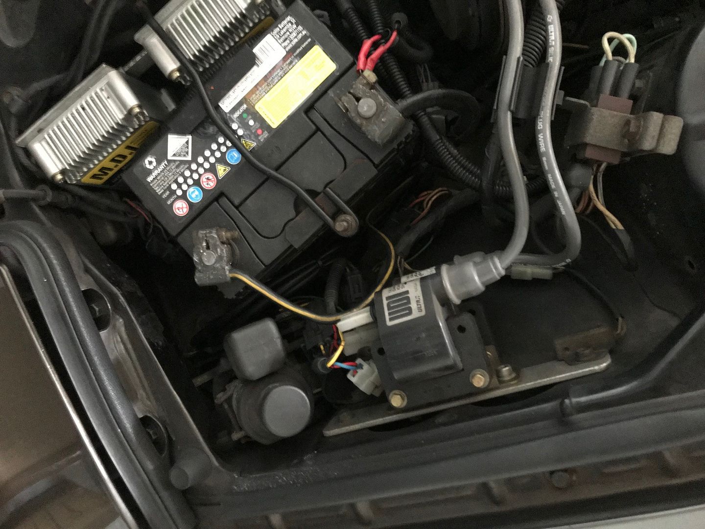

J4m13 Posted November 9, 2018 Author Posted November 9, 2018 I have an aftermarket ignition system fitted to the car. From the quick searching ive done its an MSD style "upgrade" Has anyone here had any experience with this?? this is really the last thing I am wanting to change and return back to standard so i'm hoping to get some feedback on this. Let me know in the discussion page what your take is .... or knowledge Cheers!! Quote

J4m13 Posted January 18, 2019 Author Posted January 18, 2019 A few days later, started pulling the aftermarket ignition system out and see how my wiring diagram tracing, and harness fabrication skills will pan out. Got to removing and this was the end result.... Installed the coil mount, plugged the harnesses in, mounted the coils and went for a start. Started first bloody pop!!! I was well chuffed to say the least. Im no sparky, but felt good to tackle it and succeed. Took it for a drive and noticed no difference at all.... untill 40 minutes later and everything in the engine bay had warmed up. And a mysterious phantom miss reared its ugly head under boost. I think I had just worked out why the aftermarket system had been installed. Alas... I went to bed to sleep on it. After a day of racking my brain, contemplation and running scenarios over and over I had come up with some ideas. First was to check the Distributor cap and rotor... Now i'm no auto sparky but these I thought would contribute greatly to the issue Not over confident that this is the entire problem, so continued on with my punch list. Not without ordering new ones from Mazda first. I checked all the vacuum hoses, found one that had a kink in it, replaced. Changed out the vacuum solenoid that I had bought the parts from greece for, filled the gas tank up, and pushed the ignition coils all the way to the back of the mount, instead of 3/4 in the engine bay in the hope the radiant heat would not warm the ignition coils as much, checked my spark plugs and last of all, resistance of the leads. Now this is where I shouldve taken the experience I have gained in all my years working and done 1 thing at a time. But I didnt, and well, the issue is gone and im boosting good and proper again. Ive ordered new plugs to install even though the current ones appear to be in good shape. Anyway, im back to being original and pretty happy about it. Just awaiting the cap and rotor and will install to tick that off the list. No doubt, somehing else will break in the future and 'ill be fixing that. i'd forgotten how much maintenance these cars take. There was a whole lot of diagnosing, advice gathering, and trial and error used to get it up and going again but I wont bore with that. I like looking at builds with photos so im trying to keep mine to that. If youre curious, hit me up on the discussion page and ill elaborate. Other than that... enjoy the summer cruising 4 Quote
