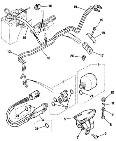

Popular Post Indiana_Jones Posted September 6, 2020 Author Popular Post Share Posted September 6, 2020 Brakes still giving my grief, so while browsing online I came across someone selling an apparently NOS accumulator (part No. JLM 11659), it was manufactured in 2000, according to the box. Grabbed it, because it was $50 and figured I might as well give it a punt. So got a chance this weekend to do the swap, removed the accumulator, valve block, pressure/charging switches and mounting bracket (items 1 through to 5 in the diagram below). Here's the old assembly in place: After it was removed (wasn't too hard to remove, just need to jack up the driver's side of the car, just remember to disconnect the electrical plug): Removed the old accumulator, was on fairly snug, so the method I used was to use a rubber faced mallet on the valve block which go it off. Got the new accumulator on, which I noticed was slightly wider in diameter than the old one and that it also had an adapter which went between the accumulator threading and the valve block's. This resulted in a tighter fit in the mounting bracket, but seems secure enough. Here is new assembly (gave it a bit of a clean up): And here it is in place: Topped up the system with fresh HSMO (Hydraulic System Mineral Oil), you can use Penrite LHM in place of the Castrol product. To get it into the reservoir without the Castrol bottle with the special tube, I used a large syringe with a small diameter hose/tubing (approx. 4-5mm) with a 15mm slot cut into the end going into the reservoir, as to allow it to push down the non-return ball and still be able to leave the piping (if you don't do this, all that will happen is that you'll build up a lot of pressure and the syringe end of the piping will pop off and green fluid will go all over the show, trust me, I know lol). With that all being done, I fired her up, wait for her to warm up a bit, checked for leaks etc. Got in, and drove her forwards and applied the brakes....and they seemed a lot better! also the low pressure warning only flashed at the very start when the engine just started (i.e. still building up pressure). So touch wood, the issue has been resolved, though I won't get ahead of myself just yet, as I need to do a road test, which I can't until I'm ready to take her for a WOF. Now the real work begins, as now I have no excuse to put off getting the rear window and fuel tank out, as to get cracking with the rust issues at the rear. I haven't decided if I can be bothered doing the screen removal myself or if I will get a specialist to come to me to do it. Any recommendations? Smith and Smith etc? So that's the latest, hopefully going into summer I will make more progress than I have been able to lately. 14 Quote Link to comment Share on other sites More sharing options...
