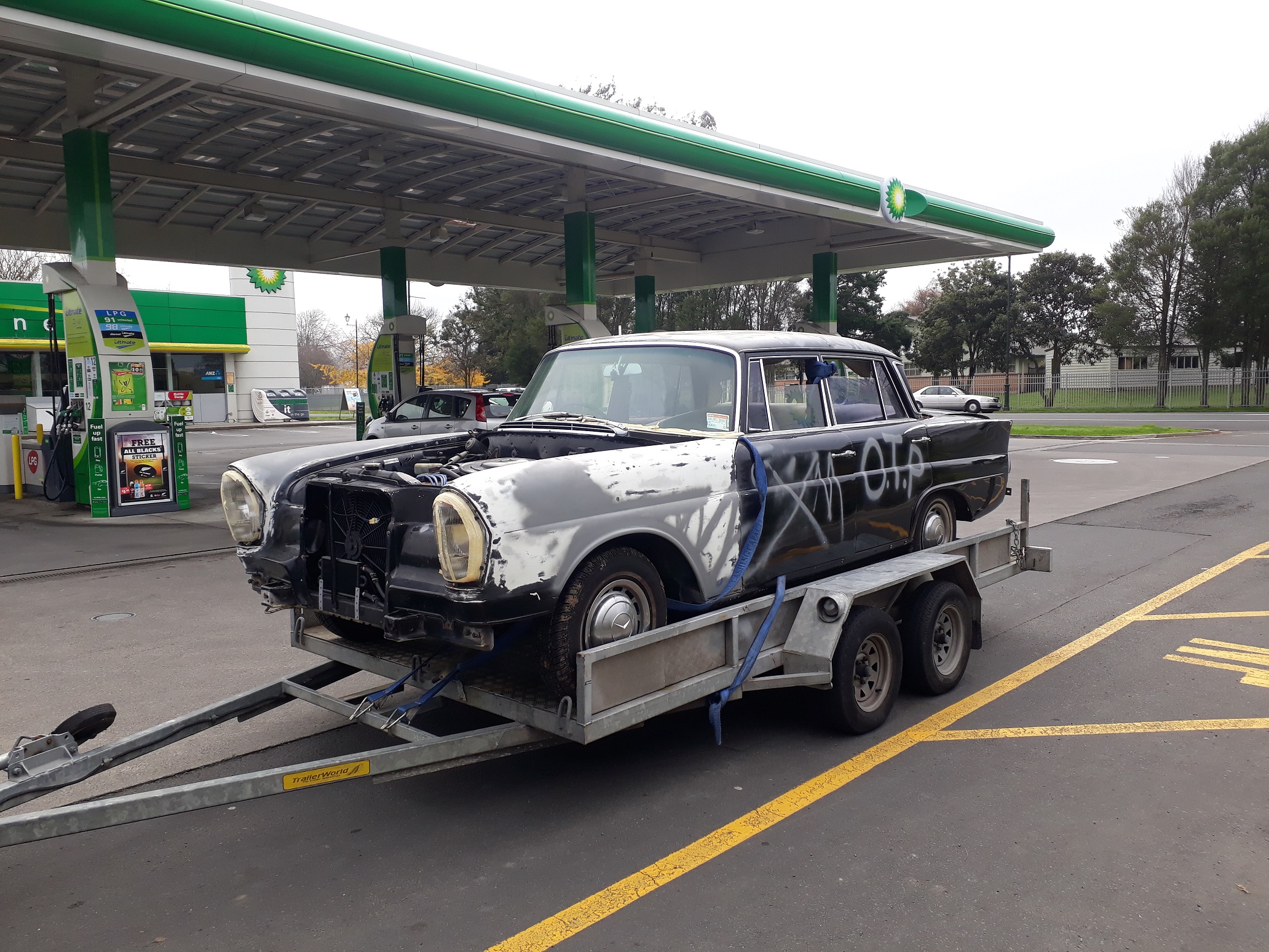

Popular Post Evan Posted February 27, 2018 Popular Post Posted February 27, 2018 Kia Ora A couple of people have asked where the build thread for my car is because they want to watch, there hasn't been much building - mainly de-building up to this stage but here goes. As part of my daily quest to be more like UJ about 6, 8 or 10 months back I was trawling trademe as I regularly do, seeing what's new.There was a fresh ad up for a Fintail Mercedes Sedan with the usual 3 shitty photos.This was right around the time I brought the v12 Jag motor discussed elsewhere, I mean one hobby is good but twos better right? This thing is also the reason progress on the V12 has stopped because I've been spending spare time swimming and getting the ball rolling on this. Anyway the ad as mentioned had 3 shitty photos on it, one of which was of a grainy pic of a not-so-Mercedes Falcon motor that it was fitted with. As a result of the Falcon motor the guy who owned it was getting all sorts of grief about it not having a Merc motor. Bugger that I thought, I'll go have a look. Long story short the guy wanted rid of it as it was a project he and his Son who's since left home had that never got anywhere and he just wanted the shed space, he didn't care what he got for it and couldn't be bothered dealing with the whinging people on trademe. So I bought it then and there. This is what it looked like when I got it, forever known as the OTP mobile. It's a 1965 Mercedes Benz 220Seb (W111 Chassis for those that care) in black, just like UJ, sort of. From what I understand 220 is the engine size (pretty obvious 2.2 litre), S is the bling model, b means its a fintail (the predecessor to this shape was also called a 220), and E, I believe, means it was a factory injected car but I'm probably wrong on that. It doesn't matter as it has the aforementioned Falcon 6 weighing the front down now. It appears to be complete, everything that is missing in the above photos is in the boot. When it was listed it was listed the guy said it was deregistered, a quick carjam report said that it wasn't deregistered, that it had simply lapsed and was due to deregister 2 weeks after I brought it, so I quickly put it back on hold after I picked it up. Live reg = Whoop. Props go to Sentra for tow car supply and Archetype for Storage. 23 Quote

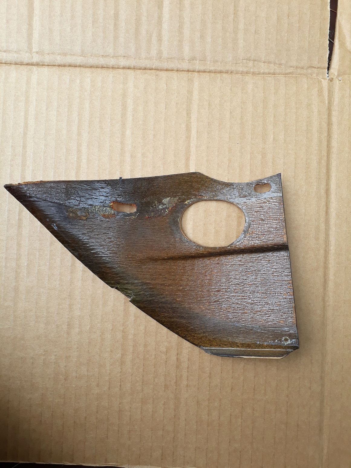

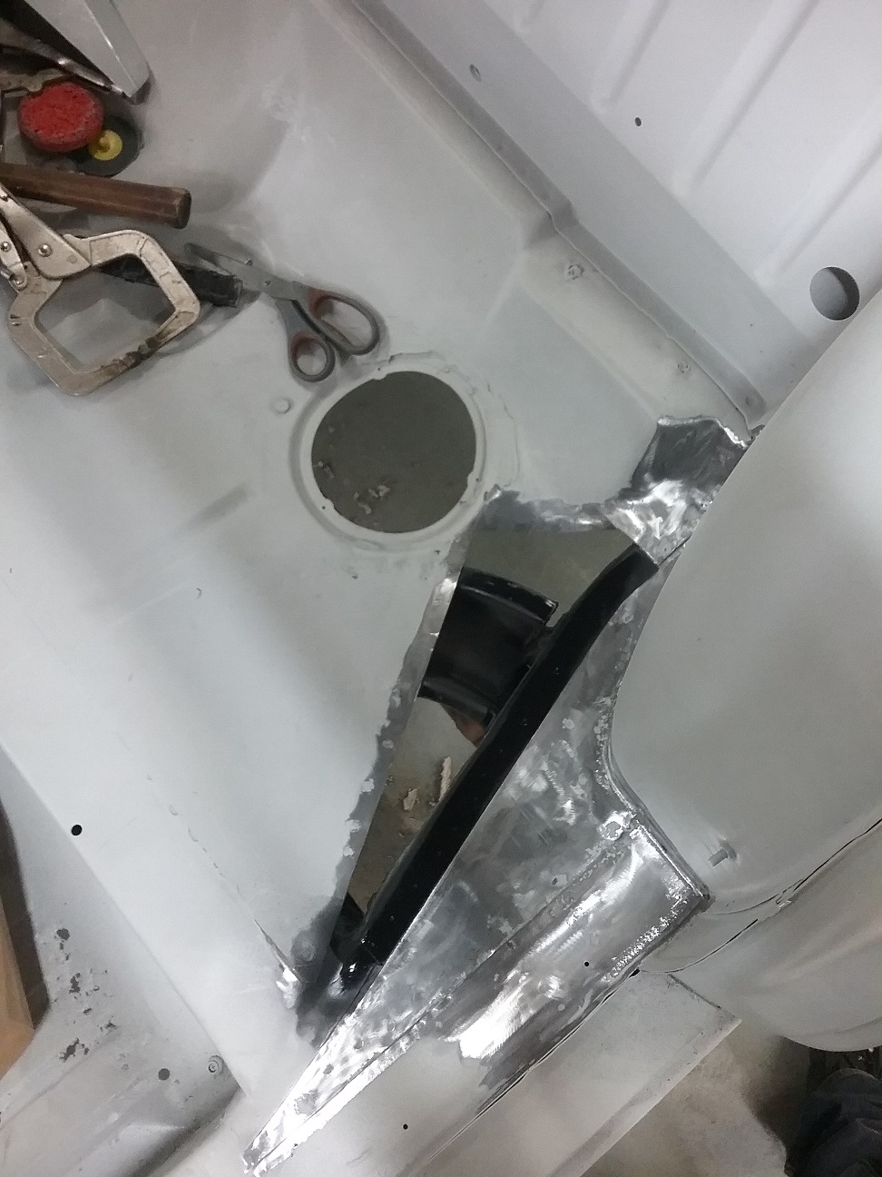

Popular Post Evan Posted August 4, 2018 Author Popular Post Posted August 4, 2018 Also the new sills have been fitted to both sides, both front jacking supports were replaced while they were off along with new inner front sill sections. Repairs have also been made to the front right corner of the drivers floor pan, left hand side of the front passenger floor pan and replacement of the whole rear left floor pan The next step is to fix this gem. The previous owner had begun cutting out sections of the rear parcel shelf/bottom of rear windscreen area including the lip that the rear windscreen seal sits on. Originally I thought I could still get these panels new from Mercedes like I did the boot floor which would of meant a simple(r) case of drilling out spot welds and welding in a whole new panel. Turns out I was wrong on the availability of replacement panels and this guy is going to need to be repaired, oh yay. 15 Quote
Popular Post Evan Posted August 18, 2018 Author Popular Post Posted August 18, 2018 Ta da! That's the last bit of rust on the shell taken care of, you can see some pitting on the parcel shelf but meh, it'll be ok. The whole thing is in primer now and at home while I save some more money before having the actual panel and paint done. 22 Quote

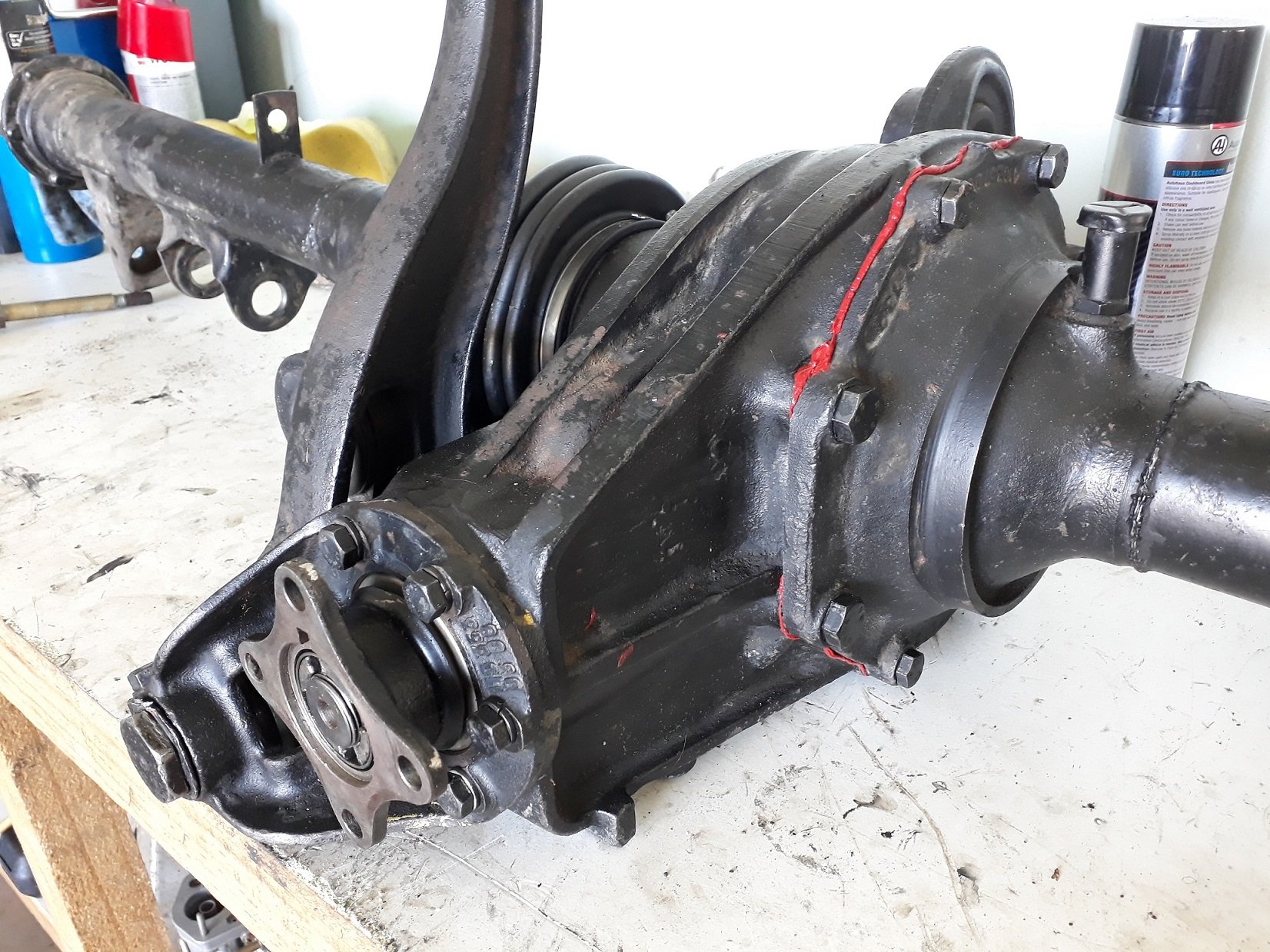

Popular Post Evan Posted January 5, 2019 Author Popular Post Posted January 5, 2019 Kia Ora, I decided to pull the diff apart a couple of months ago is it was 5 star manky and the rubber bush on the pivot rod and boot that joins the two halves were perished. If you ever hear of anyone saying they're going to pull apart a Mercedes swing axle stop them immediately; they're the biggest pain in the ass to take apart and an even larger one to get back together. Way back when I got the car I put an order through to Pelican parts and brought a load of new seals and bearings (along with shocks and bushes etc). I raided this stash for a new pinion seal. The pinion nut on these is some stupid castle nut thing, which the Special Mercedes tool for costs something like $120 from the states, flagging that idea I picked up one of these from Aliexpress for approximately $7, it's for removing some motorcycle clutch or something but it just so happens to be the right size and did the job, fingers and toes are crossed that the preload on the pinion bearing is right, I think it's close enough. the bearings inside all looked ok. Regreased everything and smushed it back together with some new bits, it's now far tidier - but hasn't gotten any lighter. 12 Quote
