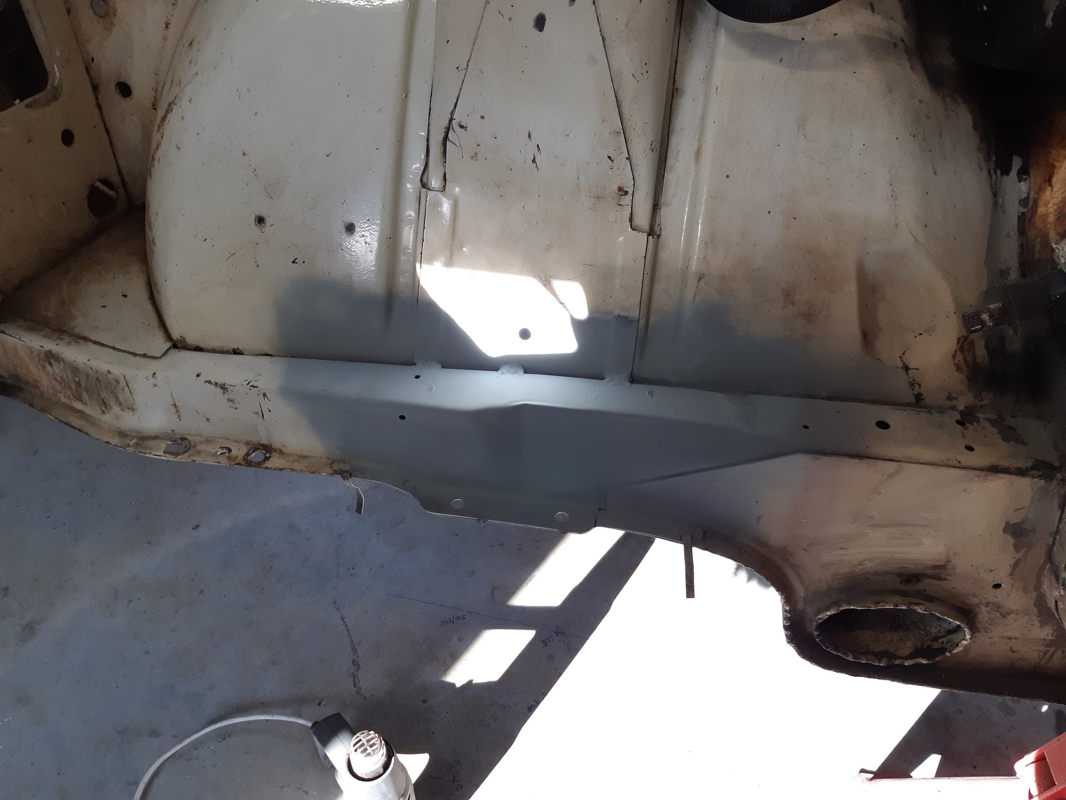

Popular Post Adoom Posted May 12, 2019 Author Popular Post Posted May 12, 2019 Been working on the gearbox cross member. Made up some 2.5mm strengthening plates to weld to the chassis rails. I will weld the captive nuts to these. I'll just tack the plates on for now and fully weld them when I make a rotisserie later. Â 10 Quote
Popular Post Adoom Posted May 26, 2019 Author Popular Post Posted May 26, 2019 I had worked on this last weekend but didn't take any photos. Captive nuts welded to strengthening plates. Straightened welding warpage in strengthening plates. Embiggened holes in chassis rail to clear captive nuts. Cleaned, sanded then acetoned chassis rails before spraying with some zinc 'weld through' primer, that I'm totally going to wire brush off where the welds will go. Sanded the strengthening plates and zinc primered them too. Â 10 Quote
Popular Post Adoom Posted May 29, 2019 Author Popular Post Posted May 29, 2019 Glued the strengthening plates on. Pleased how well the upside down welds went. Didn't push my luck, I'll fully weld it later once I've made a rotisserie. 10 Quote
