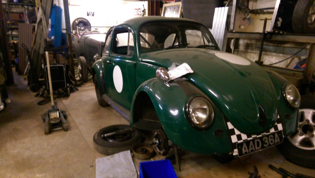

Popular Post CarolsHusband Posted August 5, 2017 Popular Post Posted August 5, 2017 I bought a Beetle. I had a '66 when I was 16 and I thought I'd got over it but when a mate offered me this messed up but solid beauty for a good price I heard myself say " Yeah, I'll have it". It's a 1200 '62 with later panels, a six point cage, Empi seats, the worst smooth-job ever and terrible paint. Pics. 11 Quote
Popular Post CarolsHusband Posted August 5, 2017 Author Popular Post Posted August 5, 2017 The plan is to chop the ends off it and make a simple Baja Bug. It's something I've always wanted to do but have never found a solid but lashed up car before. I'm not a fan off cutting up good old cars but I'm also not a fan of rusty Beetles. This is what I'll be aiming for, pretty sure it's going to be a bug eye. Aye Before I do that, I'm going to drop it, put a big motor in it, put some paint on and run around like that for a while. I've given it a service, taken the door bars and front half of the cage out coz I'm 50 and falling out of a car at the local Supermarket with your foot stuck under the seat is not big or clever. It's a piece of junk, it rattles crashes over bumps, lets the rain in and is as slow as fuck and doesn't really stop but i'm hooked. Update when my mate finds me the 2" drop spindles and 7" rims for the rear. Hang loose Bro or something. 26 Quote

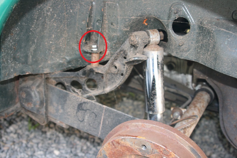

Popular Post CarolsHusband Posted August 17, 2017 Author Popular Post Posted August 17, 2017 Got a few things sorted. Gear lever lock-out was all spiffed to fuck so you could hit reverse instead of second, not much fun on the way down the gears. Adjusted with hammer/drift. Fine now. It's been a bit crashy over holes in the road, I thought it was just a Beetle thing.Turns out the rear body mount bolts were loose. One needed a bit of a nip, the other had backed off about 1/2 an inch. These 2 things sorted have made the car totally different to drive. Also tried the rims on for size, they're 8" and they are going to look mint. Going to have to do 2 & 1/2 inch flares which is fine. Anyway, pics. Loose bolts/chrome shocks aye Phone shot Nice..... 17 Quote

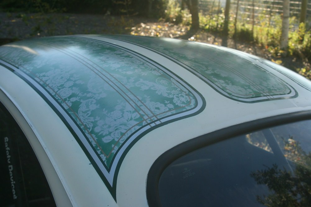

Popular Post CarolsHusband Posted September 27, 2018 Author Popular Post Posted September 27, 2018 No work that can't wait till tomorrow, sun's out, 20 degrees, not a breeze. Perfect day for a bit of slap-dash beetle roof painting. * If any of you do this sort of thing for a living, it'd probably be best if you look away now.... Needs a load of clear & a good polish but you get the idea. And that was my rattlecan flake n lace Thursday. 40 2 Quote

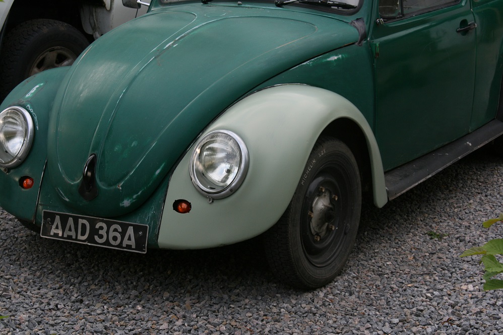

Popular Post CarolsHusband Posted December 19, 2021 Author Popular Post Posted December 19, 2021 Baja Bug it is ! Gonna do it. Beach buggy can wait/ get forgotten about. Got a couple of prices for bugeye kits here, just waiting to hear back from Chirco in 'Murica before I take the plunge. Messed about this arvo, going to put the stock spindles back on & then decide about ride height. Will be some sort of green in the end, but I'll save the roof. Best part of the car though I say it myself. Found this charming repair, not worried about butchering the car anymore ! 16 2 Quote
